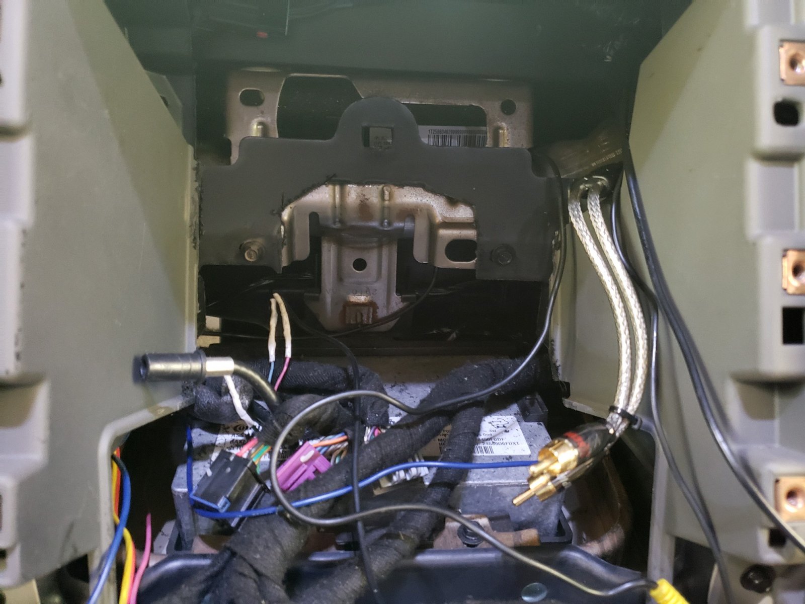

And here is all the wiring you get to stuff behind the HU....

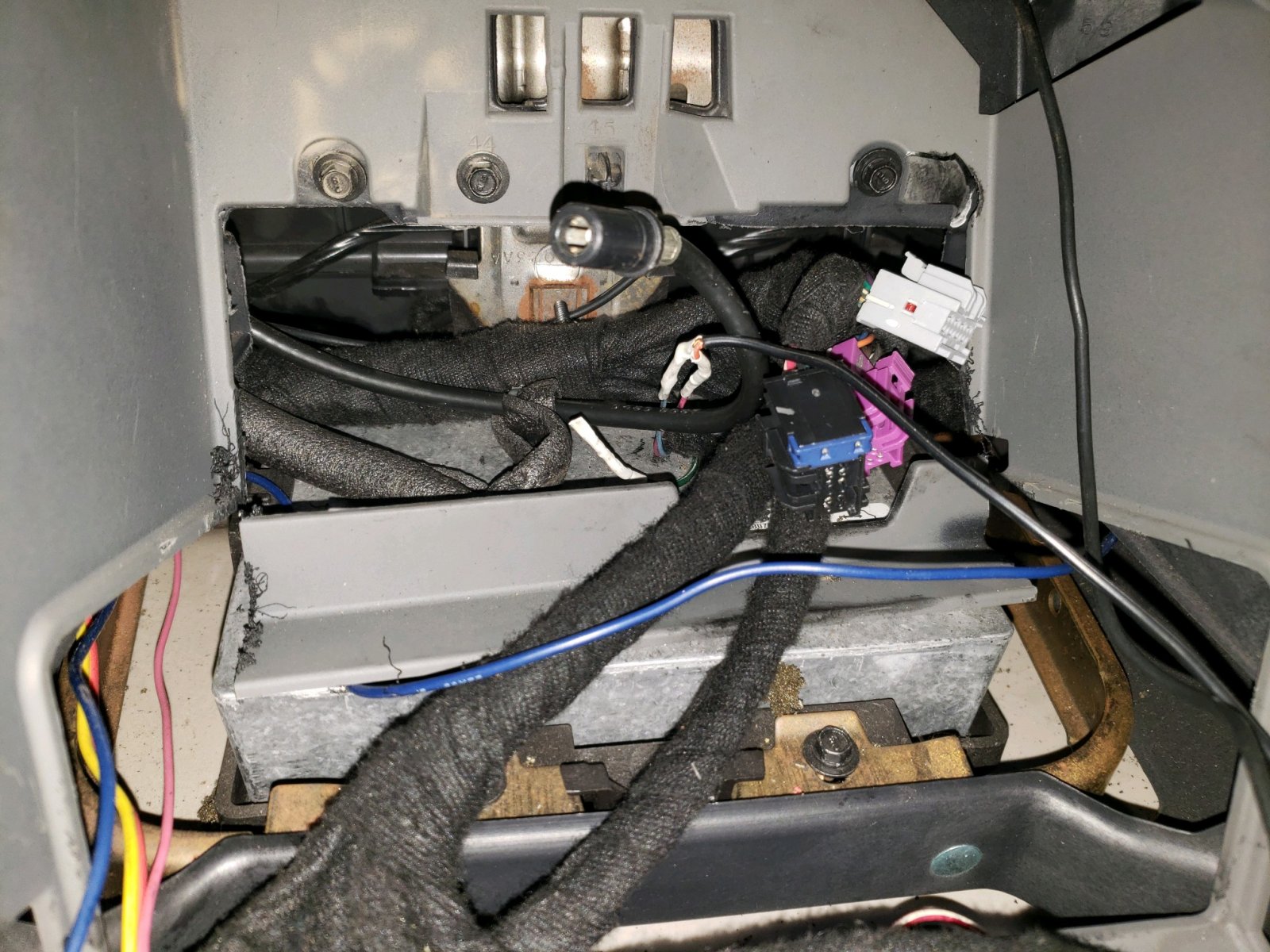

It has been a while since I did mine but my guess would be you didn't plug one of the RCA plugs into the proper place or something like that.
I would pull the HU and double check all your connections. That is a lot of wiring to stuff into the dash and things can sometimes come unplugged.

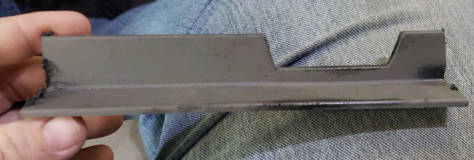

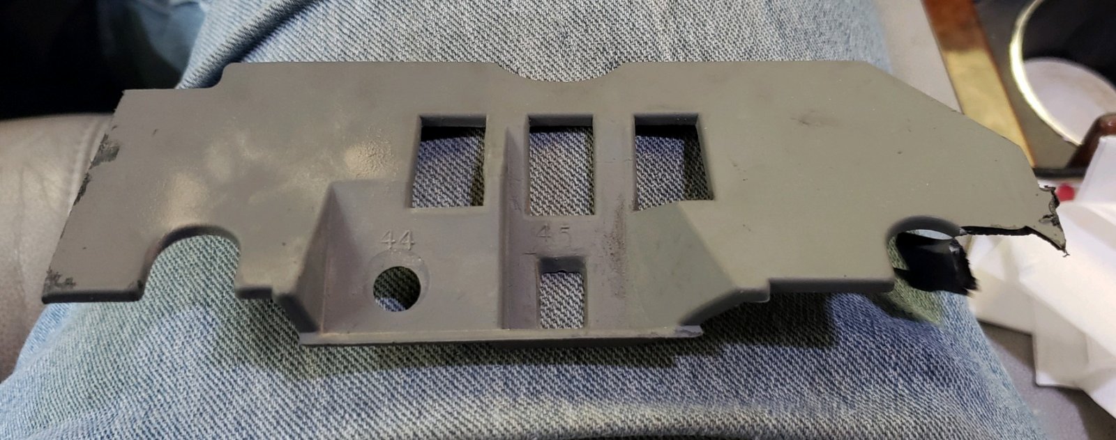

I modified the inside of my dash to make more room.
Before....
After...
Pieces I removed...

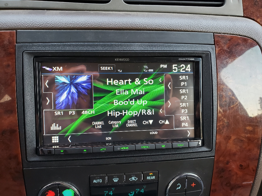

Kbuskill. I figured it out. I had 2 connectors from the maestro RR crossed. Once I made the correction. Everything worked great. The Kenwood head unit sounds way better than the Rosen I had before. Tomorrow ill tap into the video wires for the reverse camera. So it can show up on my stereo. Thanks for all your help. Greatly appreciated.
