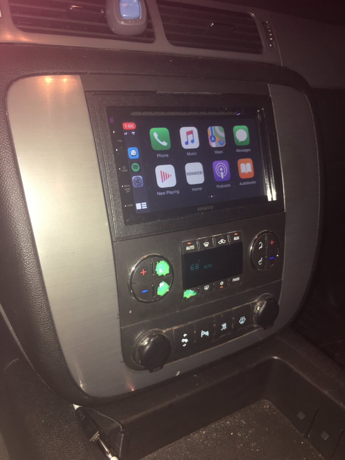

I did something similar to you but I went with Kenwood because I prefer the built in Garmin GPS.
I found a factory refurbished Kenwood DNX575S for a good price and jumped on it.
It has been a little over a year, and so far it has been flawless.
Hope yours works out just as well.

I didn't even pay attention to the size he posted, but you're right, my Kenwood is a 6.8".

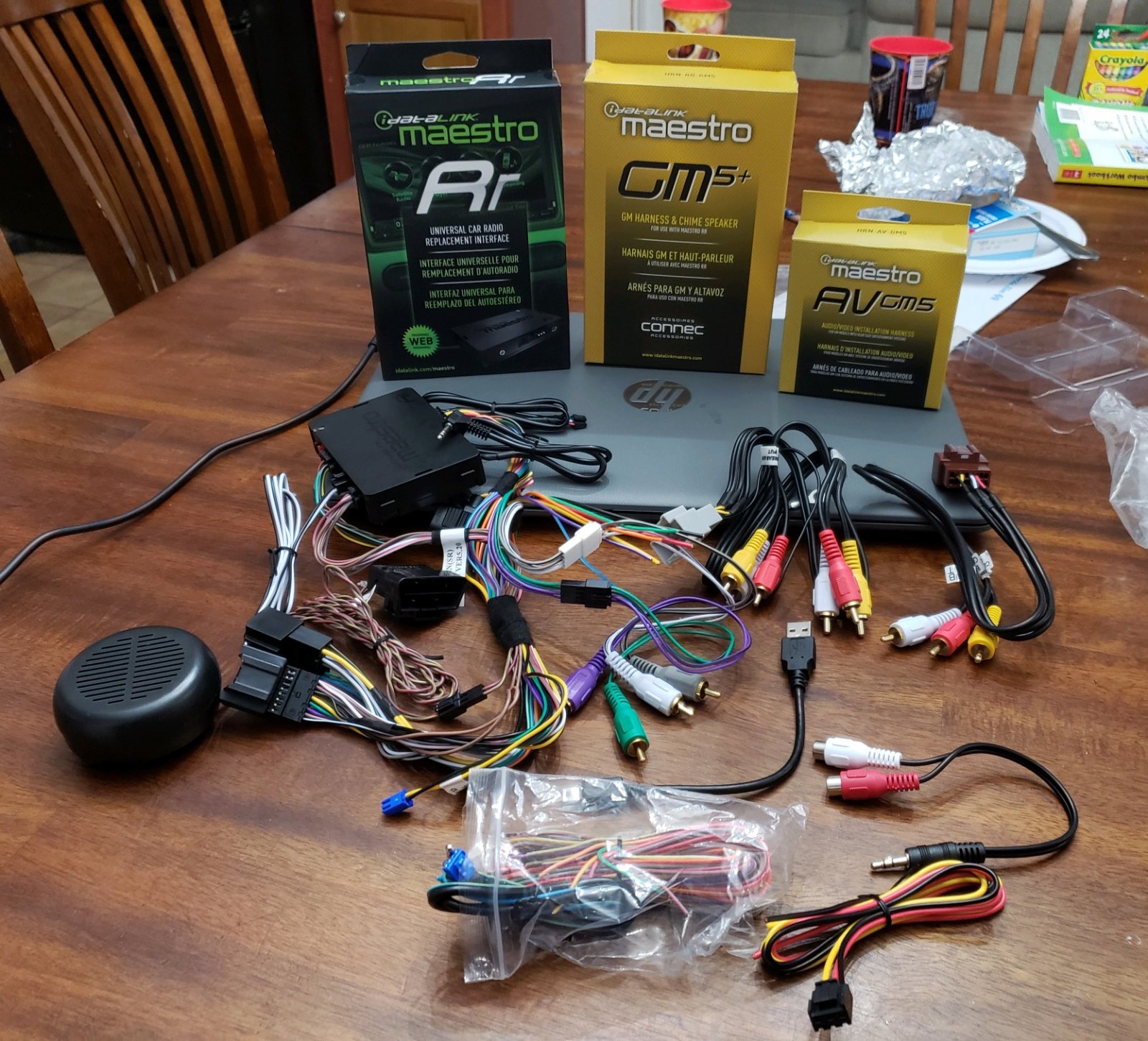

Anyone install using the rp5-gm31? I need help wiring it. Very discouraging with how much shit needs to be connected.
08z71bgm
08z71bgm
Jul 2, 2020
758
1,108
Long Island, NY
Never mind. Figured it out. It’s in but I forgot the mic and have to pull it out again. Everything works except the mic.
