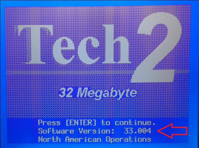

Have him power it up with the AC converter or the OBD port in the truck, after a short diagnostic few seconds it will display the software version at the bottom of the screen. Latest is 33.004.
EDIT: like this
Make sure you're getting the Candi module and all the connectors. Is it new or used? Come with a case?

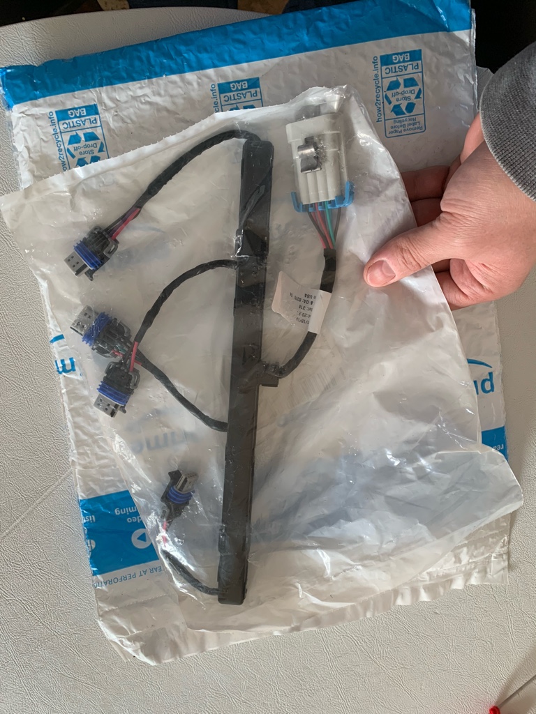

These are what I purchased
ACDelco 357A GM Original Equipment Ignition Coil Wire https://www.amazon.com/dp/B001KSAQNM/ref=cm_sw_r_cp_api_i_dh76DbF5W3QDN

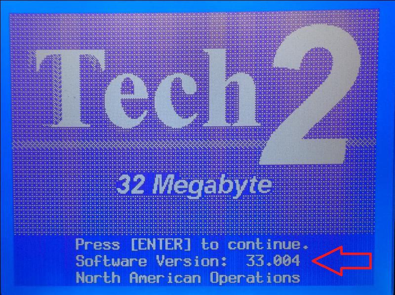

EDIT: like this

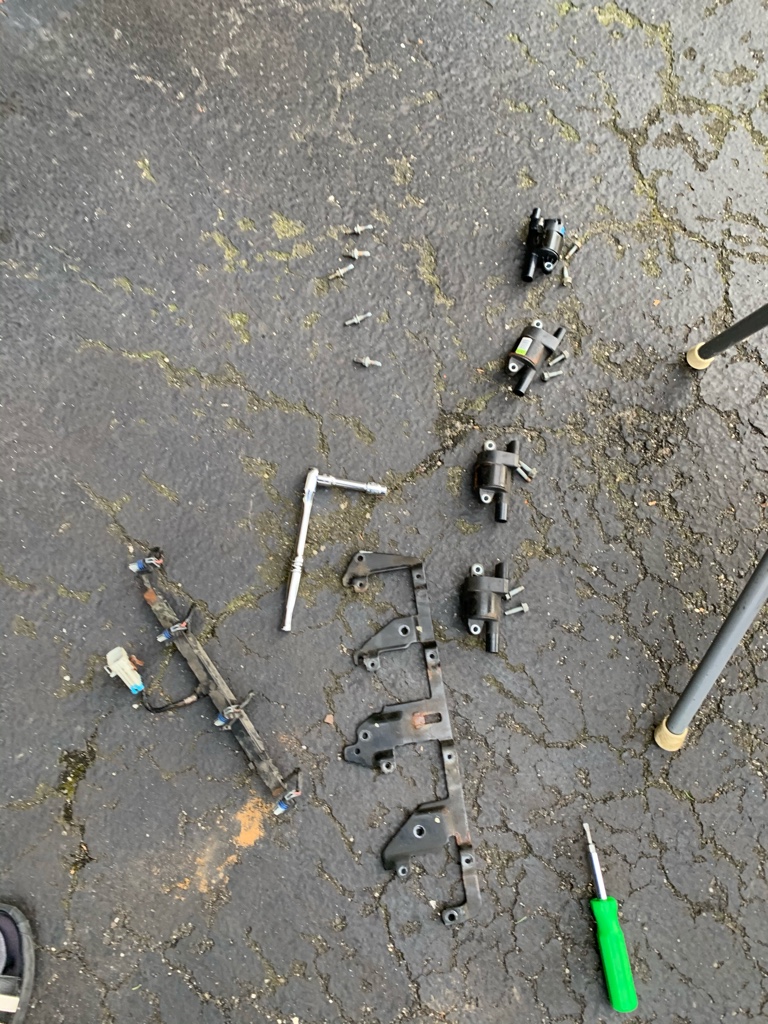

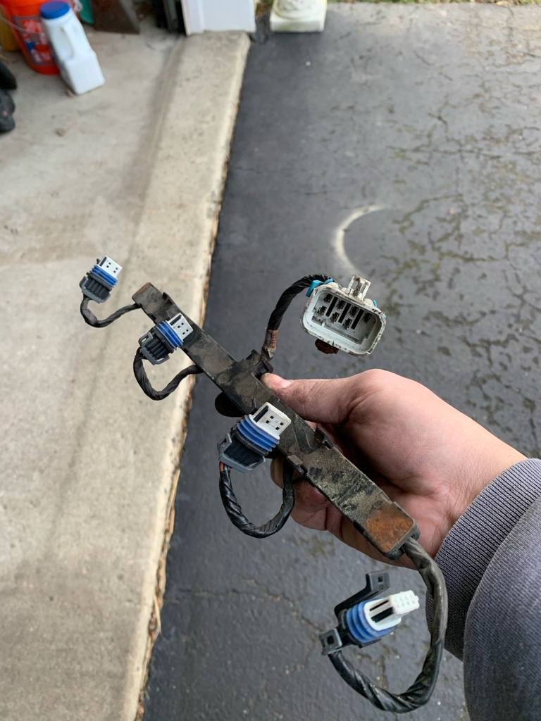

Changed out the wire harness that connects to the coils. Was pretty simple/self explanatory. Just took a 40 min drive and no misfire/codes. I’ll be driving back and forth to Manhattan twice tomorrow about 180 miles in total. If I make it with no issue then that was the problem if not I’ll buy an ECM.
