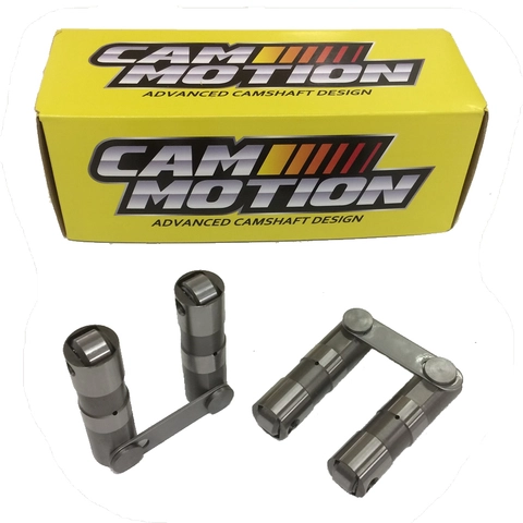

https://cammotion.com/lifters/oem-quality-ls-gen-5-lt-replacement-lifters-set-of-16-delphi12499225/
That's after I get the visual mods complete for my 01. A little bit of cam and corresponding parts (needs new lifters anyways they tick a smidge on first startup AND screw those lifter trays LOL) to help refresh her and give some juice. Also thinking about cold air intake with functioning ram air hood

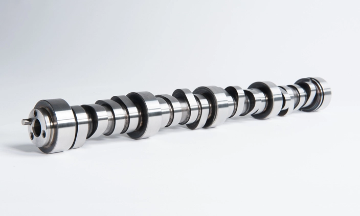

View attachment 344176 https://cammotion.com/camshafts/ls1-stage-3-camshaft-218-224-16-3/

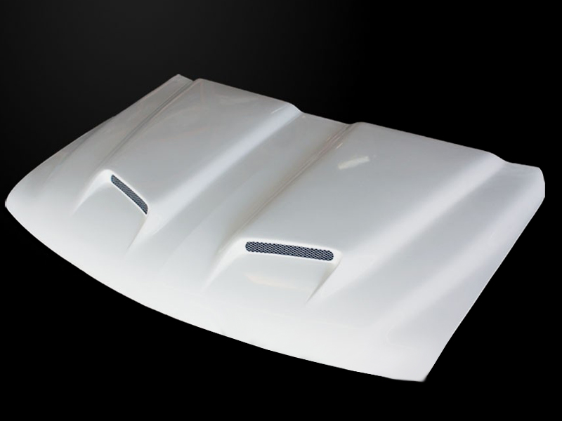

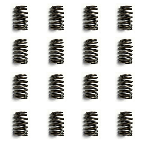

View attachment 344179https://cammotion.com/lifters/oem-quality-ls-gen-5-lt-replacement-lifters-set-of-16-delphi12499225/ View attachment 344178 That's after I get the visual mods complete for my 01. A little bit of cam and corresponding parts (needs new lifters anyways they tick a smidge on first startup AND screw those lifter trays LOL) to help refresh her and give some juice. Also thinking about cold air intake with functioning ram air hood View attachment 344180View attachment 344181https://www.bmcextremecustoms.net/2...style-functional-ram-air-hood-ct00ahtsfh.html and possibly a tuner. Any thoughts? This isn't going to become a monster.... at least not yet. It's pretty budget oriented yet still going to be fun to pull on some people once in a while. Or surprise them at the very least. Just poking the forum to see what y'all think about these ideas. As of right now it's bone stock. (Link to my build page https://www.tahoeyukonforum.com/threads/2001-tahoe-ls-4x4-build.128002/)
I kind of like that ram air hood. If you're gonna do any engine upgrades, you'd better budget a trans upgrade too. It's the weak point. My trans blew the 1st time I raced someone.

A little cam? Get one ground for a truck as most camshafts raise the power band, losing lots of torque down low where you need it to get the truck moving and giving it back high up in the power band where most trucks rarely go. To each his own.

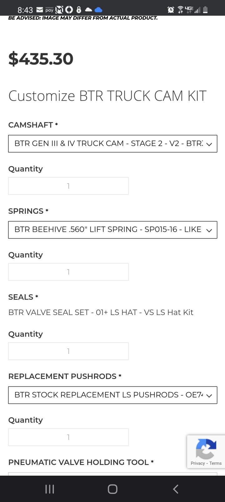

Sloppy stage 2 cam would be a better budget choice for a truck.
That cam posted is quite tame honestly.
Dec 30, 2014
31
14
BTR Stage 2 truck cam, EFan swap(Check my YouTube video in this section) and longtubes with a tune and be done. OHHHH and upgraded flow matched rebuilt injectors.
Do you think that cam will rob the low end ? I love my low end I was hoping to maybe even give it more with a cam. If you have a good reccomendation that would be nice. I was just thinking a nice drop in cam to keep the driveability yet still gain some power
The BTR is made for a truck. Hence the “Truck Cam” portion of the title.

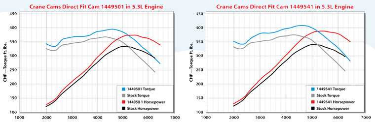

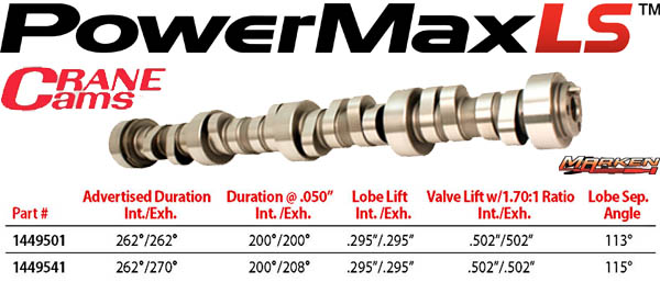

Sure do, it's ground for a car, not a truck. BTR, Cam Motion, Vinci and the old Crane Cams had good truck grinds with less than 210 degrees duration. Hot Rod tested the Crane Cams and they were the only ones (the others mentioned were not in that test but others)(look up Hot Rod Crane Cam Trio) to not lose torque down low.
Crane 1449541. My own preference is for the more mild 1449501 but am in the minority here. Most fellas here who have actually swapped cams opt for much larger ones. Some however, have regretted going so large, others compensated with high stall torque converters and or lower gears and are happy as a clam.
