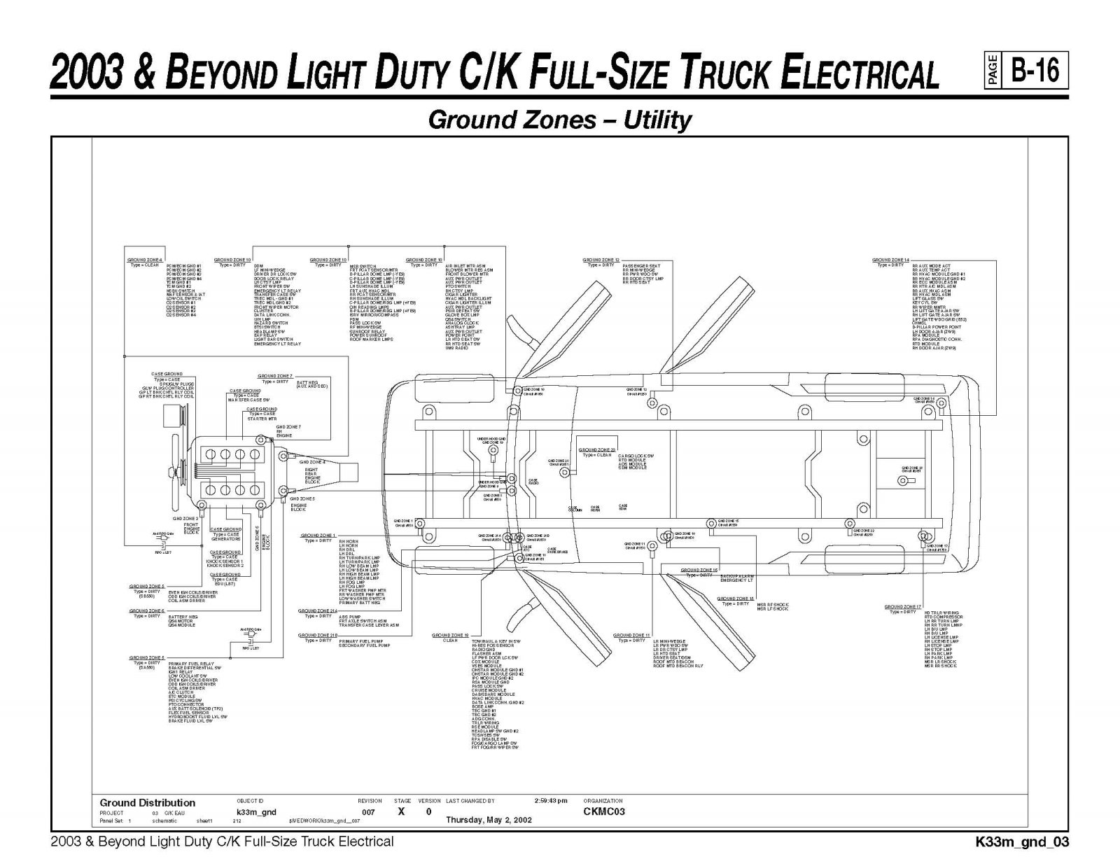

Thanks for that! I was home this weekend for a short time and was able to take a look at it. In all I have mentioned here and what you all have said, as well as others I have told about it - it's beginning to really sound like a ground. I am going to look up a diagram that might tell me all the grounds for everything and go through and check those out. I know where 2 or 3 of them are so I feel like I will start with those.

I don't have the 2001 diagram but this 2003 should be real close. I added this to a media album named grounds so you can see a higher resolution copy. It is awaiting approval before it will be public.
