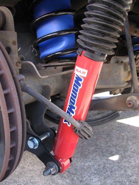

Was a pretty day so took on the project of installing my New shocks. Got a good work out and only took about 1 1/2 hours. Installed KYB Mono-Max shocks. I have to say it improved the handling quit a bit. When you turn into a corner it doesn't lean and doesn't stay in the corner. Levels out as soon as you go straight. Added about 16 lbs to the bags. I think I might have a leak. With air in the bags it raises up the back about 2". But once you put a load on the back it levels out where its supposed to go. I had to move my Daughter into her new house today. Was a good test to see how it performed. You can really load up the back with a lot of weight!! Without the back weighed down. It has a bounce. Believe that is the cause of the new springs. The old shocks where bad. I could push them down with no or little resistance. The front ones you could push in and wouldn't recoil back. Also the rubber bushings were wasted. Only concern with the KYB shocks is they didn't take the metal insert on the front shocks that the original ones had. But the new rubbers fit into the mounting holes just fine. So in short looks like I fix part of my issue. Adjust the air in the bags so they don't bounce,8lbs. Still have the issue with the front steering loose. Progress is always good.

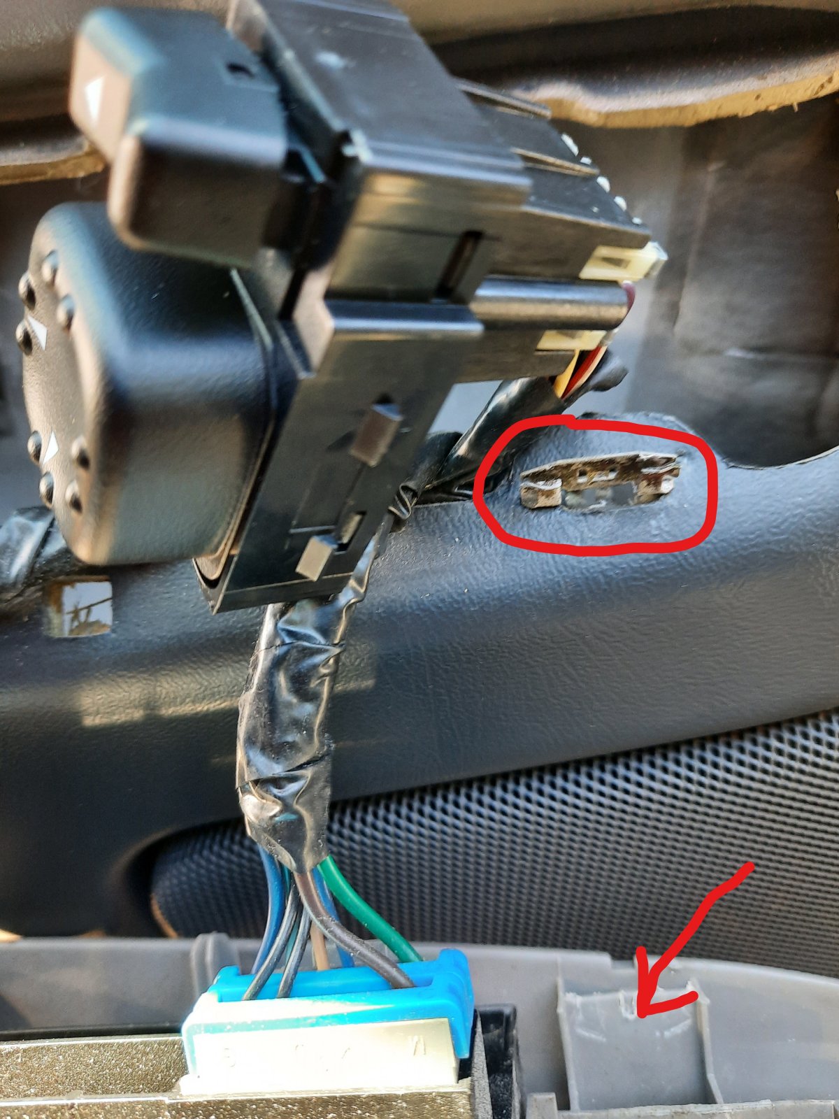

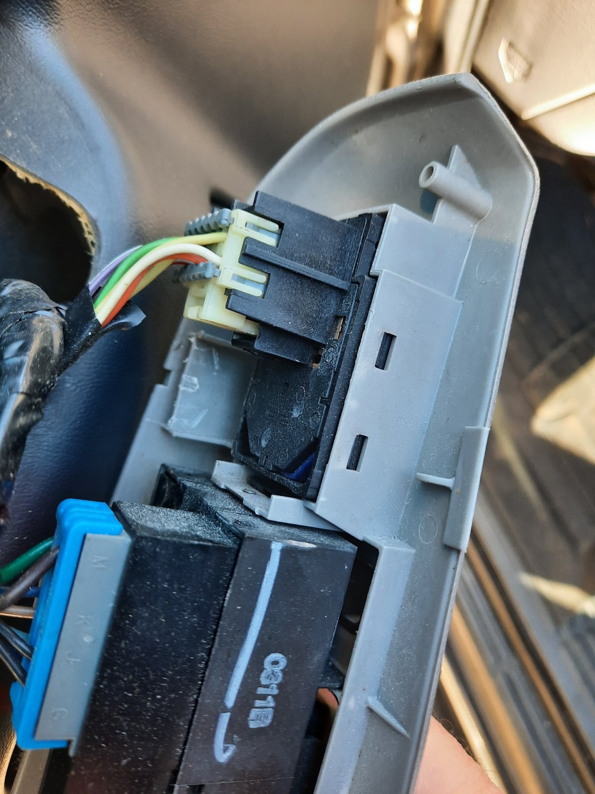

Today's project; Side Mirrors not working.
Sometimes the mirrors would work and other times they would only work in one direction. Thought about going to the PPL and getting an old switch. Problem with that is the old unit is out in the rain. Or you don't know if it works. If it did work you don't know how long it would work after installing. A quick trip to Amazon, $11 and 2 day shipping solved the problem. New is always good. Was going to cost the same as the old PPL unit.

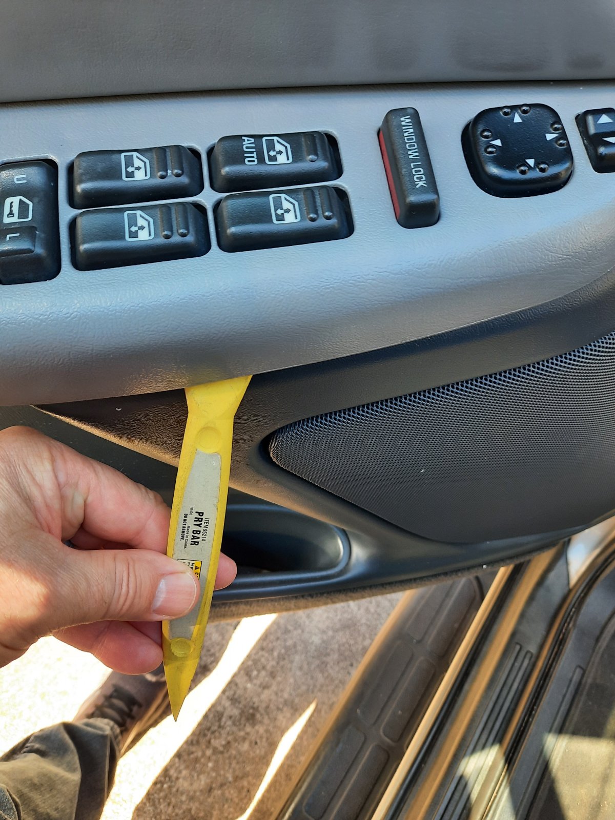

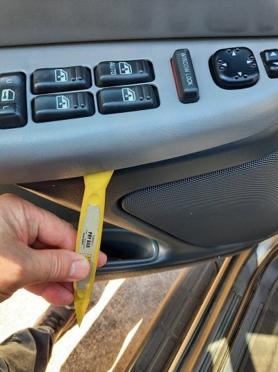

Good old Harbor Freight Interior tool. There are 2 clips under this panel. Just pry up and it should pop out.

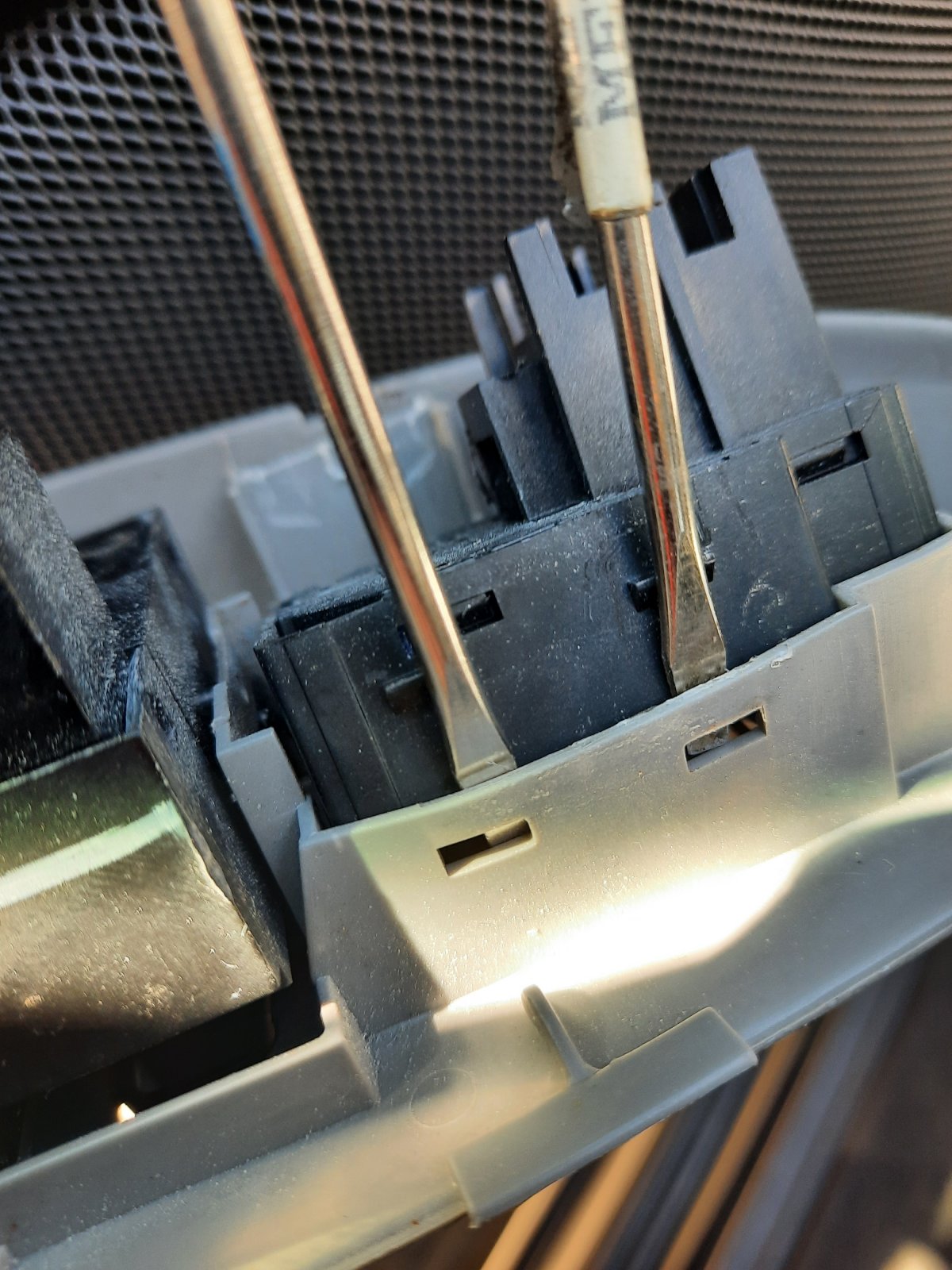

Once you have the panel out. Use small screw drivers to release the tabs on the mirror switch. But remove the wire connector first. Then Push on the switch to pop it out.
Now my clips came off the panel. Had to remove them from the door card and place them back onto the panel. Just pop the panel back into place and all done. I did test the switch before mounting everything back. Works, have side mirror control again. Cheap fix and only took 10min.
