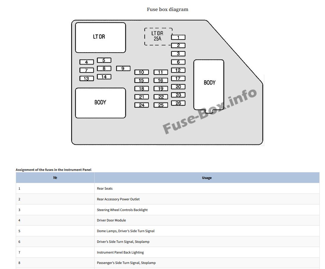

Try Fuse #8 in the instrument panel fusebox (open the driver's door).
