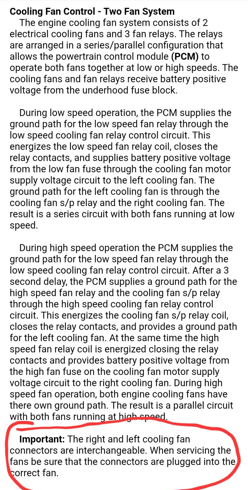

Need help understanding the wiring diagram and how the system operates?
Yes, the gray wire gets battery positive through relay 1.
Low speed operation has just relay 1 energized and relay 3 by default connects fan 1 and 2 together in a series circuit such that each fan is running on 6 volts resulting at roughly half speed.
In high speed relay 3 and relay 2 also energize. This alters the wiring so that the two fans are no longer wired in series and instead of getting 6 volts both fans now get 12 volts.
In high speed the right side fan gets power from relay 2 on the light blue wire and the left side fan gets battery power on the gray wire from relay 1 like in low speed, but now the ground side of the left fan is not connected through relay 3 to the right side fan but is instead now going through relay 3 to ground.

Here is what I would do. In fact I just did this on my own 2005 Yukon.
No key is required, the fans do not go through the ignition switch at all.
Remove the bracket above the cooling fan fuseblock. (4 bolts)
Unclip the large harness connector from the fuseblock cover. (small flat blade screwdriver to release the internal clip)
Remove the entire fuseblock cover. (3 or so clips hold it down)
Locate the 2 cavity connector #180 attached to the front of the fuseblock. (this contains the two cooling fan control wires to the PCM)
Using a thin backprobe to ground insert the probe alongside the dark green wire. (be careful, don't pierce the wire, just slide the probe into the seal alongside the wire)
When this dark green wire is grounded relay 1 should click and both fans should run at slow speed.
If you get nothing, not even a click from relay 1 then you need to investigate why relay 1 is not activating like it should when you ground the dark green wire at connector 180. Maybe recheck the J-case 40 amp fuse to relay 1.
If you hear the click from relay 1 but the fans don't spin then it is necessary to test along the low speed circuit to see why the fans are not spinning. ANY break in the series circuit will cause BOTH fans to not run. With the dark green wire at connector 180 grounded, start at the grey wire to the left fan, there should be battery voltage there coming from relay 1. If not, then relay 1 needs to be checked out to see why the battery power is not getting to the grey wire. If there is battery power to the grey wire, then with the left fan harness connected test for power at the light blue wire at the right fan. There should be power there also. If there is power at the grey wire and the left fan harness is connected then power should pass through the left fan motor and on through the yellow wire to the normally closed contacts of relay 3 and then on to the light blue wire of right side fan. We already know the ground at G115 to the fans is good because if that was bad neither fan would ever work.
