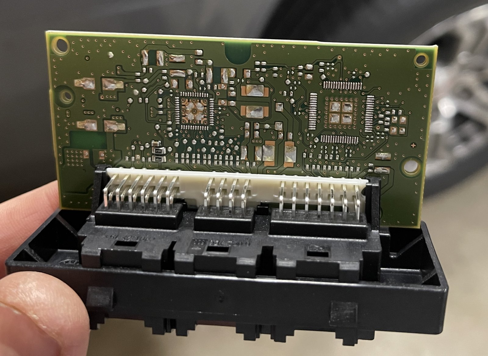

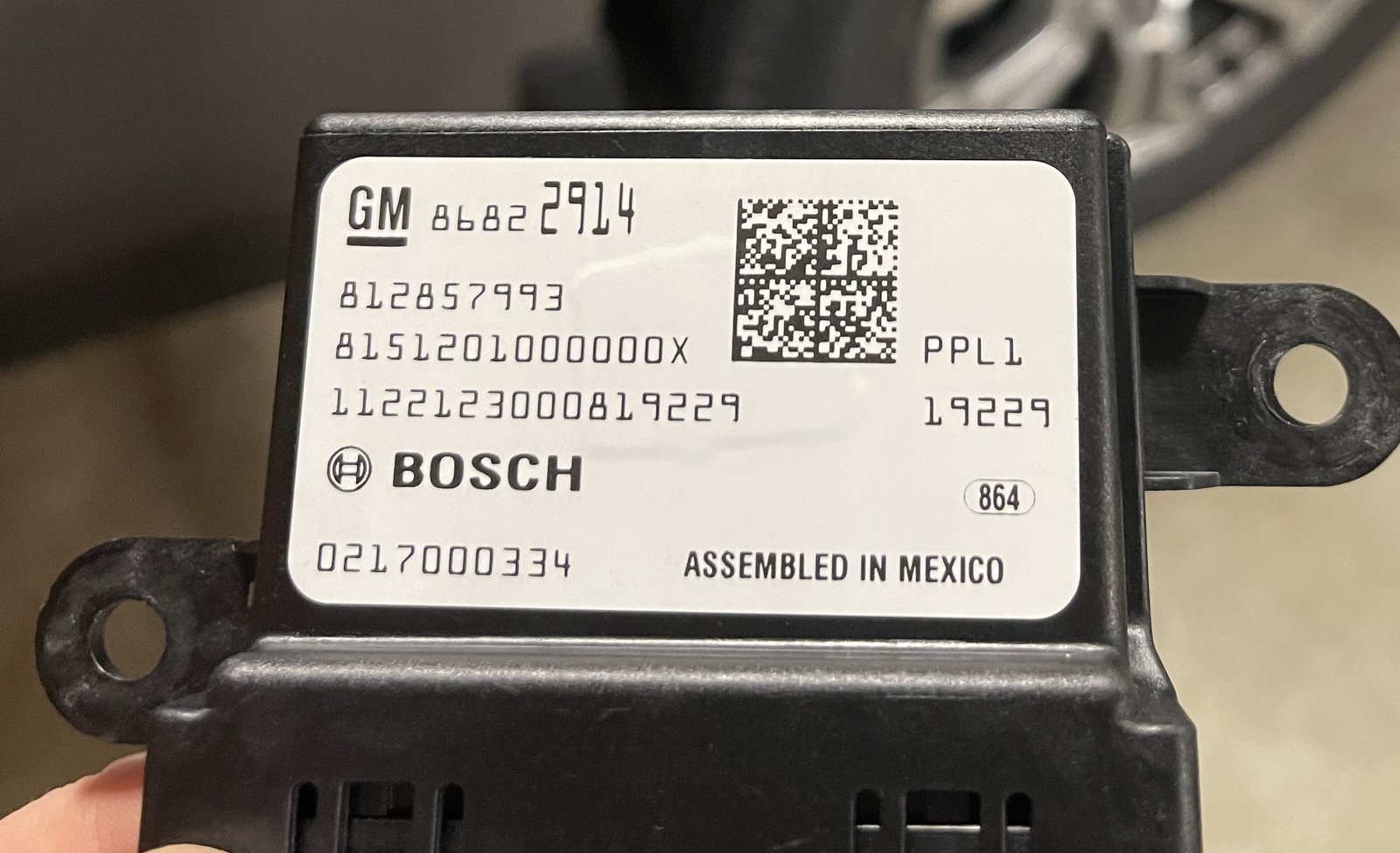

I figured out what’s missing.
After looking at the wiring diagrams and reading the function overview on the GM Upfitter site, it seemed like the only thing that could be missing was the module mounted on the passenger side D-pillar.
Mine has it installed as shown in a previous post, but it dawned on me that maybe it’s just the box, but no circuit board. I pulled out the interior trim and got the module out. I released the tabs on the housing holding in the circuit board and this is what I found.
Now I’m no electrical engineer but do you see what’s missing from this PCB? Chips!!! I see at least two locations where surface mount chips should be soldered.
They’ll probably remove this incomplete module when it gets retrofit, send them back to Bosch to get reworked and then put them back on the production line.

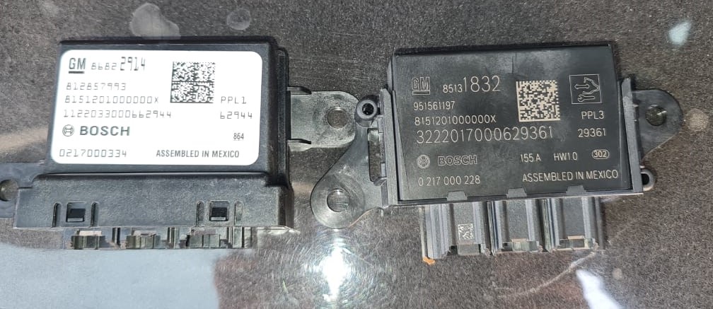

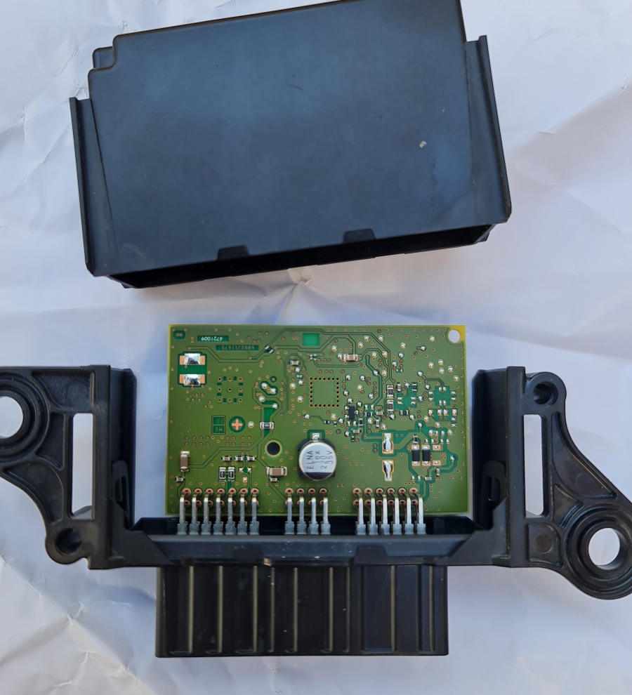

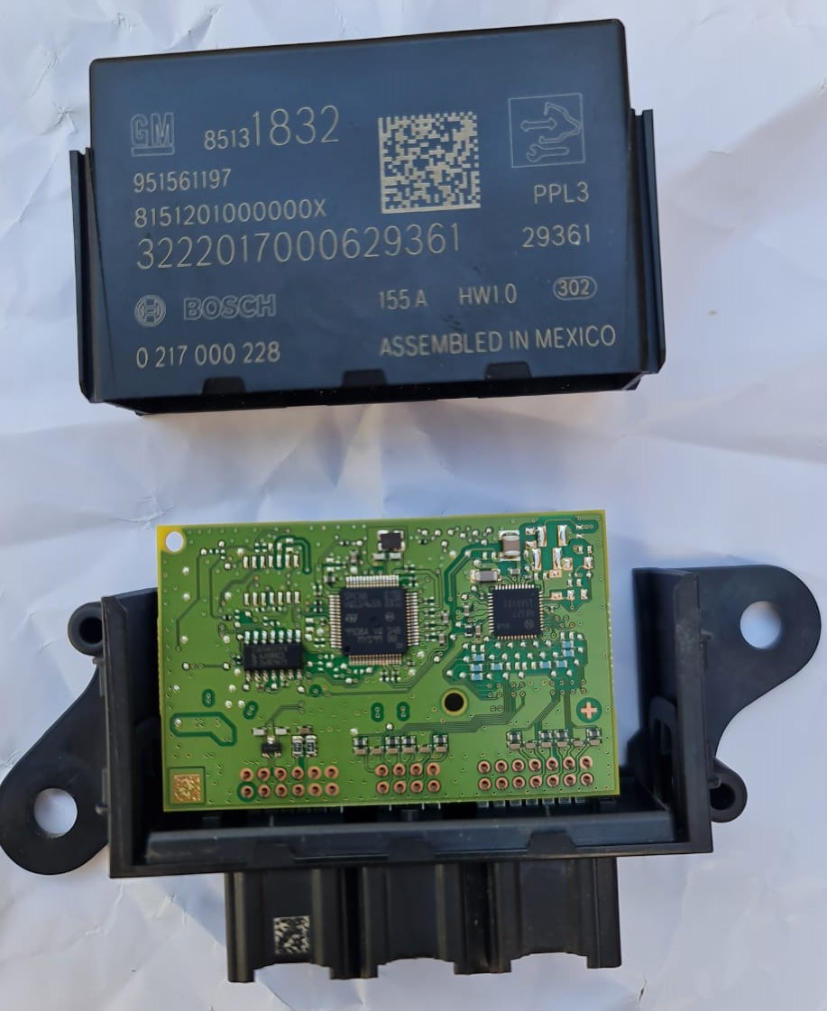

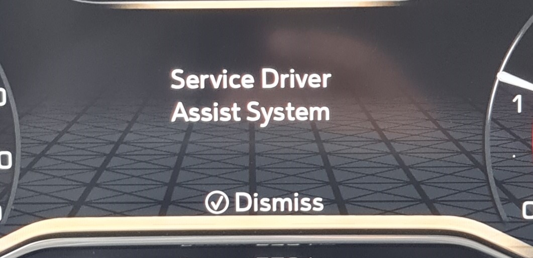

I guess this is the case, GM fitted uncomplete module.
however bought the P/N 85131832 and when fitted, got the message "Service
Driver Assist System"
so it has to be programmed to the car VIN. so you'd need a programming interface plus 45$ for ACDelco DTS :(
and yes the original part is missing all ICs.
