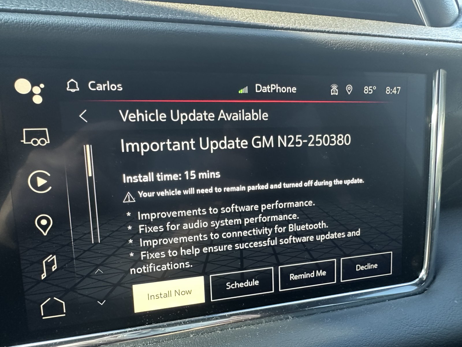

This is what I received yesterday on my 23 Denali

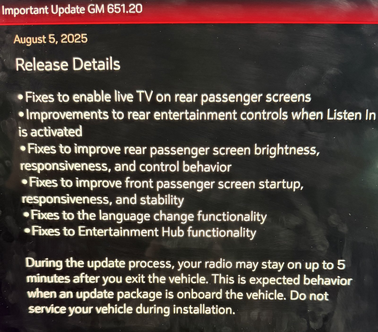

This is what displayed and installed on our 2025 Yukon this past week. Software update 651.20

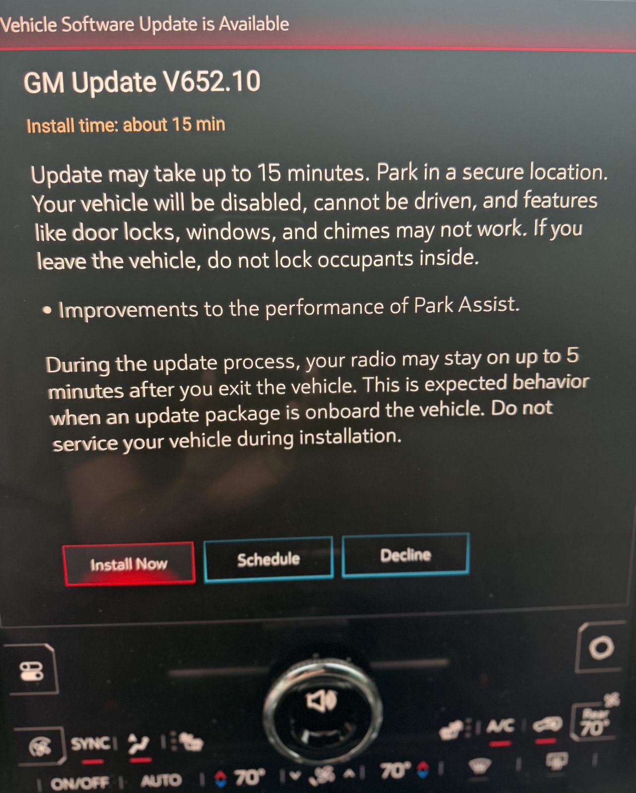

Today GM Update V 652.10 downloaded and installed in 10 minutes to a 2025 Yukon. See details:

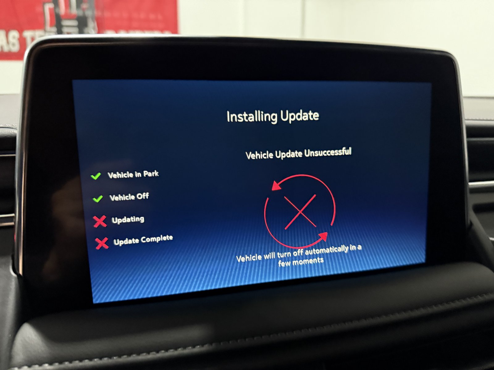

I got the same update message just now in my 2023 'hoe. Installing right now. Hoping maybe it finally fixes the audio dropout issues I've had forever. Maybe they're sending an OTA fix for the L87 engine too...haha
EDIT: Well, that was a fail. Not sure why.
Looks like you’re in your garage. First OTA update I did in my garage failed. Since then I drive 10min to town, park in the Walmart parking lot and it’s never failed doing it that way. OnStar uses AT&Ts network so if there isn’t good cell signal during the process it’ll fail.
Thanks. I scheduled it to run again that same night, and it worked. Was still in the garage actually, but what you’re saying makes sense.

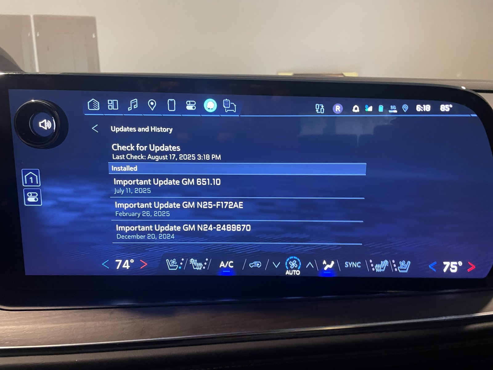

This is the history of the updates so far in our HC, but we don’t have the rear seat entertainment screens.
