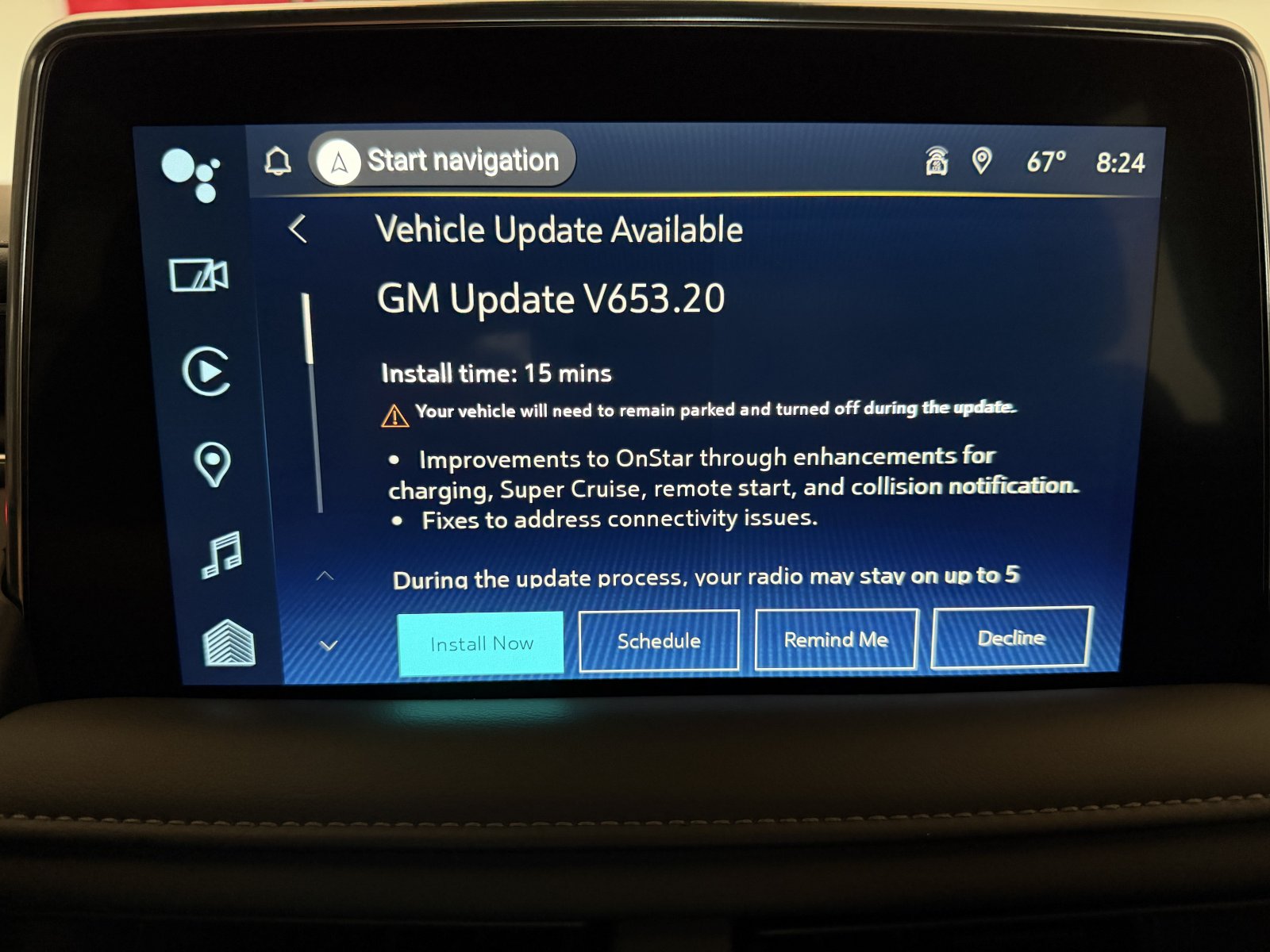

I got a notification yesterday that V653.20 was available. See screen shot. Tried to install, and it failed twice, and now the update has completely disappeared (i.e., no longer shows when I go to Updates in the Settings menu), and it says my software is up to date. Anyone else successfully install this update? (I have a 2023 Tahoe, BTW)
UPDATE 10/6/25: I finally got this update to install successfully overnight. It's interesting though, my software version still shows as Y177.6.1, as it did prior to this update. So, I'm not sure what to make of that.

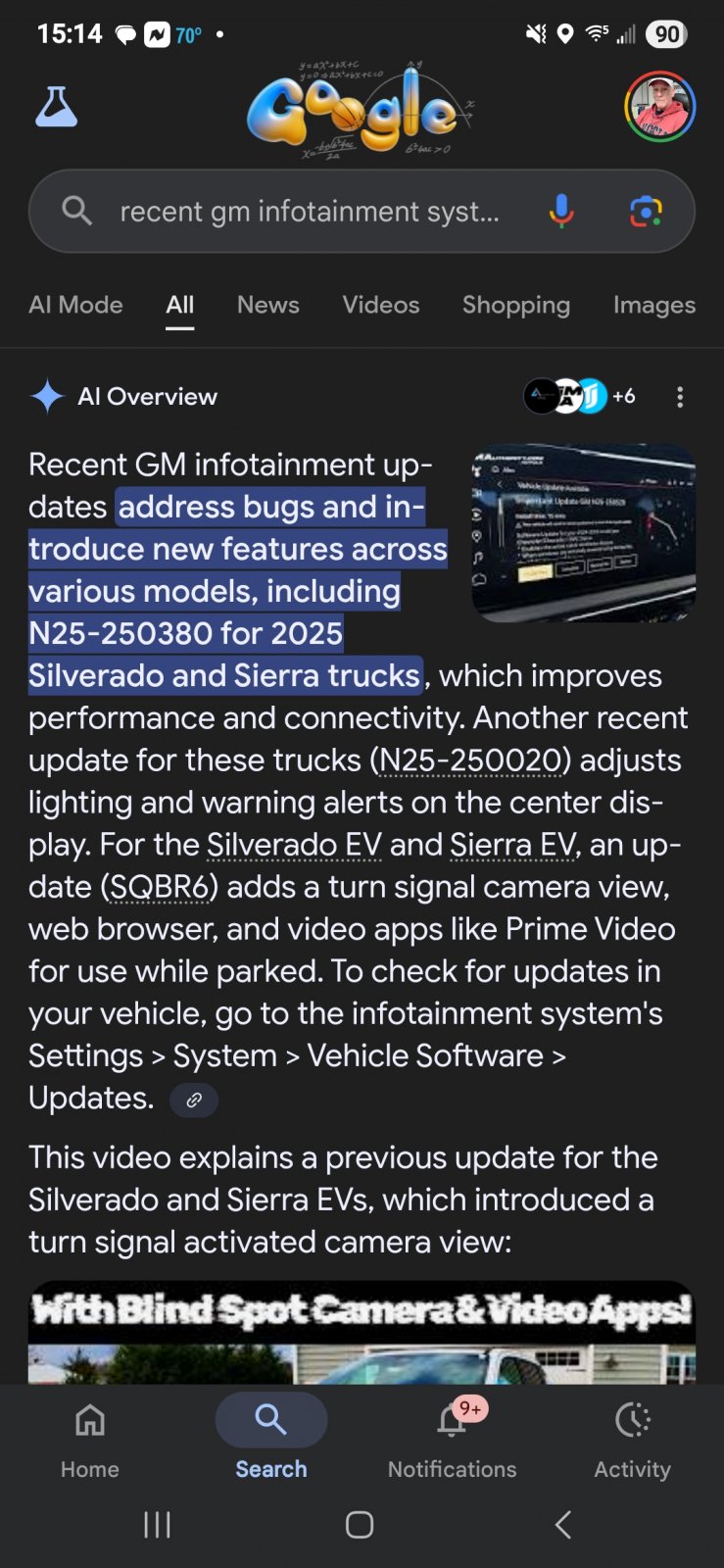

Google Search says this but it would nice to see actual GM Update Details Page.
General Motors software update N25-252854 is a 2025 release primarily focused on system stability and foundational performance for modern GM vehicles (like the Silverado EV and Sierra EV).
Change Notes for N25-252854
While specific detailed logs vary by vehicle trim, this update typically includes:
  • OTA Process Stability: Improvements to ensure successful future over-the-air (OTA) software updates and notification delivery.
  • Diagnostics Enhancements: Refinements to vehicle diagnostics to better monitor system health.
  • Performance Fixes: Minor software performance improvements for the infotainment system.
  • Connectivity Improvements: Fixes and enhancements for Bluetooth and USB connectivity.
