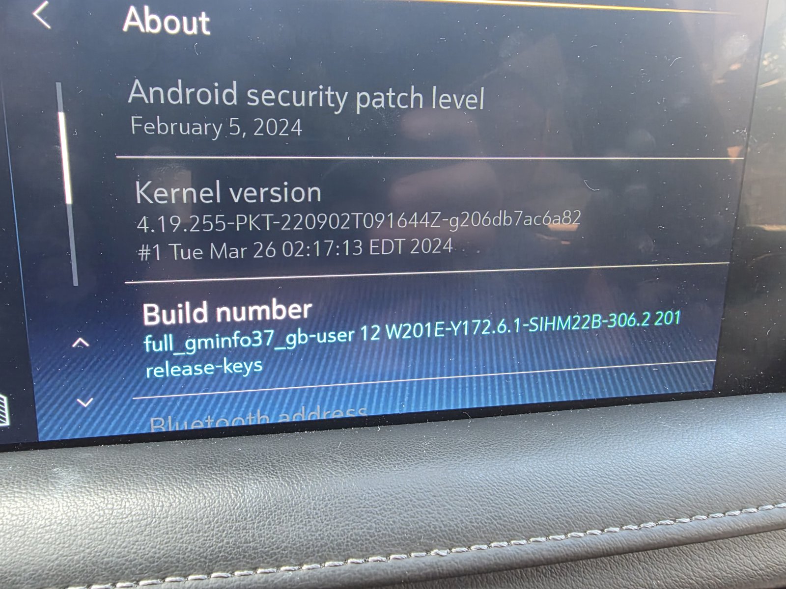

Taking wife's car in yet again for radio issues. 22 Z71 bought new. It's had issues since day 1, lucky us
Same as a lot of other people. AC blower cuts out, audio has momentary cut out randomly, sometimes the system restart on it own, sometimes turn signal audio is not there. Also not sure if related but saved seat setting 2, which is mine, the left mirror defaults to either full up or full down
Previous repair attempts have been software updates and even replacing the entire radio
Last year when car was just barely out of the 3 year bumper to bumper the dealer offered to run a new update but wanted 300 bucks. I told them pound sand. Well now we're looking to get the update after all and I'll be going to a new dealer who has not had any prior hands on with this car. I told wife, who will be dropping it off, make sure they just install software. We don't need troubleshooting and come back to a grand repair bill or some nonsense
Anyway, sorry for long post, question I have is, is Y172 the latest update still or is there a more recent one? And how do I see what's currently installed? When I went to the software page the attached pic is what shows up

Hmmm ok so I have 172 installed based on this pic? So if radio still has the issues am I just SOL?
