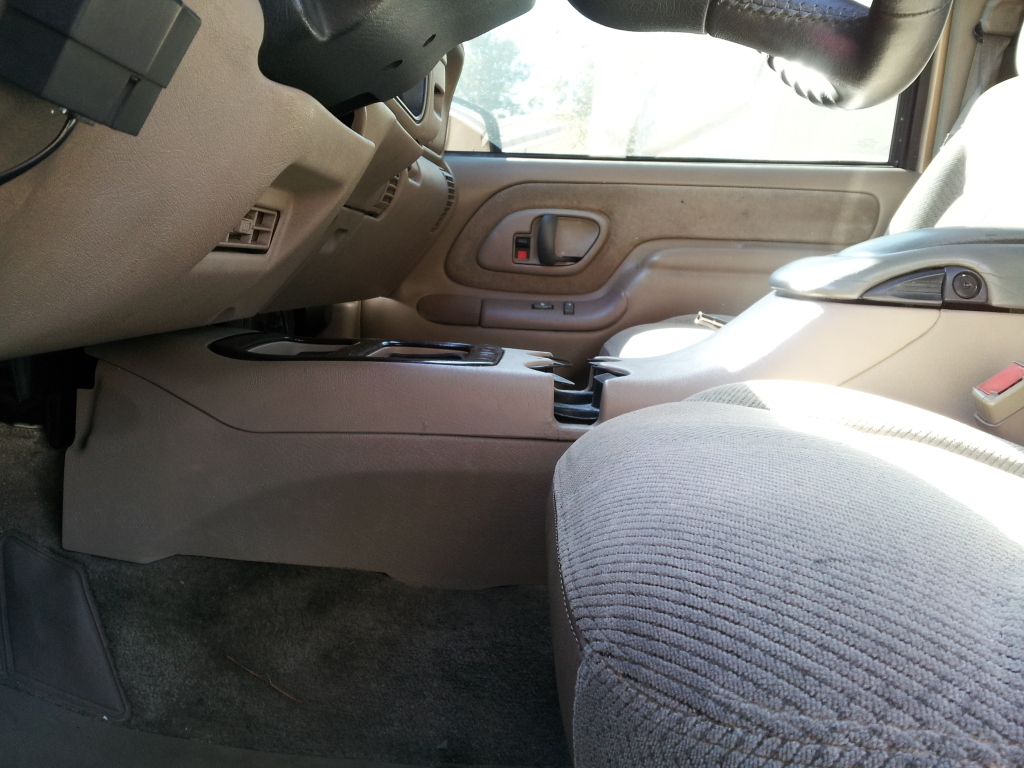

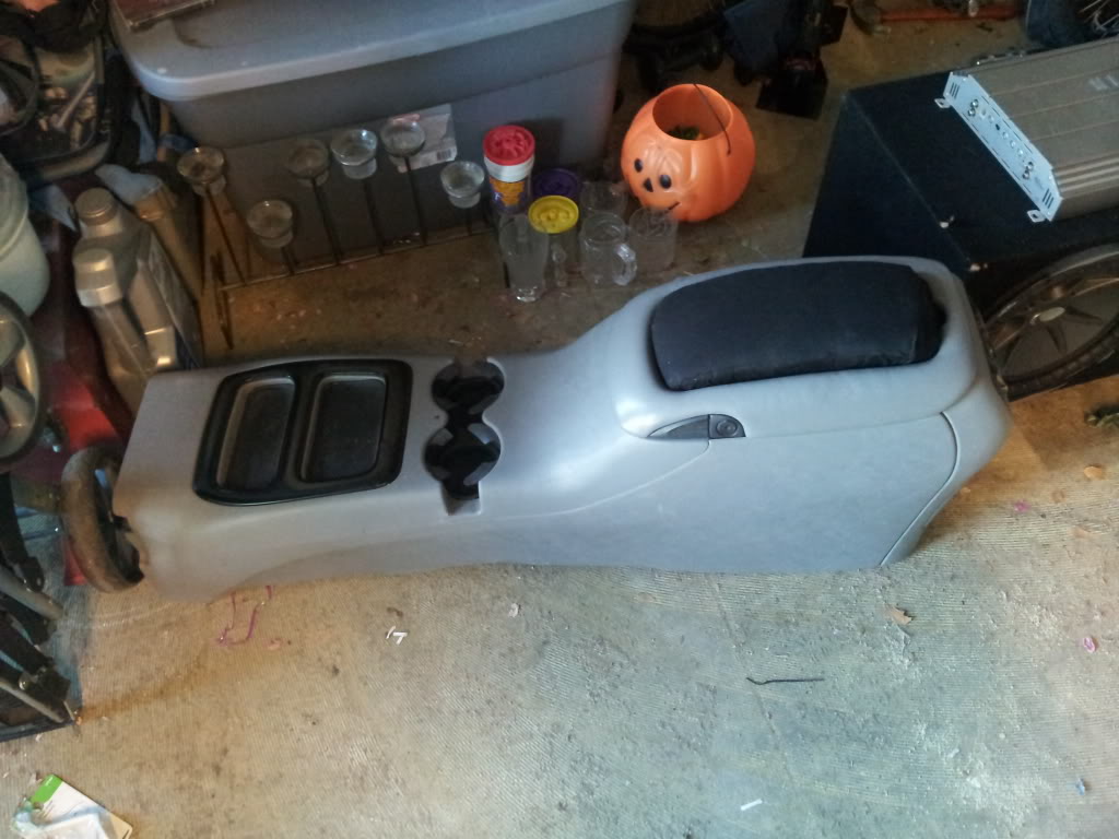

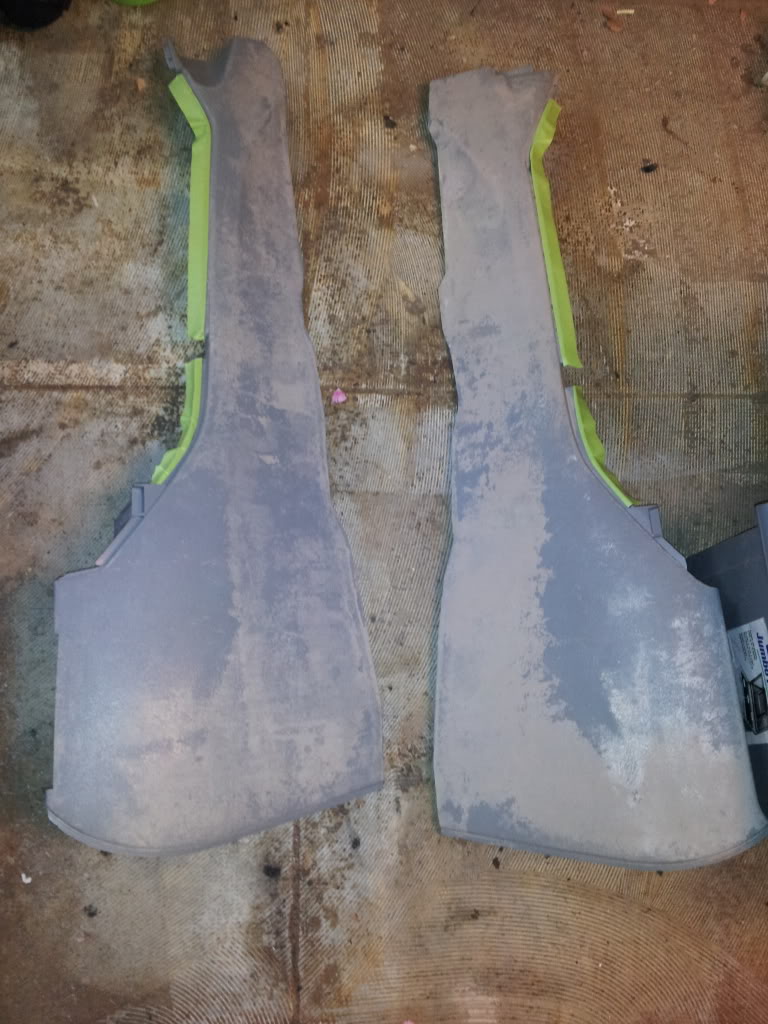

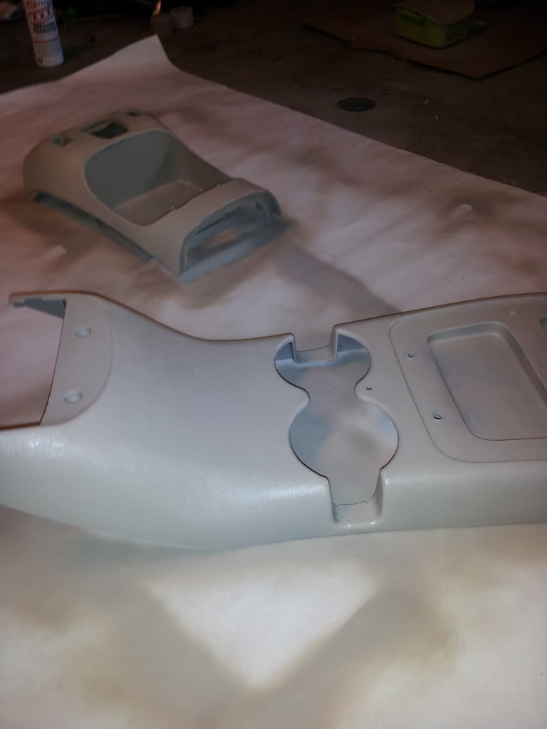

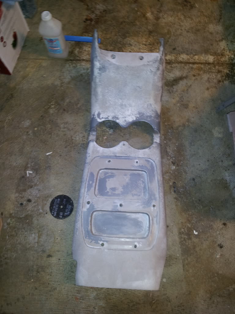

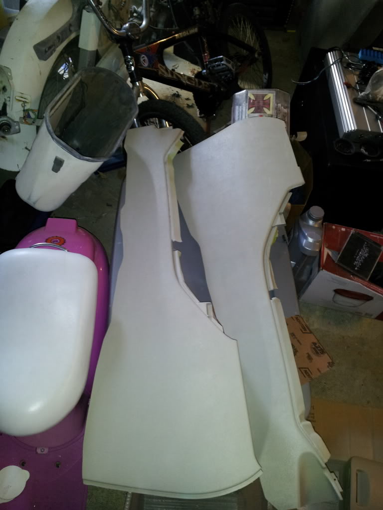

Went from grey (Dont be mad Mon! :) )
To tan
