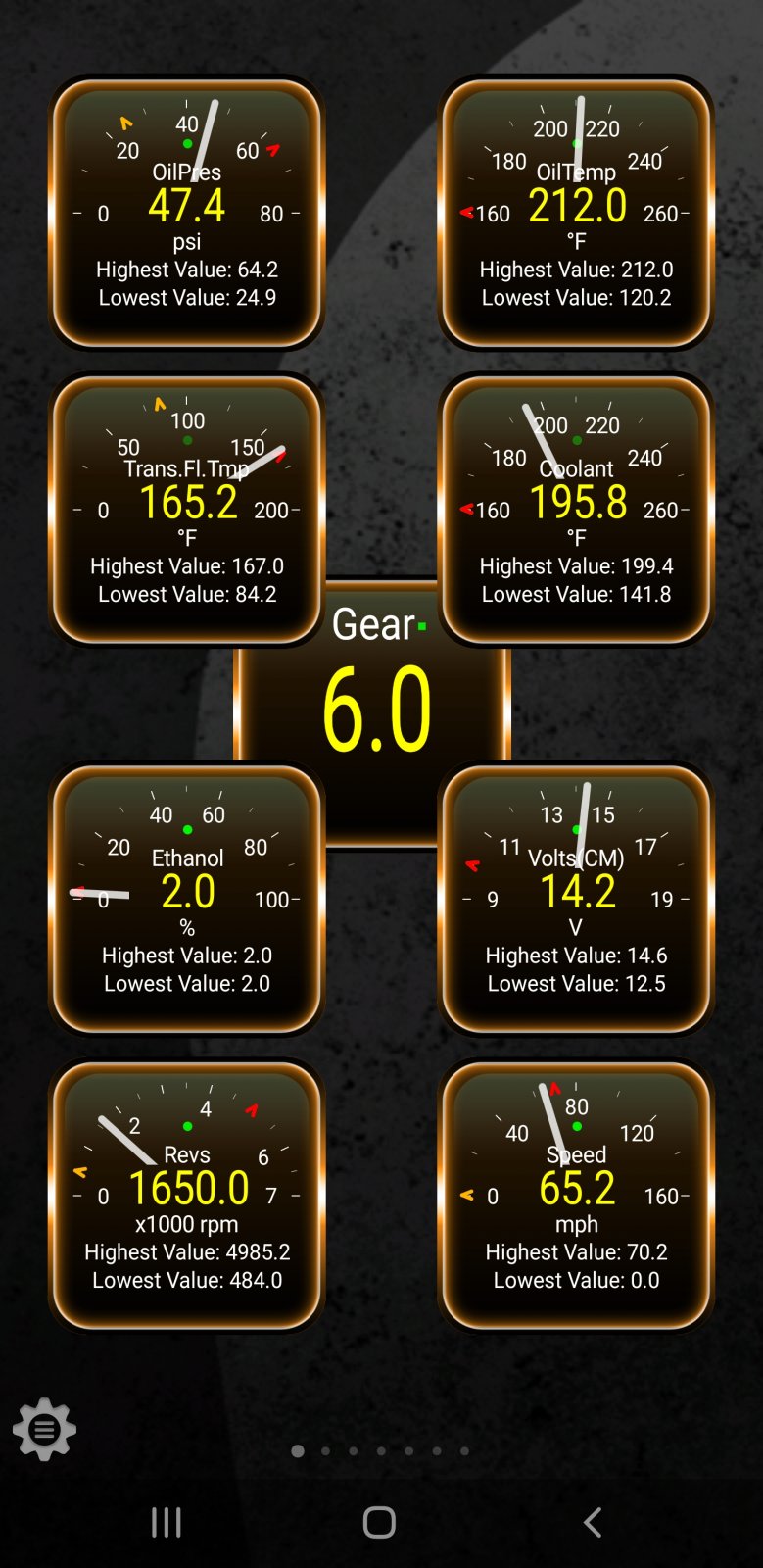

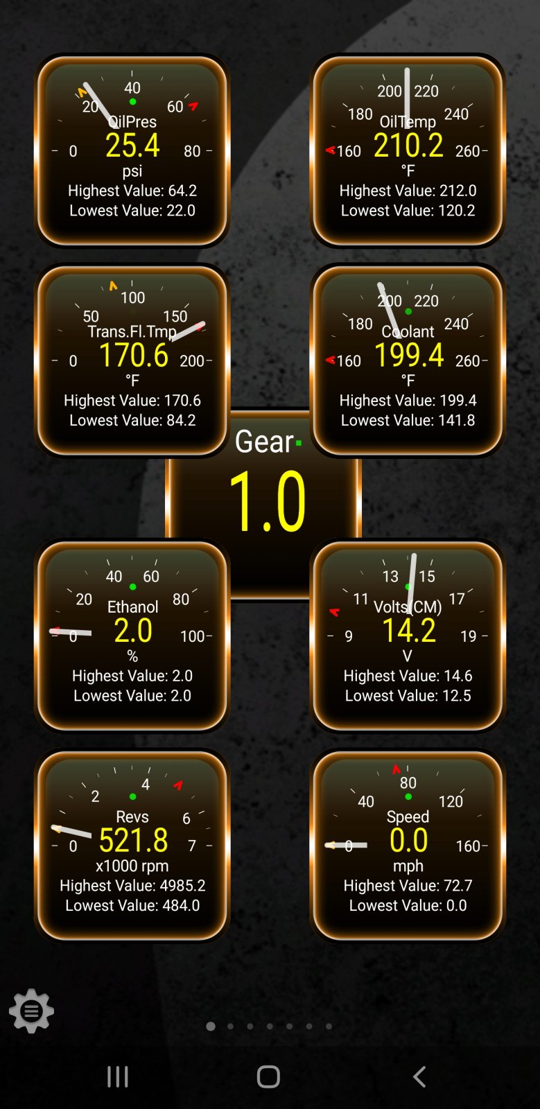

Our LC9s don't run as high an oil pressure as the iron block motors. Mine idles in gear in the 20s when hot and cruising under 40, the bypass on the pump spring is 36 psi or so. Mine has the new driver's side valve cover and does not burn oil unless it spends time above 3,000 rpms.
Mine has always been over 40 psi while driving on the highway and about 60 psi at wot. That's why I thought there was something off about my oil pressure during the check engine light.
