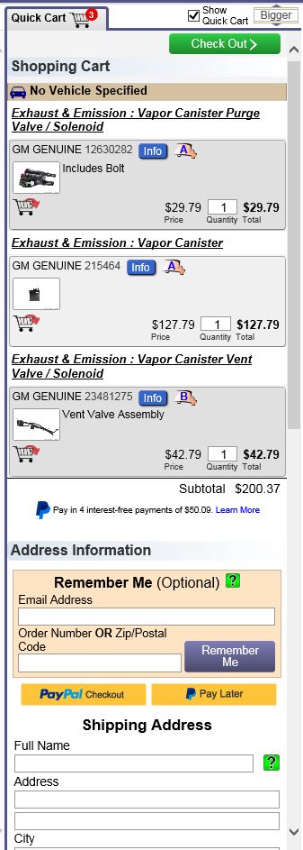

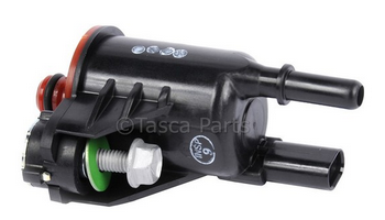

Are these the correct parts?
There are 2 vent valves for my truck, which one do I need or I need both?
Evap canister:
Vapor canister vent valve:
30,801
48,538
Evap canister:
those are the parts but those same parts are a lot less on Rockauto, plus you get 5% off with a code that is listed on the forum all the time, which sort of helps with any taxes.
