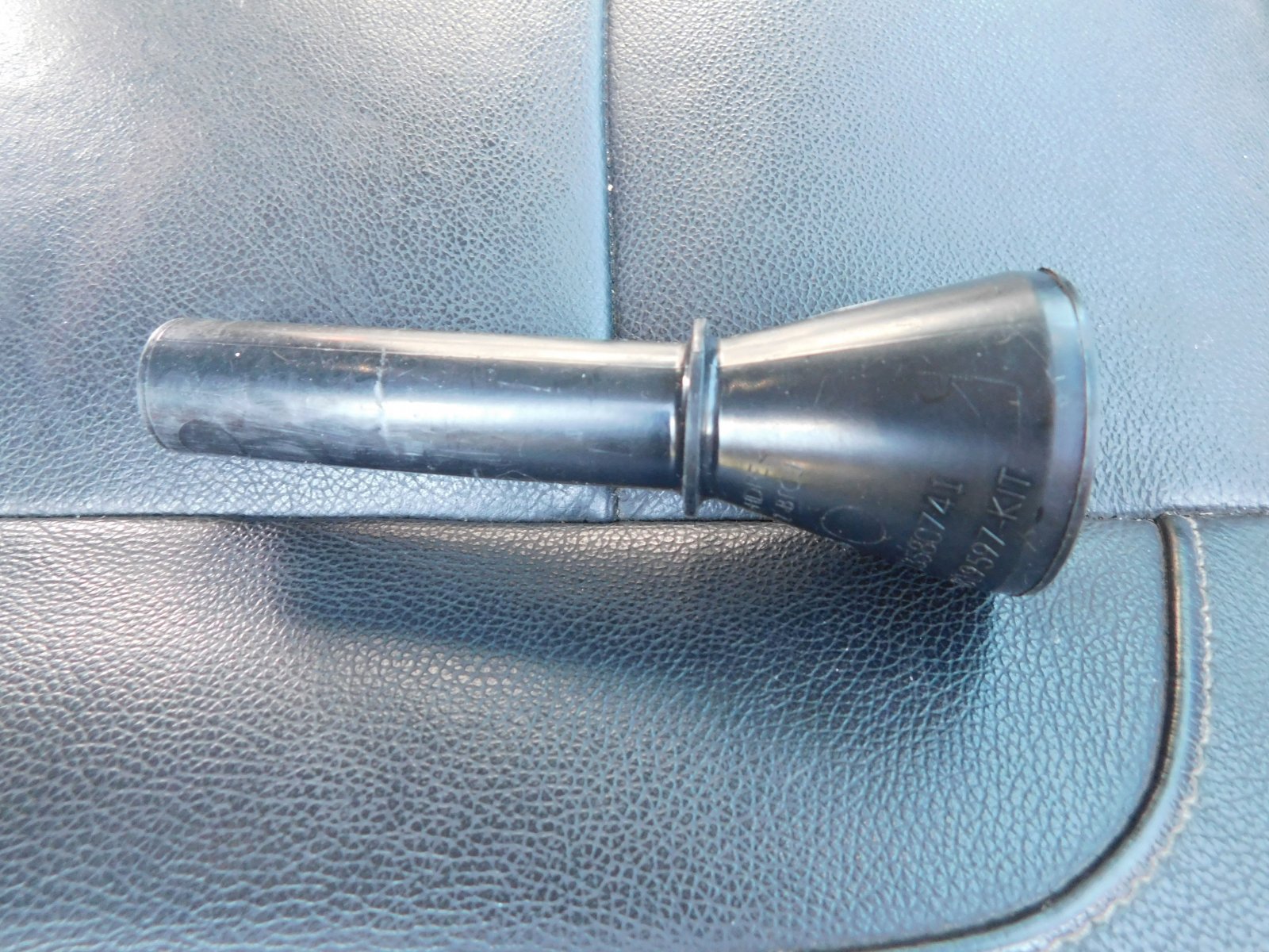

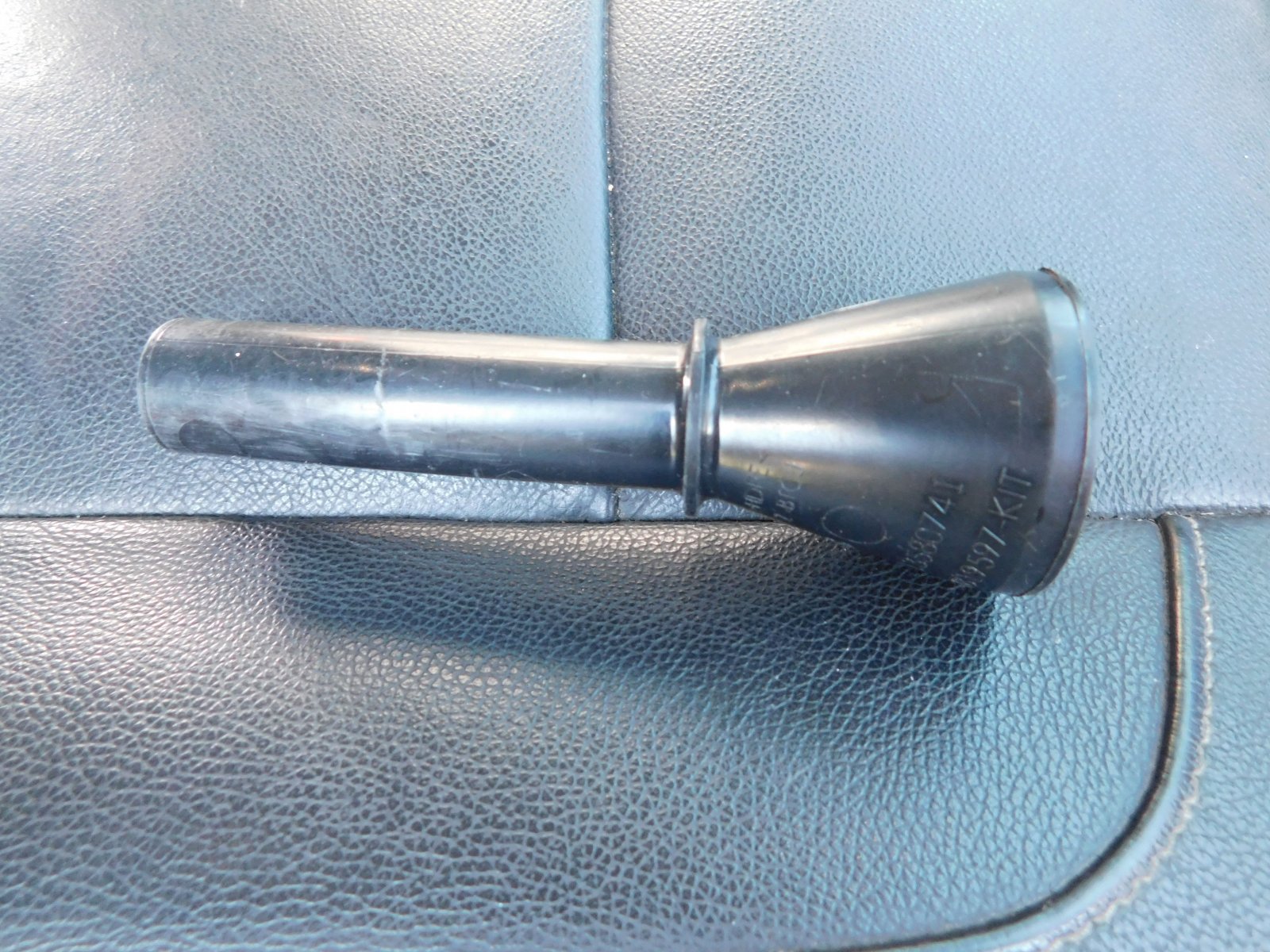

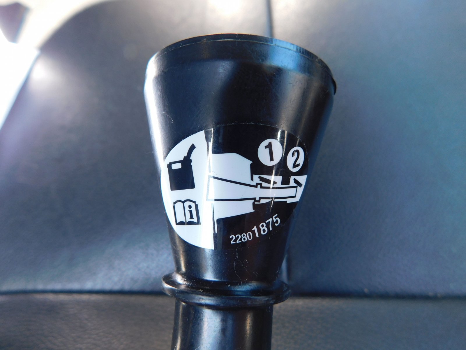

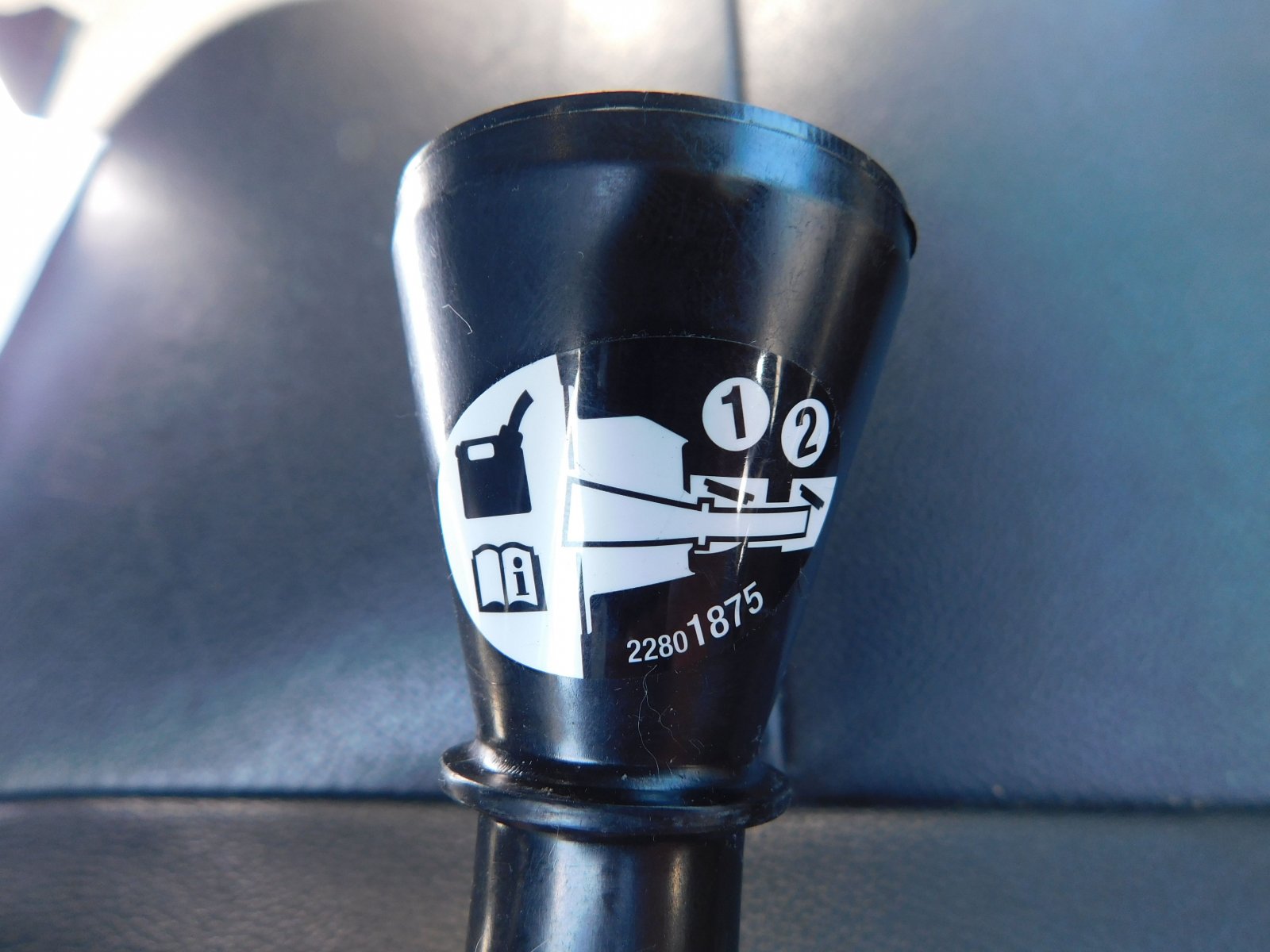

I recommend keeping one of these in the glove box for adding anything to the tank other than a gas station nozzle
gm # 22801875
View attachment 462831View attachment 462832
That's also how you can siphon gas out, on SOME of the capless designs.
