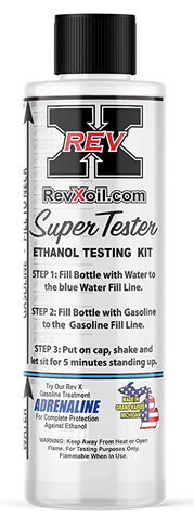

Why not start testing at the pump with one of these? Might be a bit of a hassle to do often but it should tell you.
https://www.amazon.com/REV-X-Super-...ocphy=9028763&hvtargid=pla-568587015246&psc=1
I have considered it. Not sure what I would do with the gas/water mixture after the fact... lol
Also not sure how easy it would be to get the gas into the bottle without making a huge mess.
And then there is the question of what to do if they are, in fact, spiking the ethanol numbers.
So many questions.
21,274
30,204
Buy an adapter to get the fuel from your rail and attach a length of hose to it. More than enough resides under pressure to fill the little bottle to take a sample. I just dump it on the ground or grass afterwards, no harm, no foul.
We're talking an ounce or two, the bottles look bigger than they really are Ken!
I have determined that my local Sunoco guys are playing around with the ethanol content in all of their fuels, you never know what you're going to get. The Shell and Racetrac stations are spot on every time for years now but are usually higher in cost. My go to Mobil and Chevron stations use very little, if any ethanol in their fuels.
So many questions.
We had a long hike this morning, so I had time to ponder all these questions.
I think the way to do it is fill a small gas can while filling up, bring it home for the test.
I happen to have a couple of small gas cans I use for my small power landscape maintenance tools. I throw away the CARB compliant spouts and use the basic screw on spouts (gasspouts.com) instead, so no spills while pouring.
After the test, I can pour the excess back into my tank and use a cheap plastic bowl to set some place discreet to evaporate the test solution. Once dry, throw the bowl away.
Next, if they are putting lots of Ethanol in the gas, sue them for a millllion dollars (in my best Dr Evil voice).
I think I will wait until all my tests point firmly in the gas station direction, versus some glitch in my software or sensors, because, well, the kit costs $13... :)
