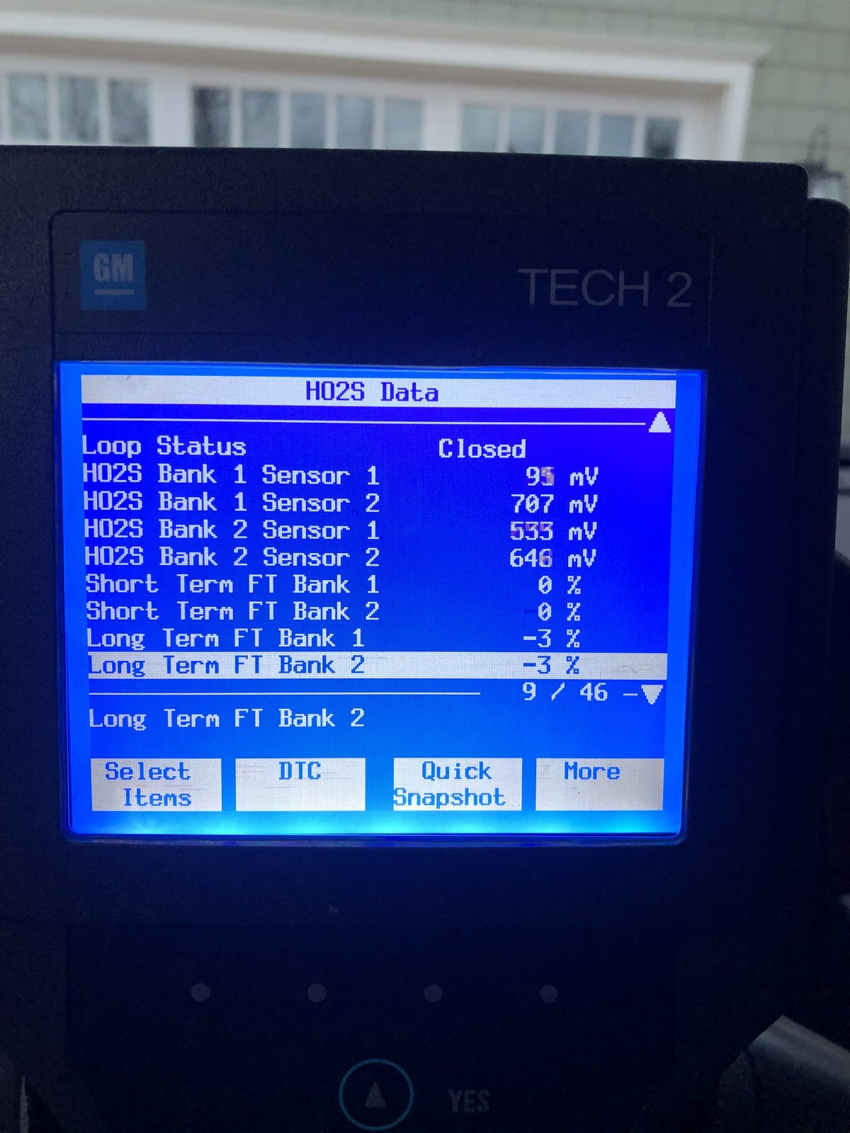

So here is a pic of my O2 data. I will have to figure YouTube or Vimeo out for uploads to post the video I took.
It looks like my Bank 1 Sensor 1 does dip below 100 occasionally (after it was up to full temp never below 91 that I could see), B2S1 seems to stay above 100 (like a low of 117?). B1S1 definitely dips below 100, like every 5-10 seconds.
It was interesting that it looks like one of my S2 heaters is not working as well as the other, as they were way apart until everything got really warm (or maybe one of my cats is marginal).
Oh and Ethanol content has not moved above 3% yet. I have not cleaned the MAF yet.

Here is the clip of the O2 sensor outputs, I hope... :)
Looks about the same as mine I believe.
Maybe there is nothing wrong with my O2 sensors after all.
My plan, at this point, is to run this tank down low, reset the alcohol content again,, and then top off with ethanol free 89 again and see what calculation the ECM comes up with.

I am going to follow a similar route. Run it down some, check the recalculated Ethanol percentage (which I will post), reset it after a fill up with Ethanol free and repeat.
I am also going to try and debug why the B1S2 and B2S2 are so far apart when it is warming up.
I wish I knew what a normal S2 voltage is just after a cold start, while it is warming up.
