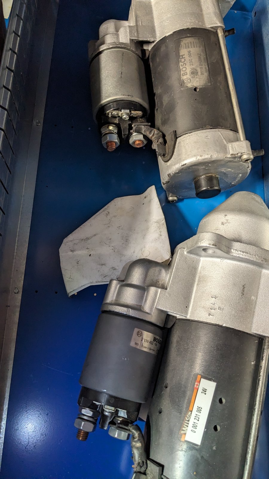

yeah I just looked in my drawer, no current starters in stock has copper washers. even the expensive denso and Bosch. on a funny note, pulled 3 brand new motor craft starters out of boxes and no hardware at all.
you know what those get getting haha. anything that fits. PXL_20240223_181140165.MP.jpgPXL_20240223_181113819.jpgPXL_20240223_181034408.jpg

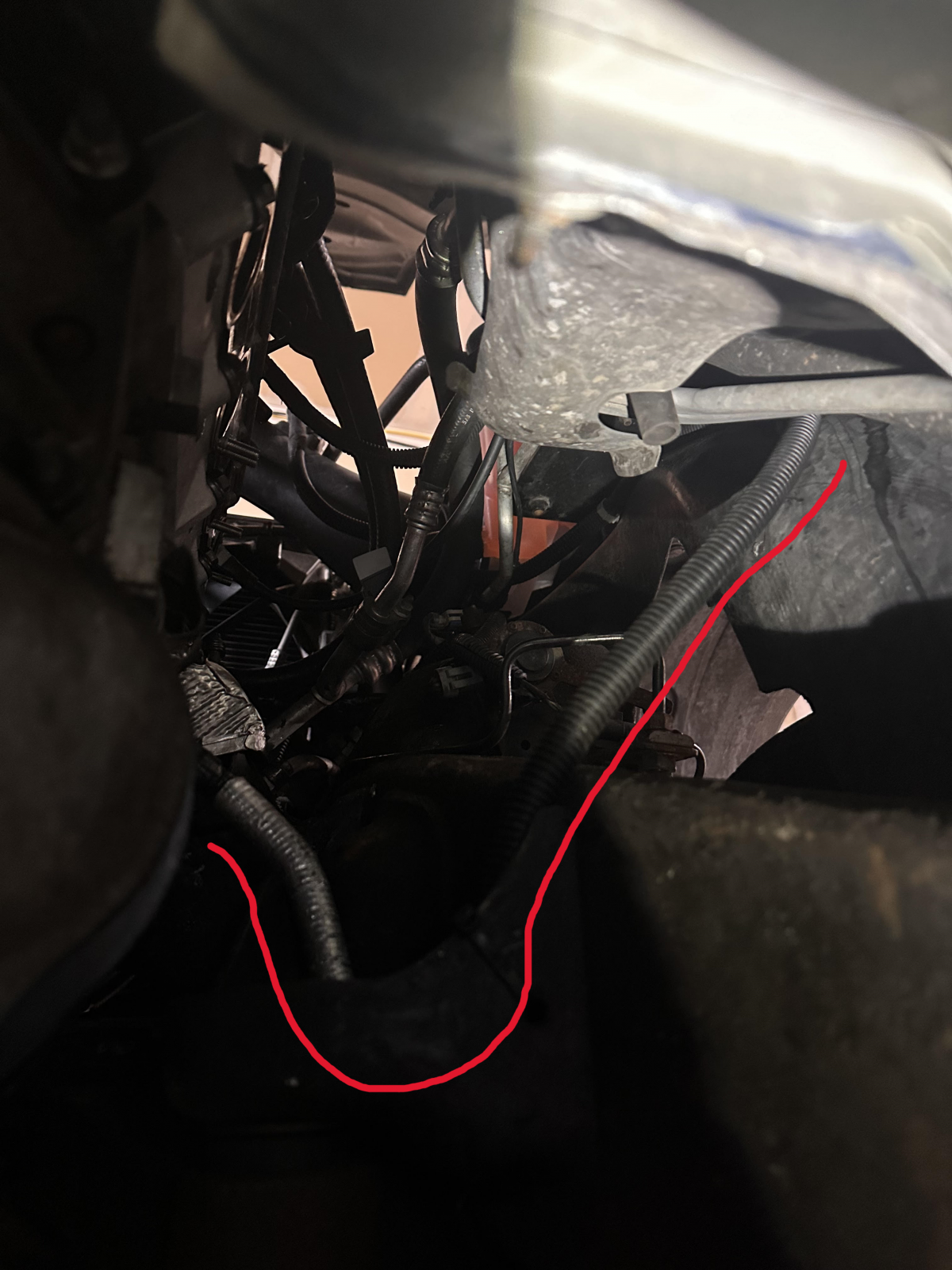

Fixed!!!!!
I got it buttoned up, did a crank relearn with Hptuners and did like 10 WOT pulls. Zero issues except I hear pinging from probably a lean fuel mixture due to the ported heads. I need to retune it. But I think I am good!
I think the issue was how I routed the starter wire, it had way too much tension on it with how I bent it out of the way of the header which probably caused it to loosen up and vibrate which is why the washer was broken. I routed it now closer to how it was with the factory setup and there is a lot less tension on it.
