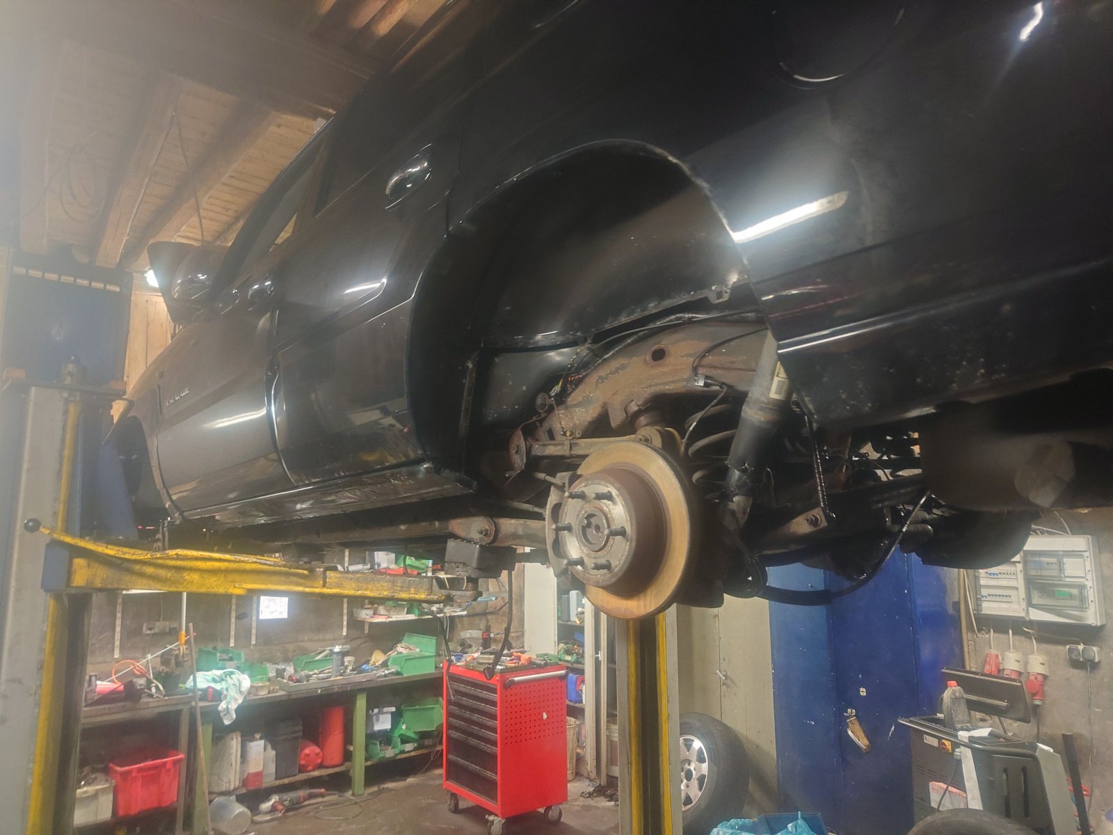

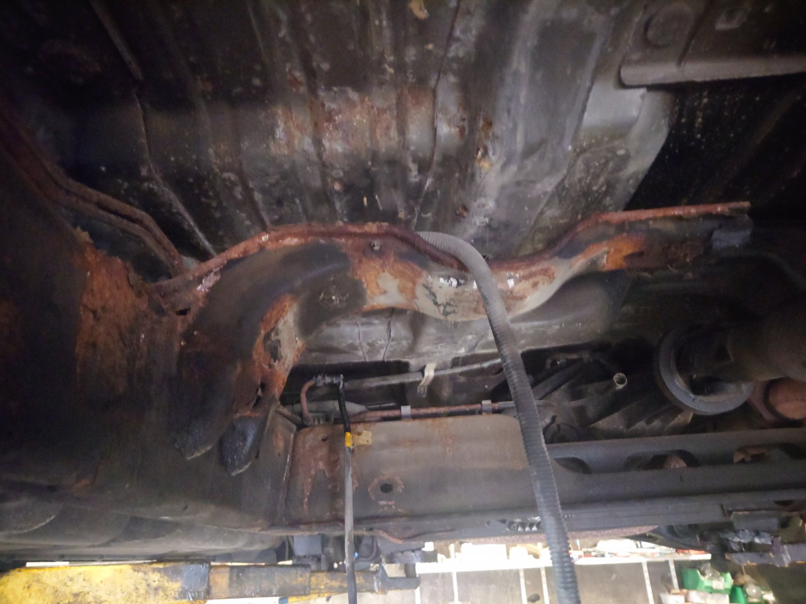

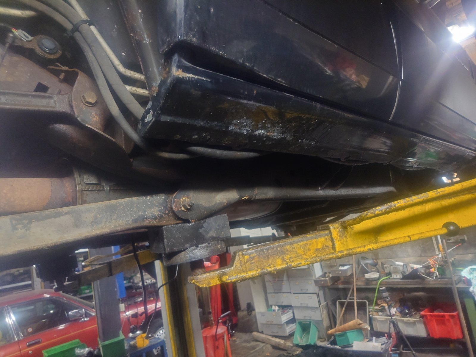

Everything disassembled for rust protection....
I'm looking forward to driving my beloved truck again....

So after dismantling half the car to protect it from rust, I've finally got around to putting everything back together.
The tank is in, the fuel pump is running, the connections are tight.
I was able to drive it again for the first time.
Thanks again to everyone for the help.
