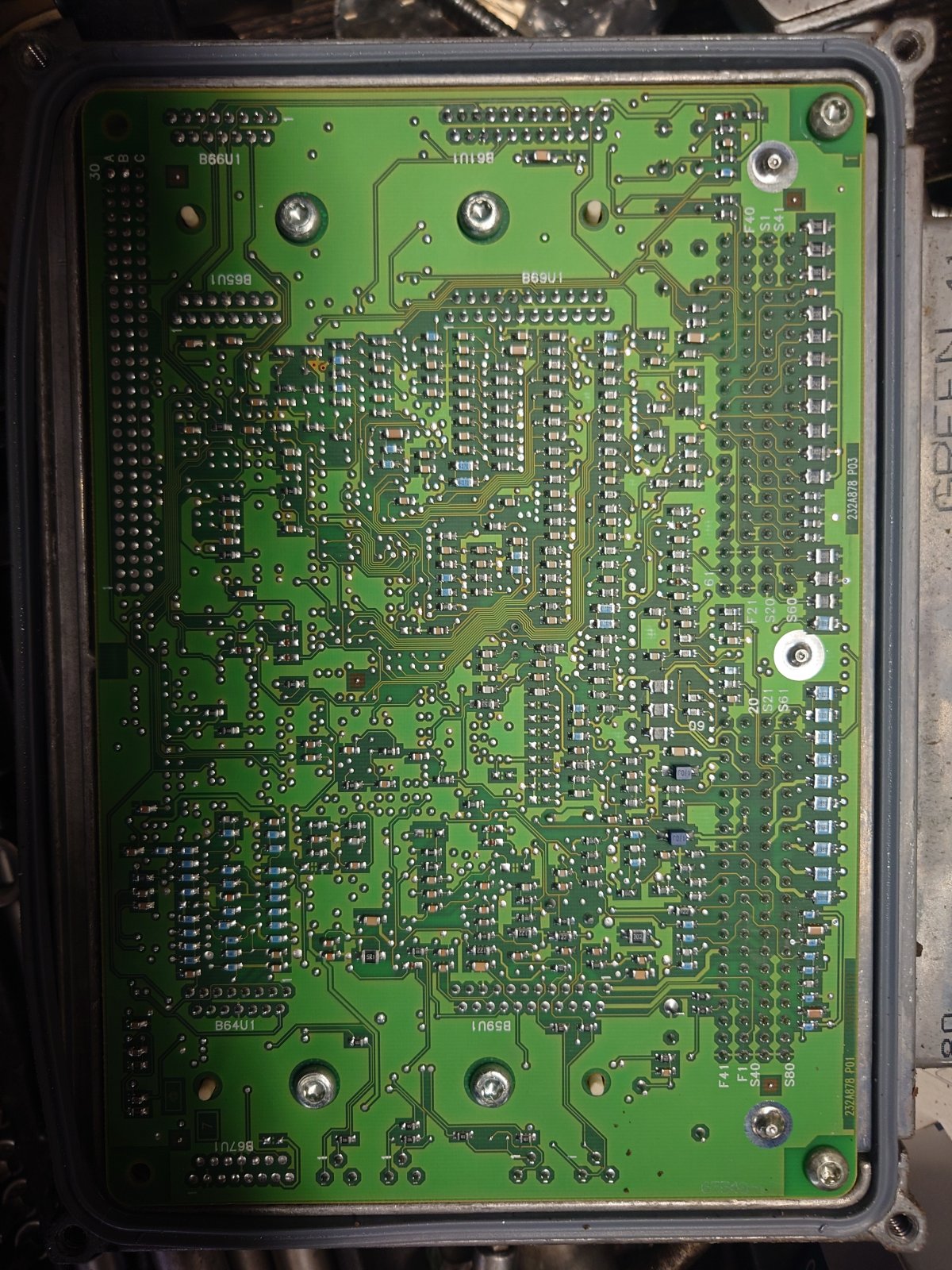

I disassembled today the PCM. The connector was absolutely clean, no green crust.
I opened up as well the PCM and as well inside, it looks absolutely clean.

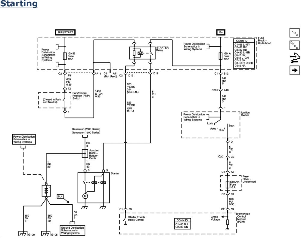

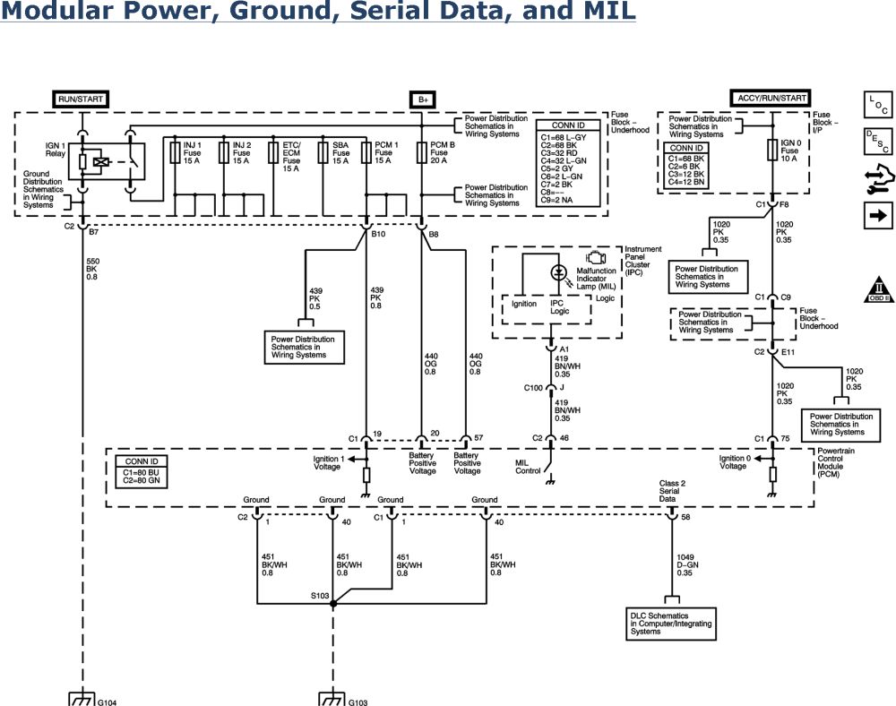

Ok I tracked down some schematics for you 2006 Esky. Igntion E fuse is the feed for the control circuit for your starter RELAY coil. PCM B goes to the PCM. Ignition A is the feed for your ignition switch. First check those fuses (We know the PCM B fuse is blowing) then I would pull that Fuse Block up off its base (After disconnecting battery) and check for the green crusties and other foreign material or rodent damage. You still could have a damaged PCM and/or other problem like the fuseblock but at this point I dont believe your problem is in the ignition circuit including your IGN Switch since PCM B fuse is not related to that circuit.

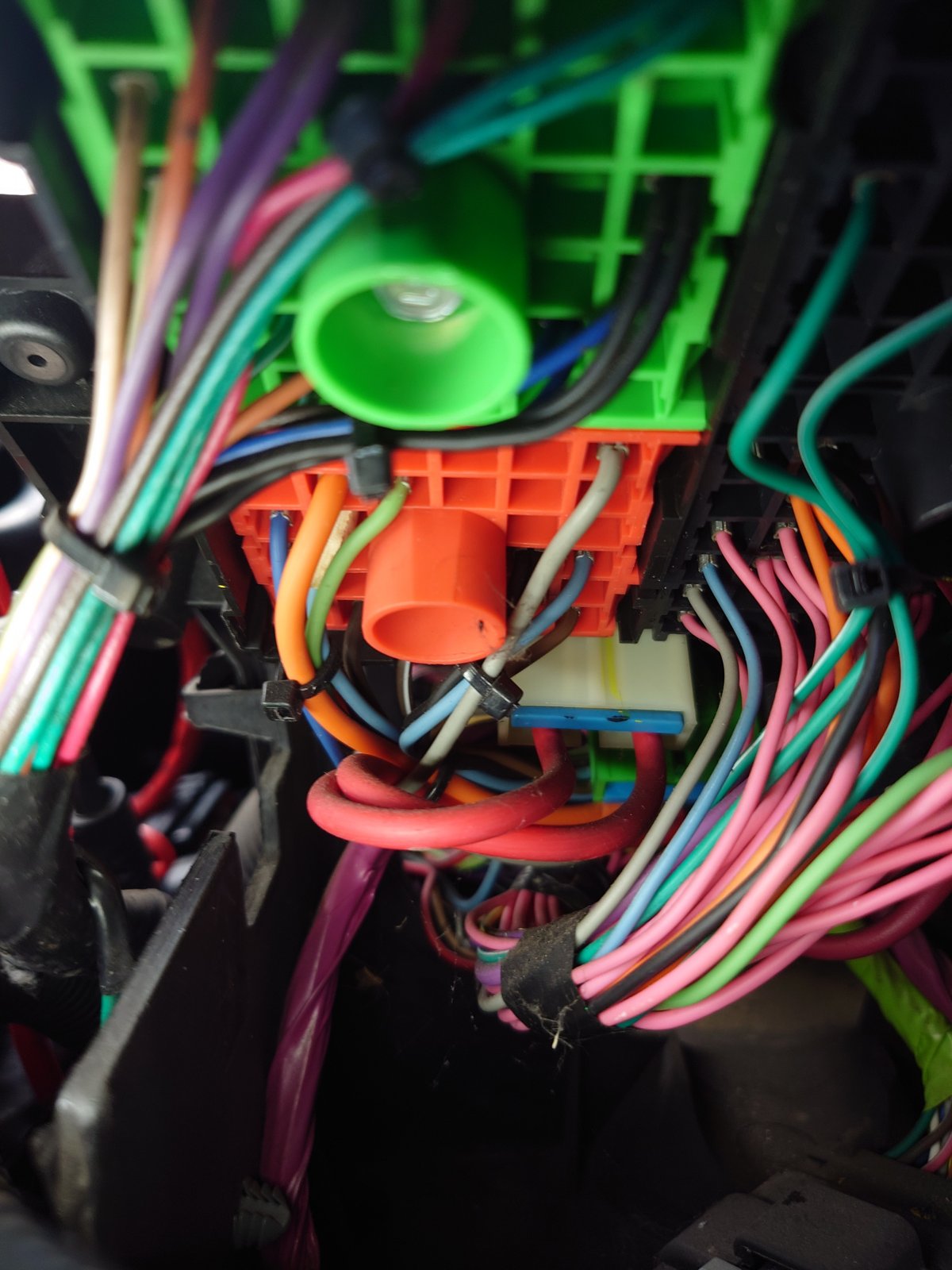

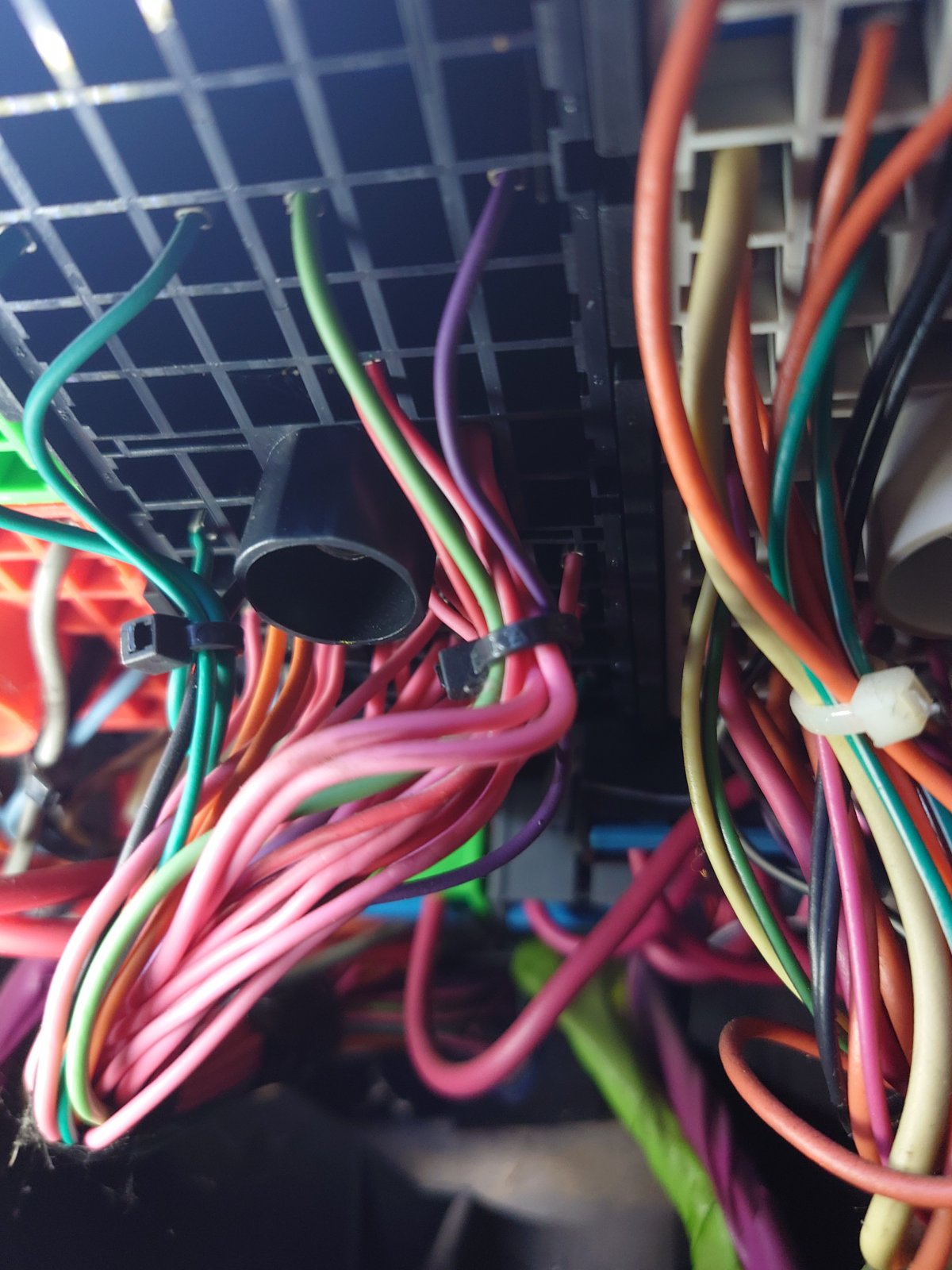

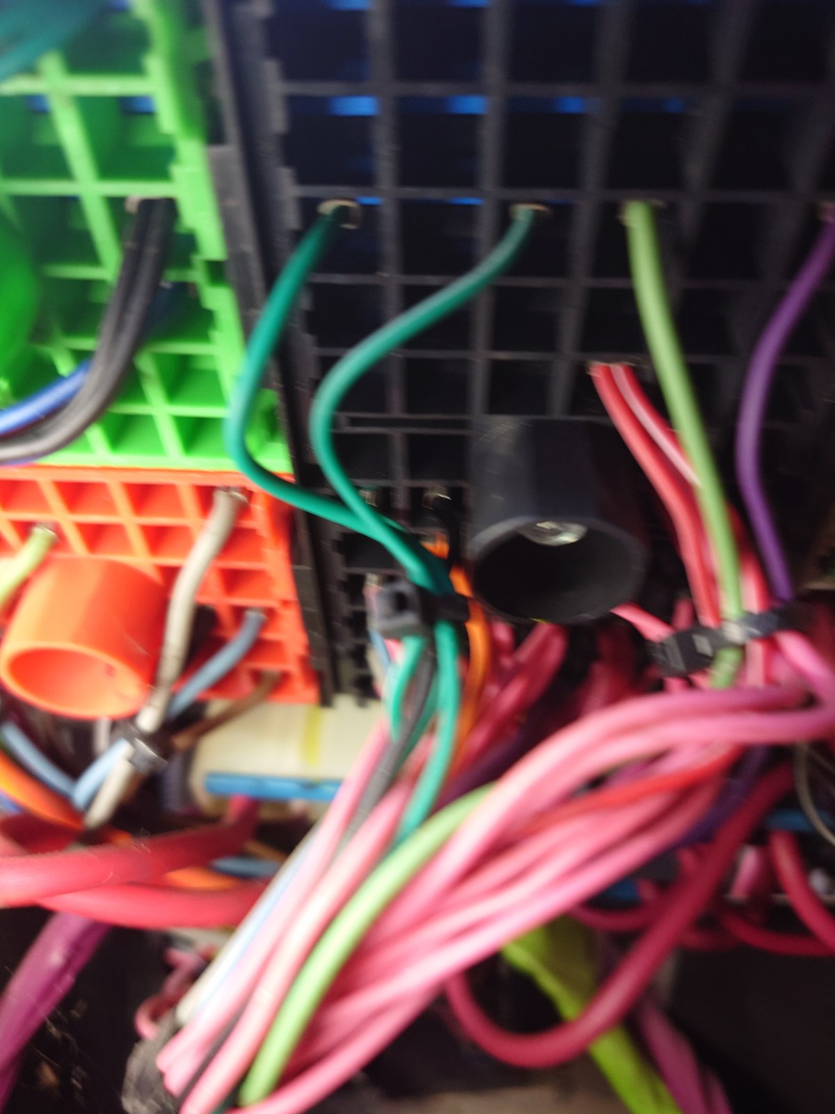

I had checked concerning the fuse box. Looks all normal without moisture or green crust...
