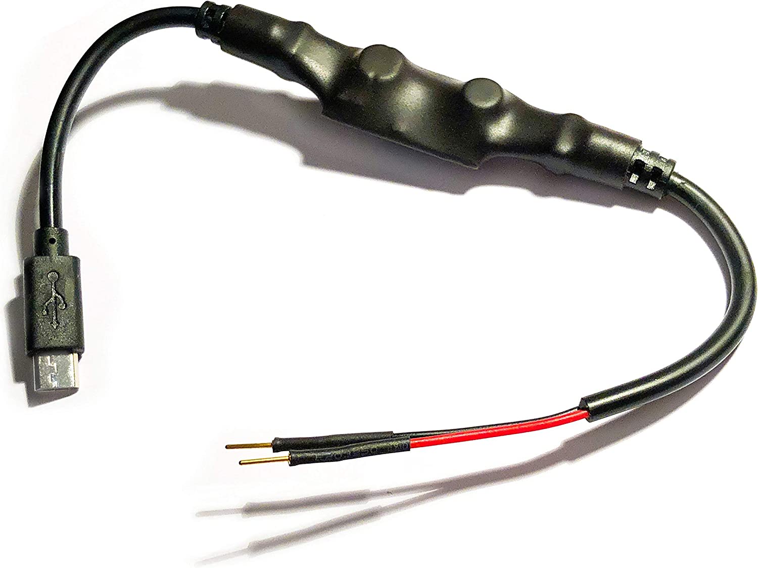

Eventually the dash cam and radar detector will be powered from top, and need to find source of power.
This powers my dash cam 24/7 from the mirror harness connector. Put the black one in Pin 8 and the red one into Pin 1. Easy peasy!
