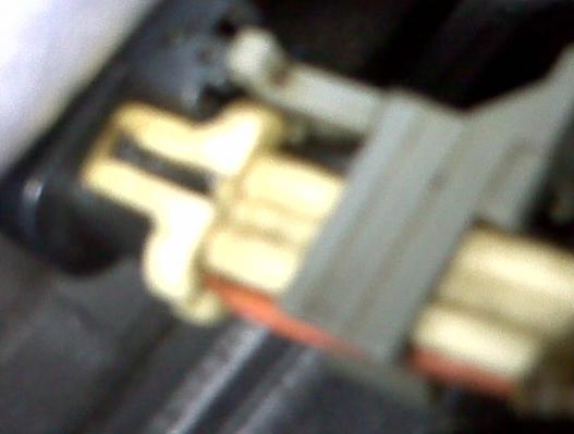

First time for everything, does just the white part of the connector come off the injector?

The entire blk connector needs to come off. The release for the clip is on the narrow side of the connector.

Boss,
There should be a pink wire that is common across all eight injectors. These need to get voltage when the ignition is on. The 2nd wire on each injector is the control wire and will be different colors for each injector. This is what will make the test bulb flash if the control circuit is working.

Yea, pull the grey positive locking connector tab up first, then you can press the small blk tab on the side of the blk connector and pull it off.

Boss,
And if the control circuit isn't working, then it's either a bad pcm or the control wire is grounding out or open somewhere.
