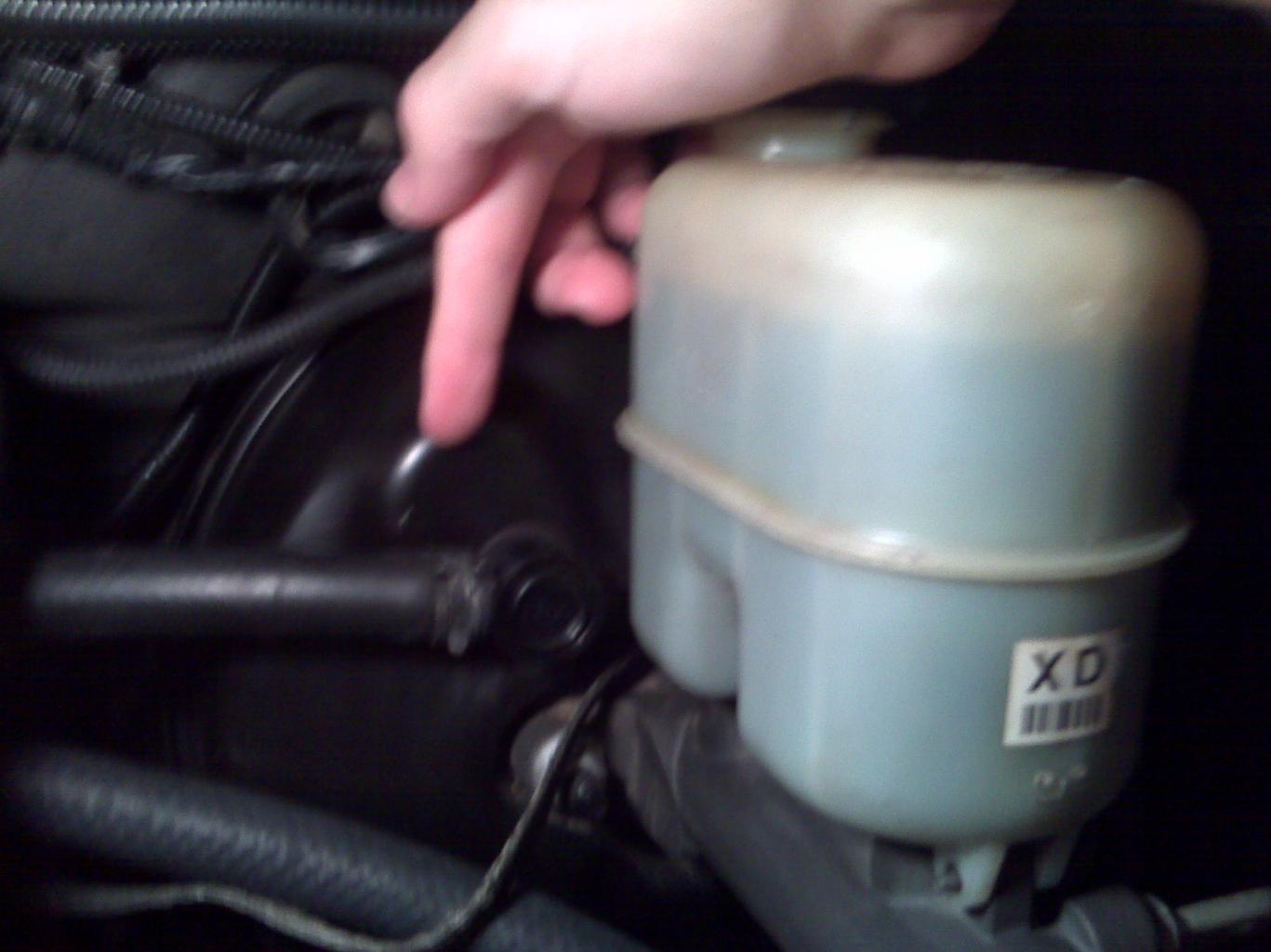

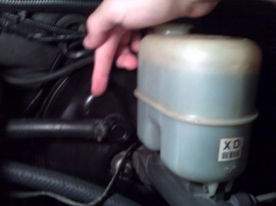

Installed 2 new o2 sensors upstream...no luck, still goes lean. It runs around 14-15 for approximately 6 seconds, then goes 15,16,17,18+ each second till the AFR goes red. So it REALLY seems like some sort of pressure issue. We had looked over the entire engine Sunday - checking cables, hoses, clamps, fittings....but I did have a question that might be just me not knowing. I attached a pic of what I think is the brake boost hose. Is it supposed to be able to swivel where it clamps by the brake fluid reservoir?

Yes, that part swivels. And no, the torsion bars are the originals, just clean:)
