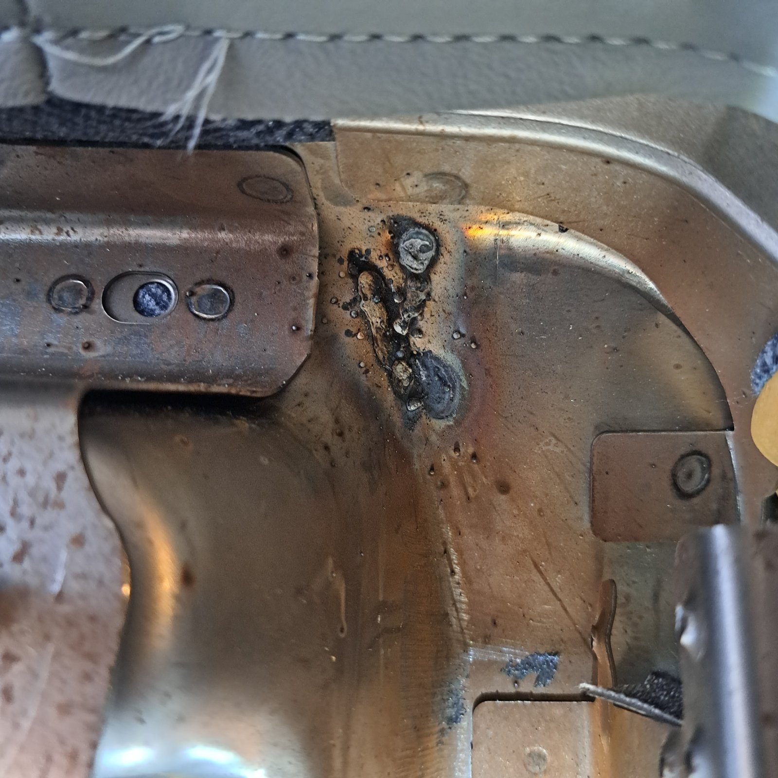

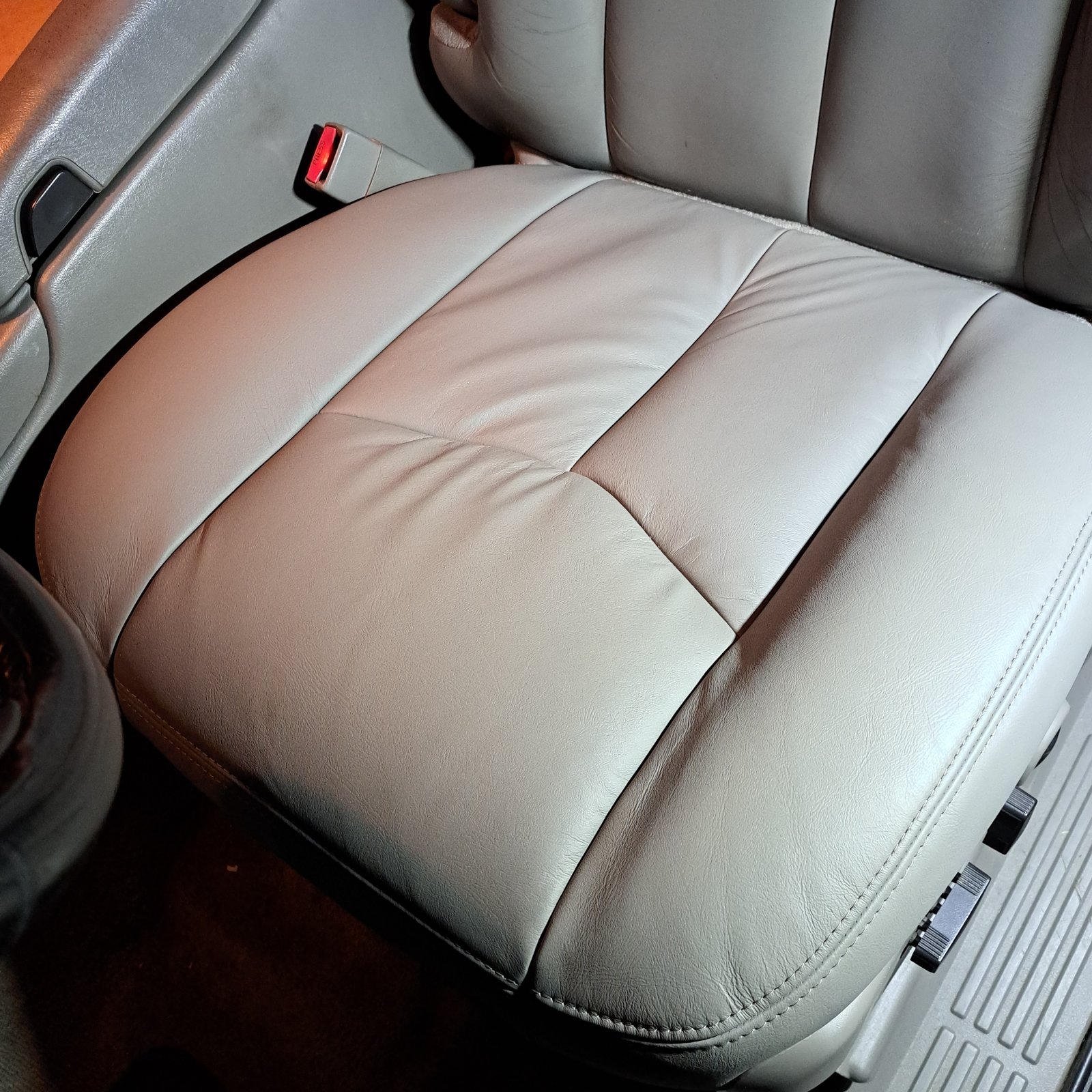

I've got a new foam for my driver's seat. Looks like I need to break out the welder to install it.
You don't need a welder unless the metal seat frame is cracked, like mine.
He said my seat foam was in great shape and would still add a small strip on the outer edge.

All in and working fine.

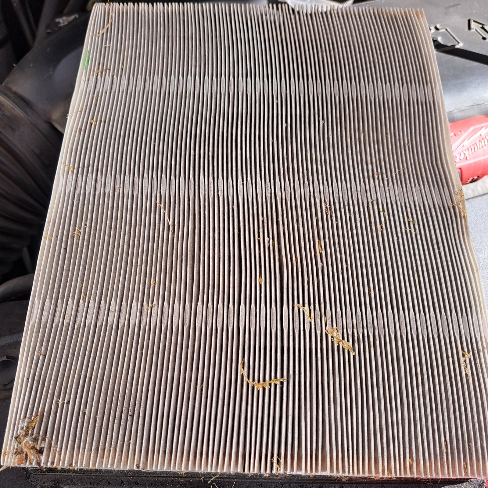

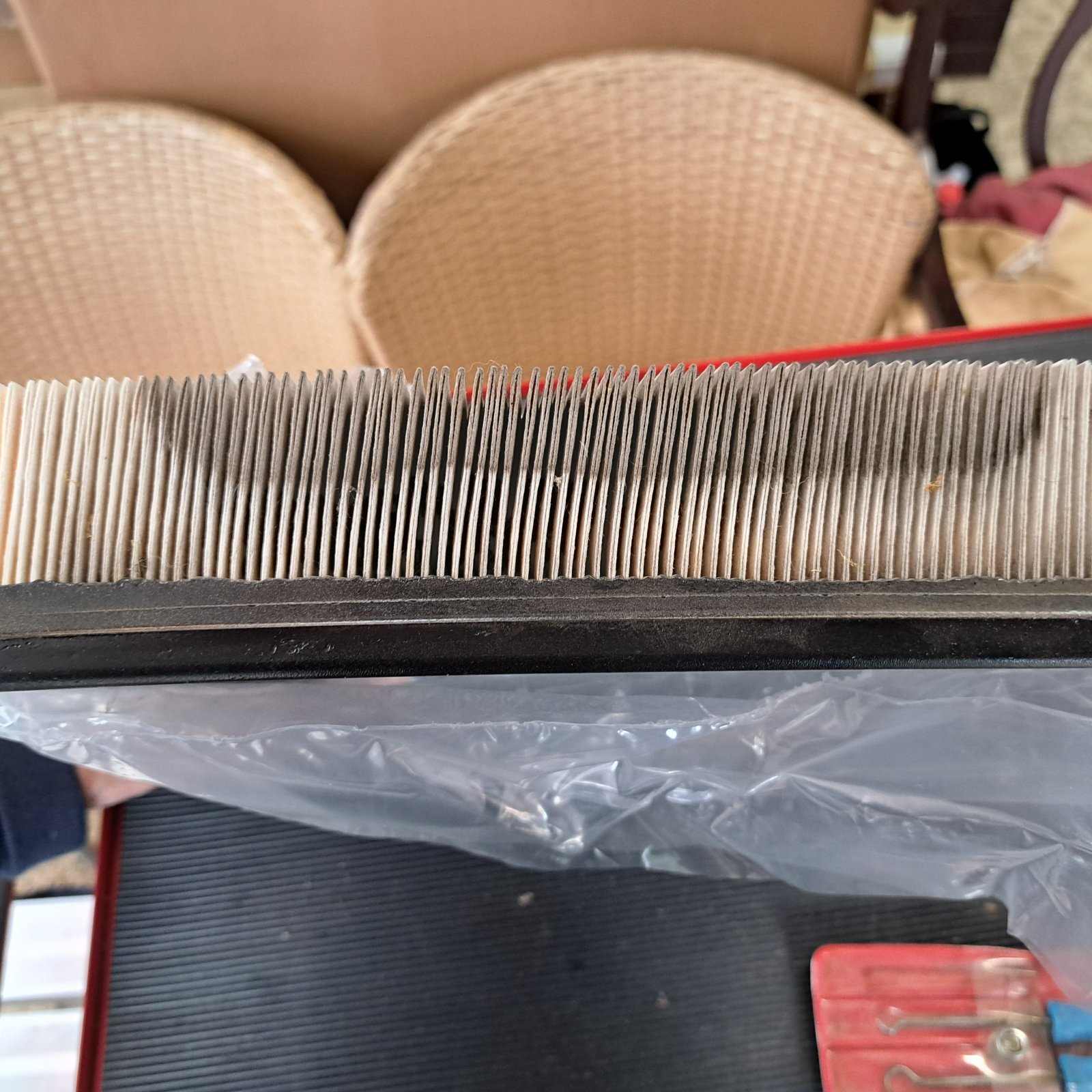

Oil & filter change day. WIX 51522 oil filter and Valvoline Restore & Protect 5W-30 full synthetic oil....6 quarts.
Cleaned the MAF and changed the air filter with a WIX filter.
Then I found this and pulled the nest out and vacuumed out the case and sprayed rodent deterrent inside the case and all over the cowling area and the engine compartment.

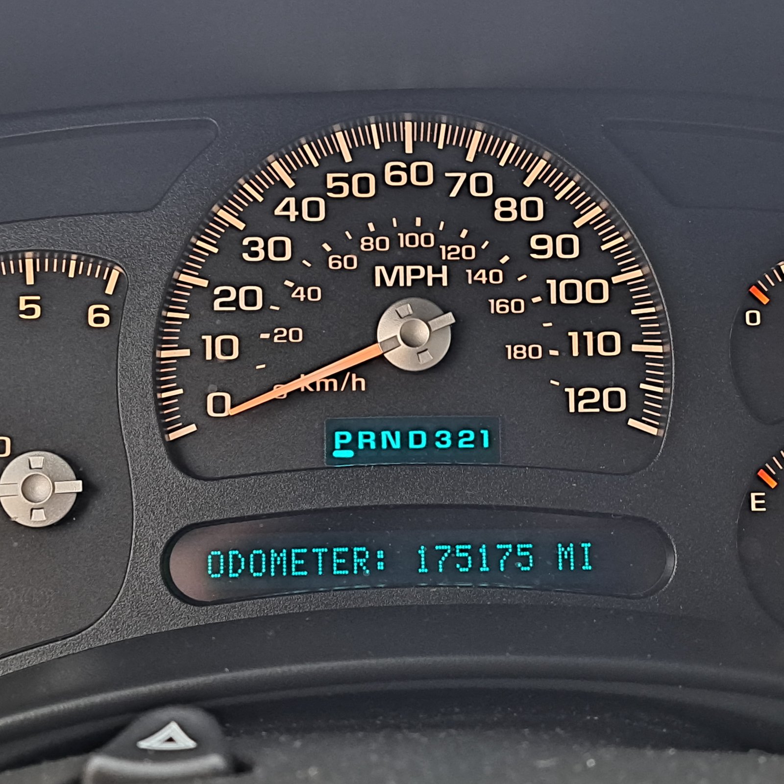

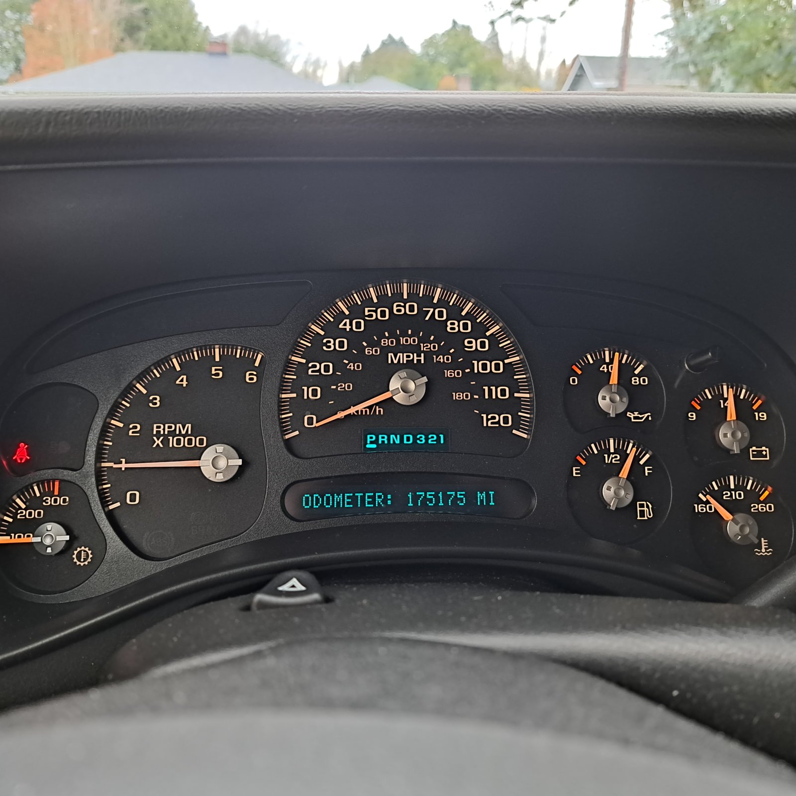

Took off this morning to go to Portland International Airport to dump my girl's daughter for her return trip to Dallas Fort Worth Airport. I say DUMP because it has been a long 8 days. Anyway, on way back and within 3 miles of my house, my speedo turned to 175,000 miles and it is still running as good as ever. Idle oil pressure is at 33 to 35 psi, highway speed of 75 mph oil pressure at 50 psi, hot coolant temp always at 200 degrees and charging system at just above 14 volts at idle. No CEL's since I did O2's about 3.5 to 4 years ago.
I still say and always will, that the GMT800 series is the best and most dependable.

Went to go get parts and fluids for a major job/maintenance on my landlord's 2018 Suburban and looked down before pulling out of driveway and saw this.
View attachment 474747View attachment 474748
LOL, that kind of number magic will send mama straight to the lottery ticket store. She never expects to win, but then again... And she just has fun with it.
