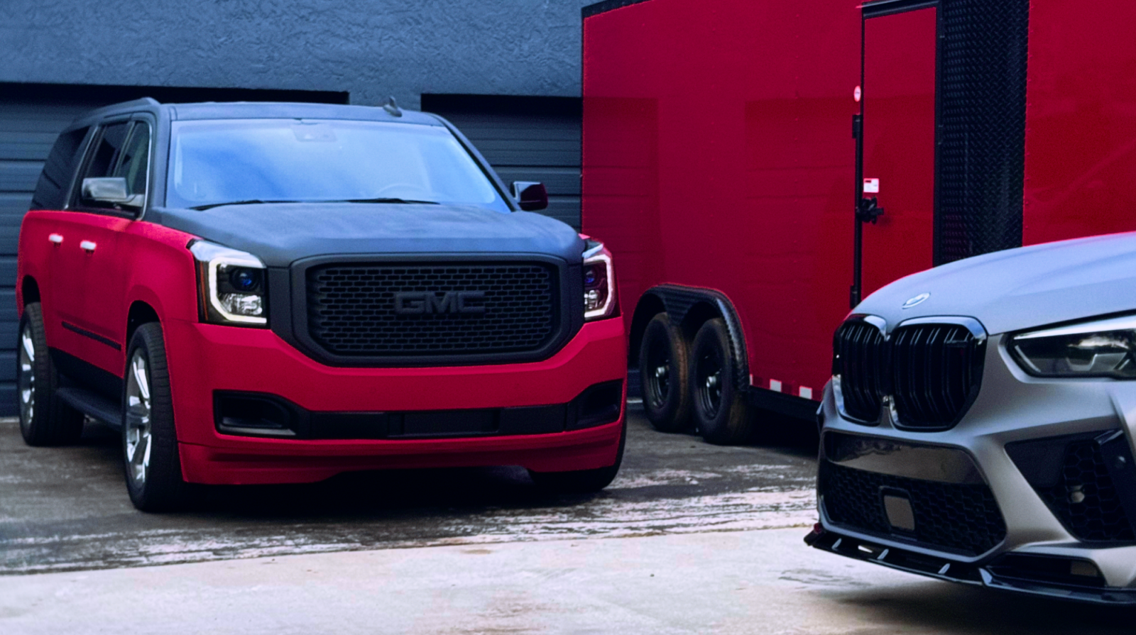

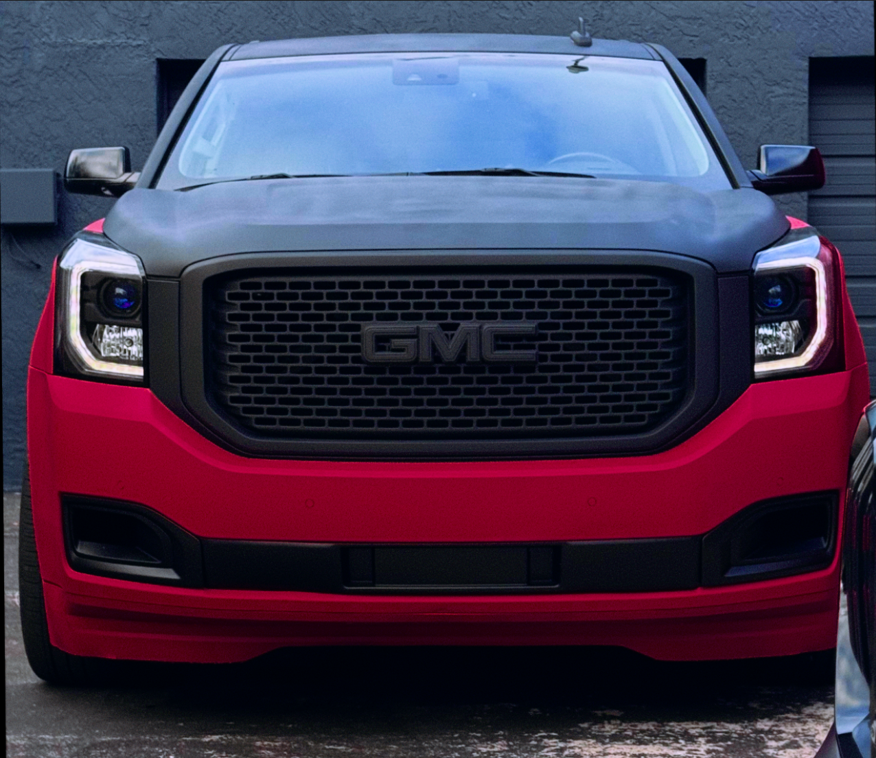

Masked the Yukon again last night. Deja vu on purpose, three paint steps means three masking parties.
The red showed up and… wow. This is red.
I stared at the sides at 6am on the school run and thought, well, that escalated. The garden cat approved.

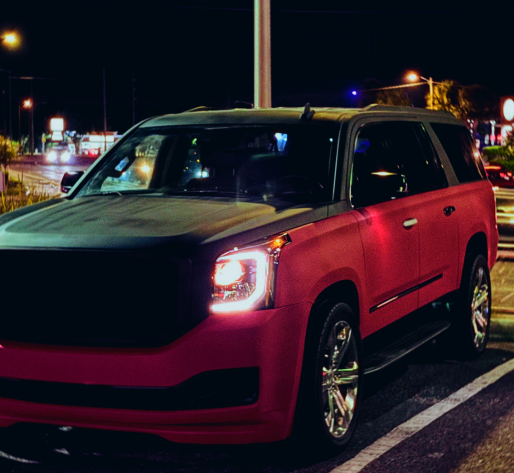

Clocked into the 9 to 5, clocked out, clocked the backyard. One light hello coat for adhesion. Ugly on purpose. Two real coats for coverage.
Then a light coat of regular clear to say hello, and a second as the buffer. If jet black sneaks past the tape later, I would rather shave sacrificial clear than chew into color. Future me says thanks.
I want to report a perfect evening. I cannot.
Florida heat had me second guessing, so I added about 10% reducer. That was the wrong kind of brave. Two runs showed up on the driver fender and door. Nothing tragic. Razor, patience, forty minutes. Time paid. Lesson learned.
Fresh out of paint and back to masking. Deja vu with blue tape.
Morning plan at 7am
- Wetsand the clear over red with 800
- Finish bagging windows and the new red
- Spray jet black on the rest: panels, handles, grille, lower bumper plastics
- Unmask and shoot matte clear over everything
Matte clear is new for me, so this is the spicy part.

Сoffee, clouds, and questionable decisions. Woke up late. Yesterday’s masking sprint taxed the soul. Grabbed a Dunkin, snagged a 2-inch and two 1/2-inch blue tapes, and headed to the backyard.
Wife came out to keep me company and promptly saved an hour of my life. We tag-teamed the chrome: grille bits, trim, bumper inserts. If she had not jumped in, I would still be sanding and arguing with my own elbow.
I staged cups, strainers, gun… then realized I was out of cups. Quick Harbor Freight run, back to the improvised workbench.
Overcast, Florida calm. One light introduction coat. Compressor decided to develop a personality: used to fail to restart, now refuses to stop. LVLP outruns a 25-gallon unit anyway, so I babysat the switch between passes.
Fifteen minutes. Second coat on. It is already 3pm.

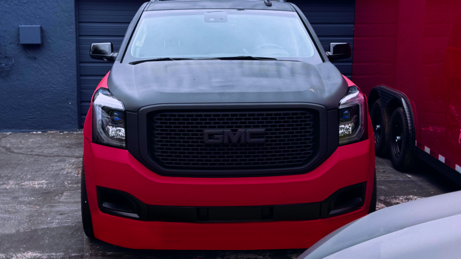

Lined up for a third and the sky gave me that look. I passed. Hood and roof already have two coats. I will live to spray again.
Pulled some tape and realized I had not masked the headlights separately. Thirty minutes gone. Florida microclimate did its thing: sun on my street, thunder on the next one.
Mixed a half gallon of matte clear. Weather looked dicey, so I stayed with a medium activator and skipped reducer. The brew looked suspicious. Laid one even coat. Not very matte…
waited 15 minutes, drank coffee, came back - boom, matte Yukon.
Lined up for coat two, saw the heavy clouds marching straight at me, and surrendered. One coat it is.
Plastic sheeting was a no go. Fresh matte plus plastic equals future therapy. Instead, I grabbed the leaf blower and did laps around the truck to help the flash time. Thirty minutes later, first raindrops. Then the full Florida demo reel.
I cannot fight weather, and the clear felt dry to the touch (thank you, medium activator). Hoping it holds. If not, I still have three quarters of a gallon to fix the crime scene. Small win: I did not do two coats. That would have been a guaranteed fail.
Paperwork reality: I wanted to file Monday. Rain nudged me toward Tuesday. SEMA is 25 days out, so timing is tight. Registration is 1–2 weeks, plus a day to submit and then the inspection wait.
Tomorrow’s gambit
- If the morning air is kind: spray a second coat of matte, de-mask, snap a few photos, sprint to DMV before 10
- If it is swampy: leave the single coat, de-mask just enough for paperwork, file anyway, and fix the beauty pass after
p.s. Could not sit still. Snuck outside before it went fully dark to check the matte. Rain danger is not the water, it is the micro grit those drops slam into the clear at terminal velocity.
Grabbed the blower and went to work. Sides are clean. Windows and upper edges clean. Hood has a whisper of texture you would miss unless you squint.
So the plan holds: one more matte coat at dawn, then de mask and DMV.

Yukon update while the Mustang glue cures. SEMA clock says 19 to 20 days. I need at least three just for vinyl wrap, so Fastback has to stand on its own feet by the 27th. The villain of the week is the super glue activator spray. One careless breath and your skull files a formal protest. Mask on, outdoors only, sunrise to sunset. Neighbors think I am fumigating the backyard.
To stay sane I bounce back to Yukon between glue sessions.
Hood saga. Round one got rained on. Round two I sprayed early and the medium reducer flashed in mid air. Hello tiger stripes. Not a crisis, just annoying. I will wrap the hood in matte black before travel. I also started vinyl on window trims, handles and the other chrome. Full blackout. Picked up black door trim and will sort the rear bumper after SEMA. Easy to overdo it there.
Headlights. I skipped the triple LED carnival patterns. Denali light shape is already good. The problem is all the chrome. Everything reflects everything and the face turns into ALL CAPS. I grabbed a simpler aftermarket set. Tech is basic, which you expect at 60 on Alibaba -> 200 on Amazon, but the form language is cleaner. I will drop in proper LED bulbs with ballasts. I do not need lasers. I do need to see while towing across a few states.
Splitter. OEM reads dated. Quick fix now is a splitter that follows the bumper outline, one simple lower line, about 1.5 inches taller to put visual weight down low. And yes, you still keep a visible break between bumper and splitter. The eye hunts for that seam. When it is missing, the whole face feels off.
After SEMA I will buy two grilles, cut them horizontally and add a few cells to stretch the face 2 to 5 units vertically. Same trick with two bumpers. Lower the center line and black insert a few inches. Then the splitter can be smaller because the whole face will sit lower visually. Meaner without breaking the ratio language.
Evening epilogue. I was wrapping a door handle by phone light, set the blade down, reached blind, and donated a sample. The truck got a blood splatter livery. Kids saw the toilet paper bandage and declared a Walgreens run. On the way back I looked at Yukon under the parking lot lights. Not bad. With the right wheels, it will read right day and night.
Quick hits
Hood gets matte black wrap before travel
Full chrome delete is underway
New headlights in place -> real LED bulbs and ballasts
Splitter right after SEMA, grille, wheels, large brakes, and bumper geometry + wide body play around Christmas
Back to glue, sand, repeat.

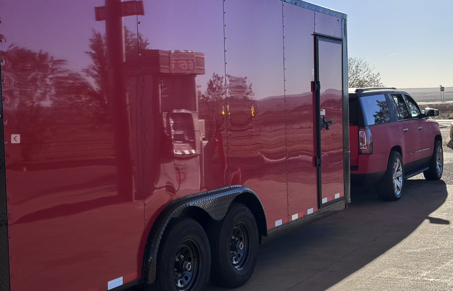

5,000 miles. Zero tantrums.
The 200k-mile Yukon just ran FL to NV to FL without a hiccup. Forty eight hours out with gas stops only, sixty back five days later. Deer, sketchy fuel, mountain grades, dust storms, some cactus encounters, mostly at 80 mph where legal. It never flinched. Tires lived too.
Battle tested, officially. Now we make it pretty: matte black wrap with matte red metallic center, same as the paint. Truck first, then the trailer to match.

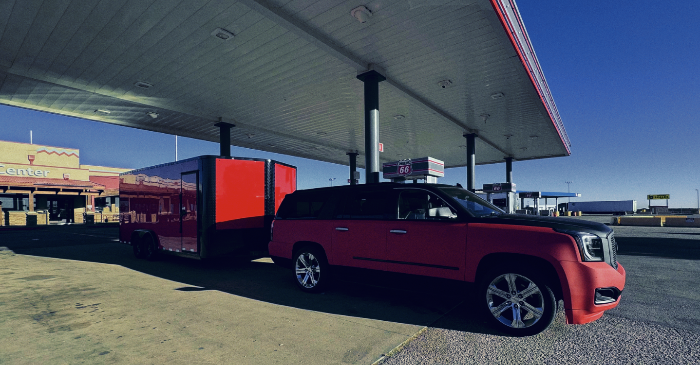

Family run: FL-CT-FL, wrapped.
One hiccup in middle-of-nowhere NJ: starter tapped out. Did the roadside trick, lit it, and kept the engine alive all the way to my mother-in-law’s driveway.

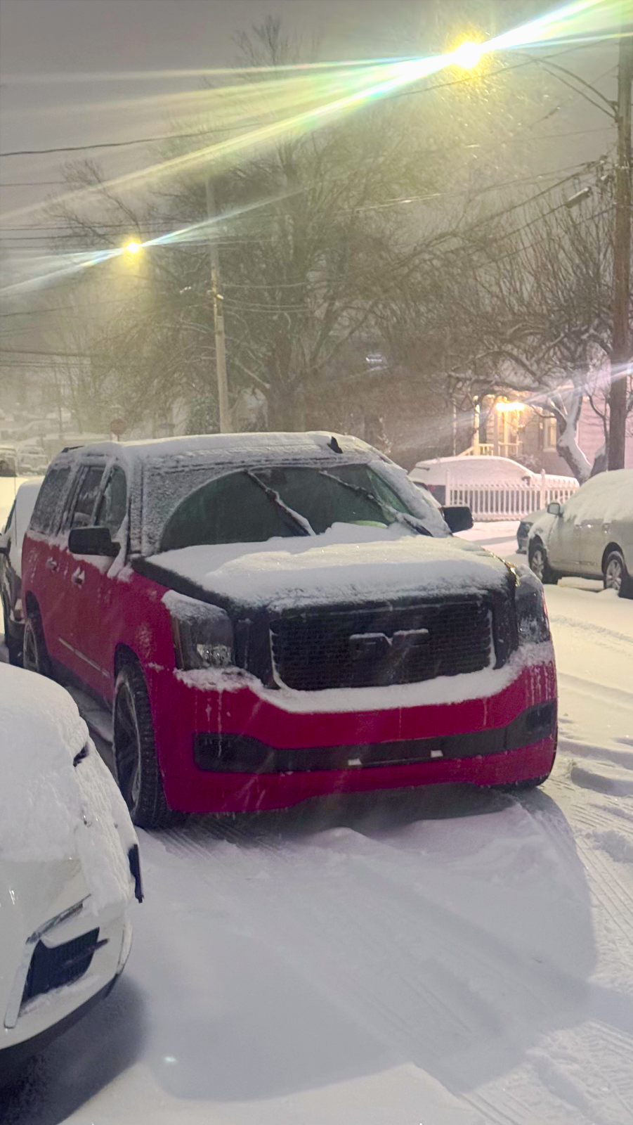

Snow? The 4x4 6.2 treated 50-inch piles like warm butter.
