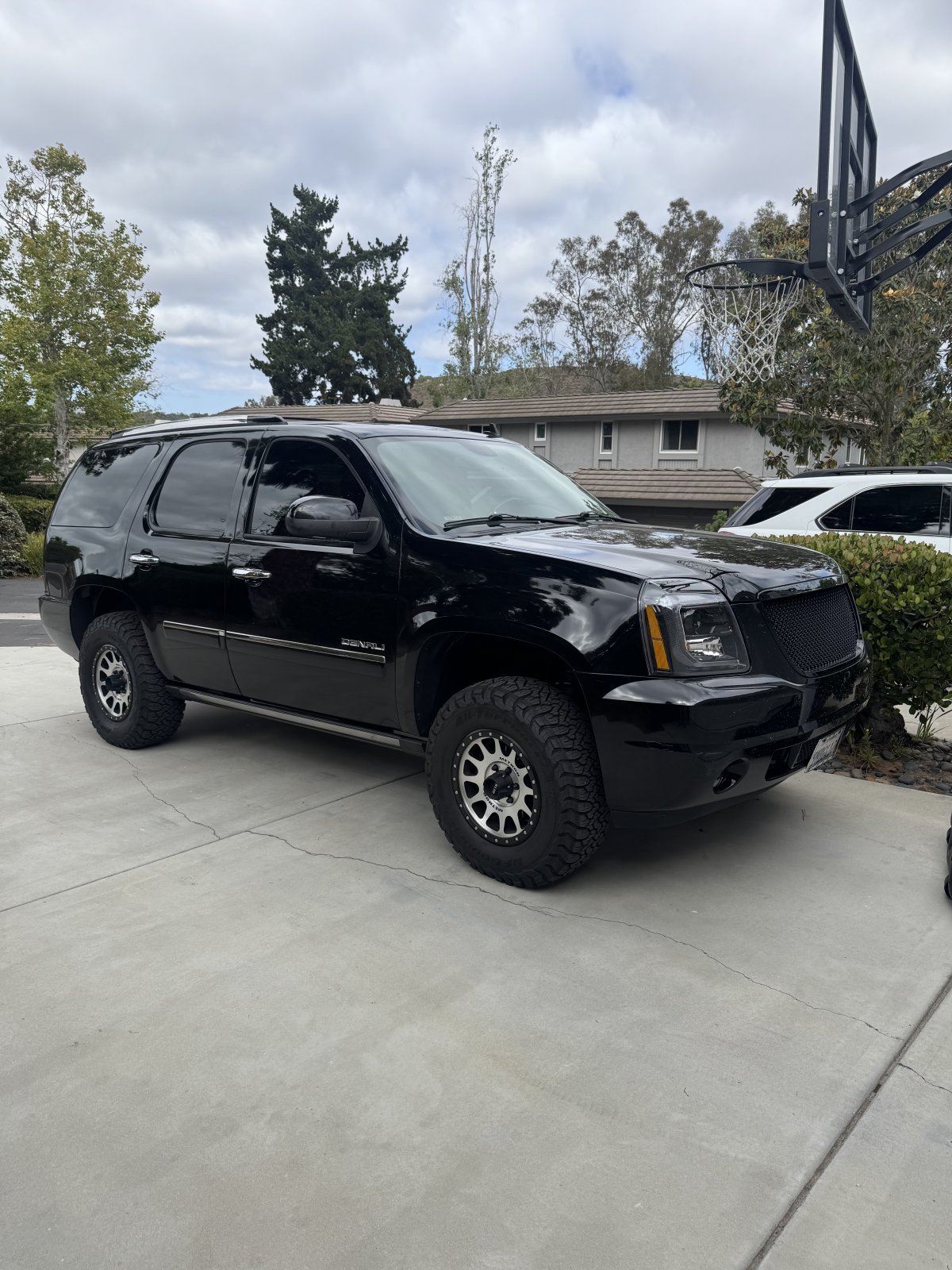

Thanks this is helpful! I’m considering these for my 2010 Denali, which has newish Arnott oem replacement struts, but these feel squishy now that I’ve gotten bigger tires (285x70x17)

DO you have rubbing or did you need to trim for the 285's? Would it be possible to send a picture?
I did have rubbing with a 1.5” spacer, mostly at or near full clockwise lockout when backing, but it was enough that I raised it up a bit more to 2.75” in the front with bilstein 6112s + Icon upper control arms, and ~.75” in the rear with Daytona HD springs and Bilstein 5162s. I still had some rubbing afterwards, but on the running boards, but I did some basic diy trimming on the plastic and so I’m rub-free now at full lock in both directions. I love the look of the 285 70, but I’m surprised at how big they are for these wheel wells, and they’re not even 33”! Don’t know how people get away with 33”+ and say they don’t have rubbing.
