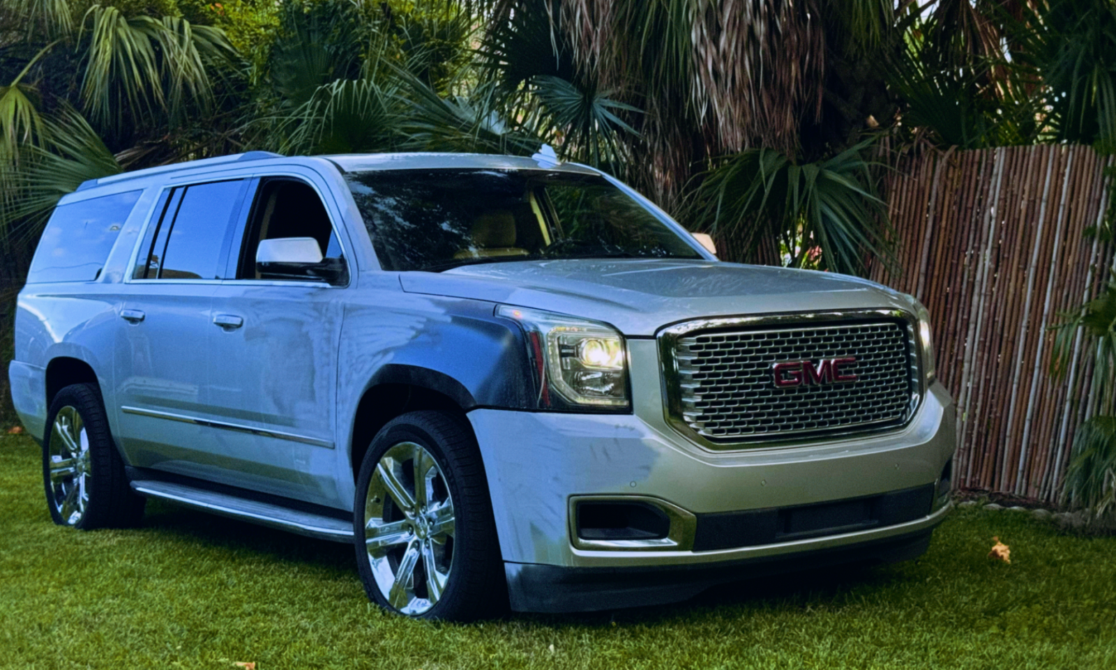

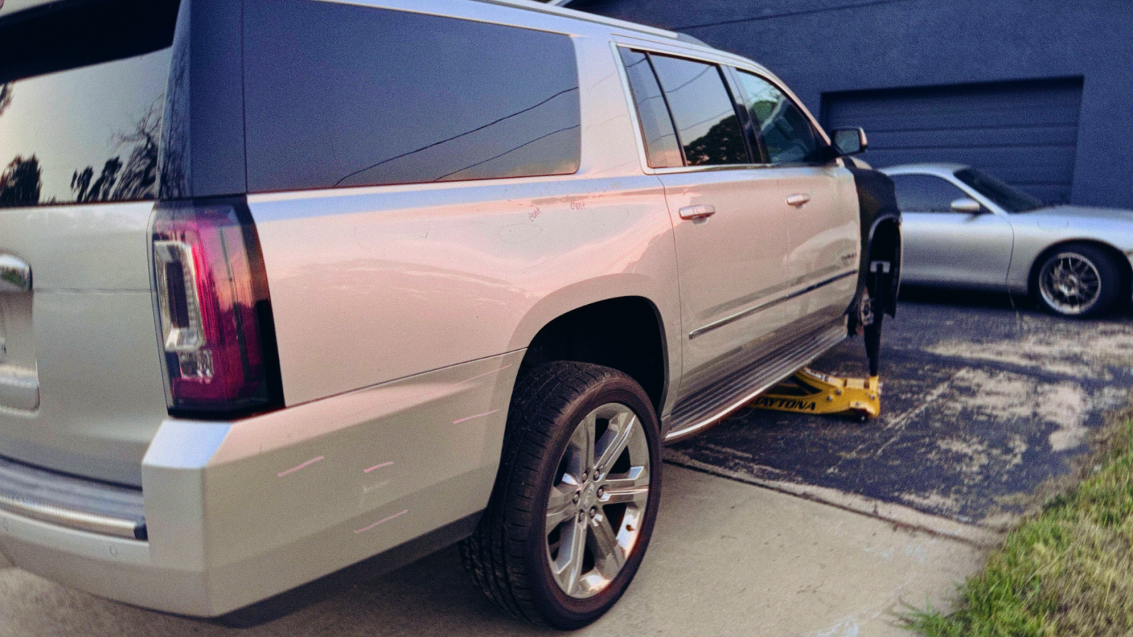

Good news first. Bumper, grille, splitter, both headlights are fine. Right side has light scuffs on the bumper and lens. Looks like the opening jab, not the knockout.
Had a little RPM needle tango. Could have been a nightmare. Swapped the air filter, cleaned the MAF, boom, needle froze in the sweet spot. Engine is whisper quiet. Quieter than my old 5.3, which always had opinions.
Bad news, served last.
1. Rear axle is shifted about one inch to the driver side. Plan is an adjustable panhard bar, same fix I used on the Tahoe.

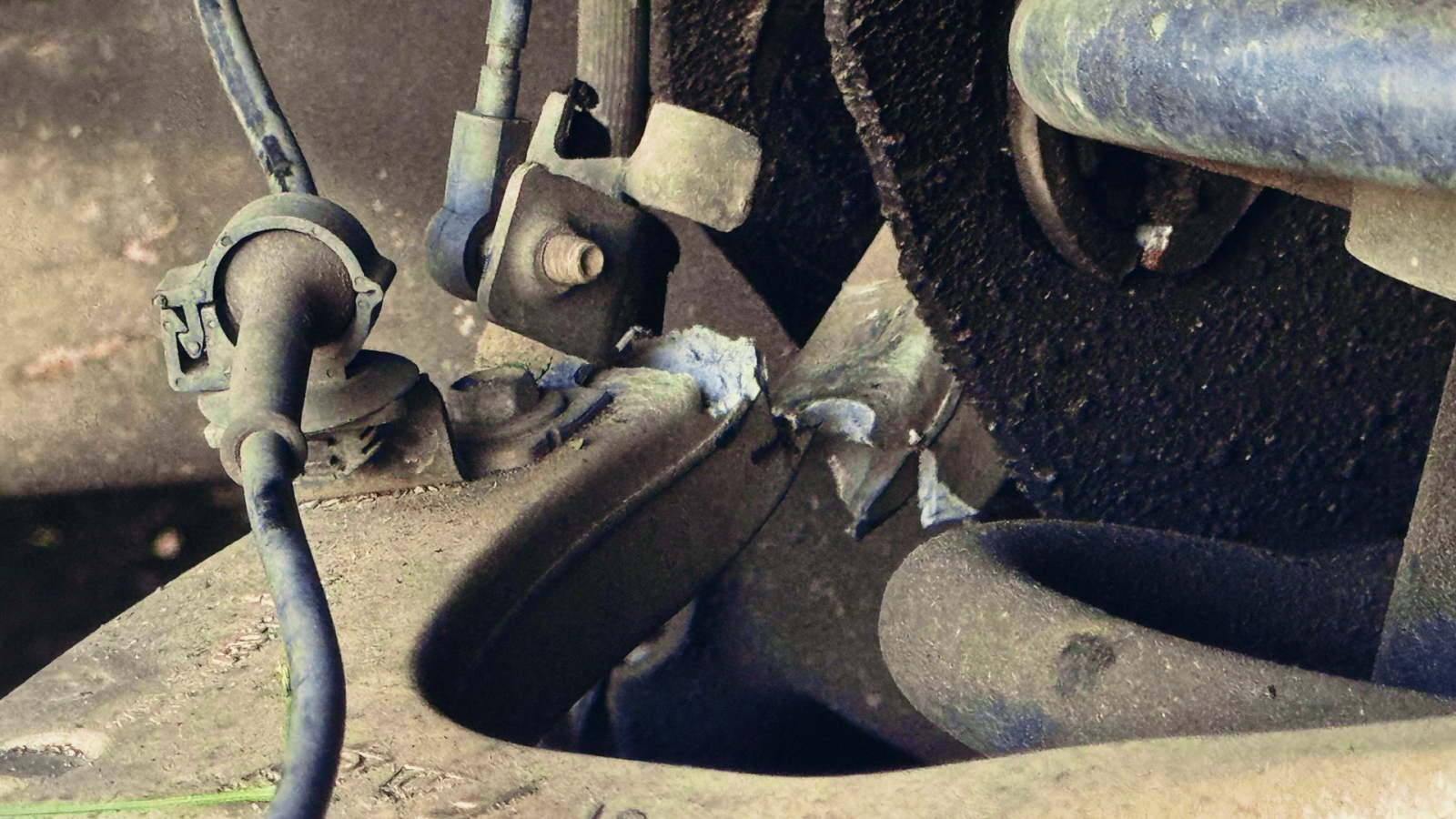

2. Front suspension, passenger side, not happy. Likely a torn control arm from a clean evasive hit. Wheel tips in a turn and ticks like a metronome made of regret. I will get under it and see what else joined the party.
3. Wheel locks. No clue where the key is. Maybe it is hiding in the truck (update:nope, time to look elsewhere). Maybe AutoZone has a kit. If not, scavenger hunt.
4. Door shell is nudged just enough to fight the fender. Either buy a new door or massage this one with a hammer and a puller kit. We will see who taps out first.

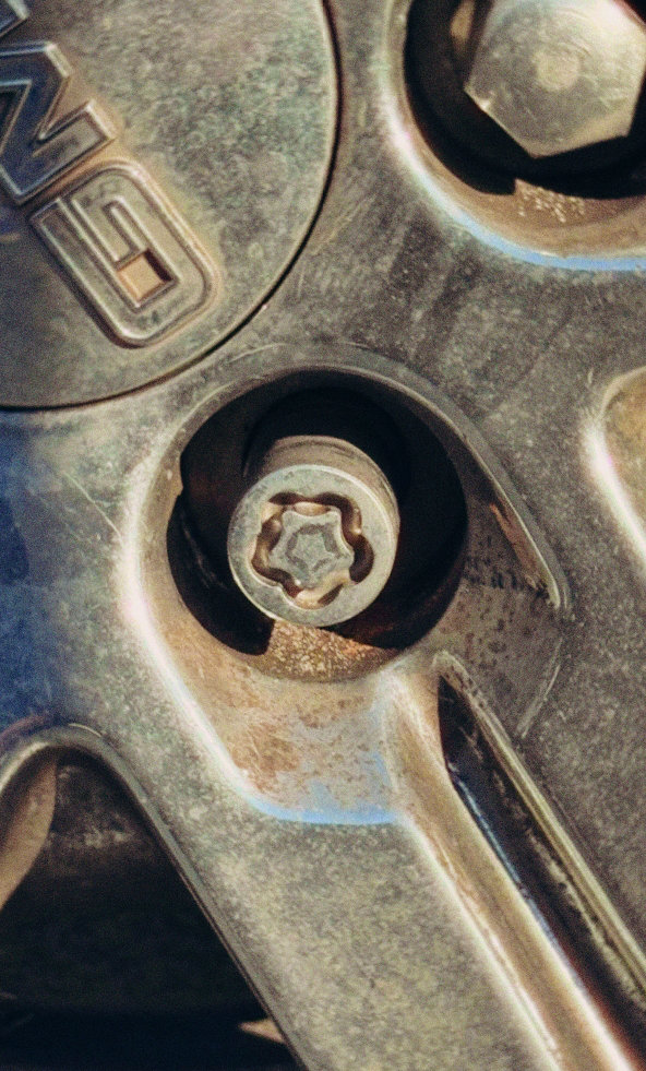

Wheel lock quest
AutoZone. Advance Auto Parts. Even the Amazon lookalikes. Sixty bucks later and every “matching” key was almost right. A removal kit? eBay wanted a hundred. Harbor Freight whispered thirty four. Bought it. It almost fit, which is code for get the heavy hammer. Two thumps, one heroic grunt, and the lug spun off like it was hand tight. Bless the lug nuts I did not torque myself.

The hit was diagonal. Picture a post on the right and a curb below. Tangential smack twisted the wheel and yanked it back. Geometry lived, but the upper control arm cracked. Chain stores wanted 250 to 300. I went with my usual Detroit Muscle special for 46. Ordered. Now we wait.

Five of six lugs are home. The wheel lock saga is over, so the new locks I bought get to earn their keep. Sixty bucks not wasted. Wheel on. Looks right.

With any luck, that aluminum control arm snapped before any frame tweaking happened. I'd be real surprised if that wheel isn't bent tho. Looking forward to the next installment.

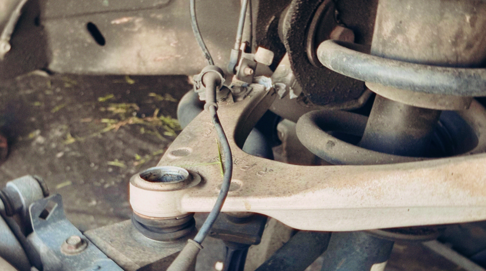

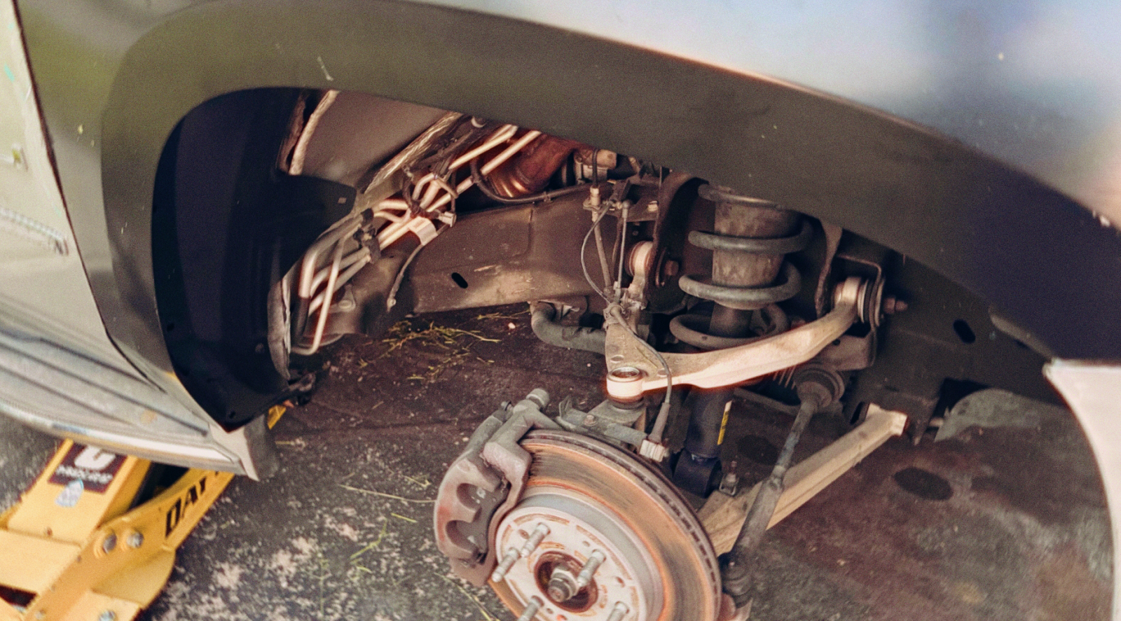

Upper control arm arrived and was ready for Front corner rehab. The old one was snapped and the left side mount was bent. Frame is fine, but the bracket needed persuasion. The 10T press was short, so I stacked steel blocks and pushed it back. Rear tab moved easy. Inner tab fought.
Not perfect, close enough for phase one. Alignment pins are on the way.
Without alignment the rear of the fender kisses the tire on turns. Who knows what it this, right? Some of that bend happened when the wheel was nearly horizontal. Alignment first, then judgement.
Light clunk on stops, starts, and bumps (listen the video). Might be the upper arm torque. Might be a loose fastener. I will recheck every bolt. Maybe some drama. The engine is in a great mood. Quick pull tonight and it moves with intent.

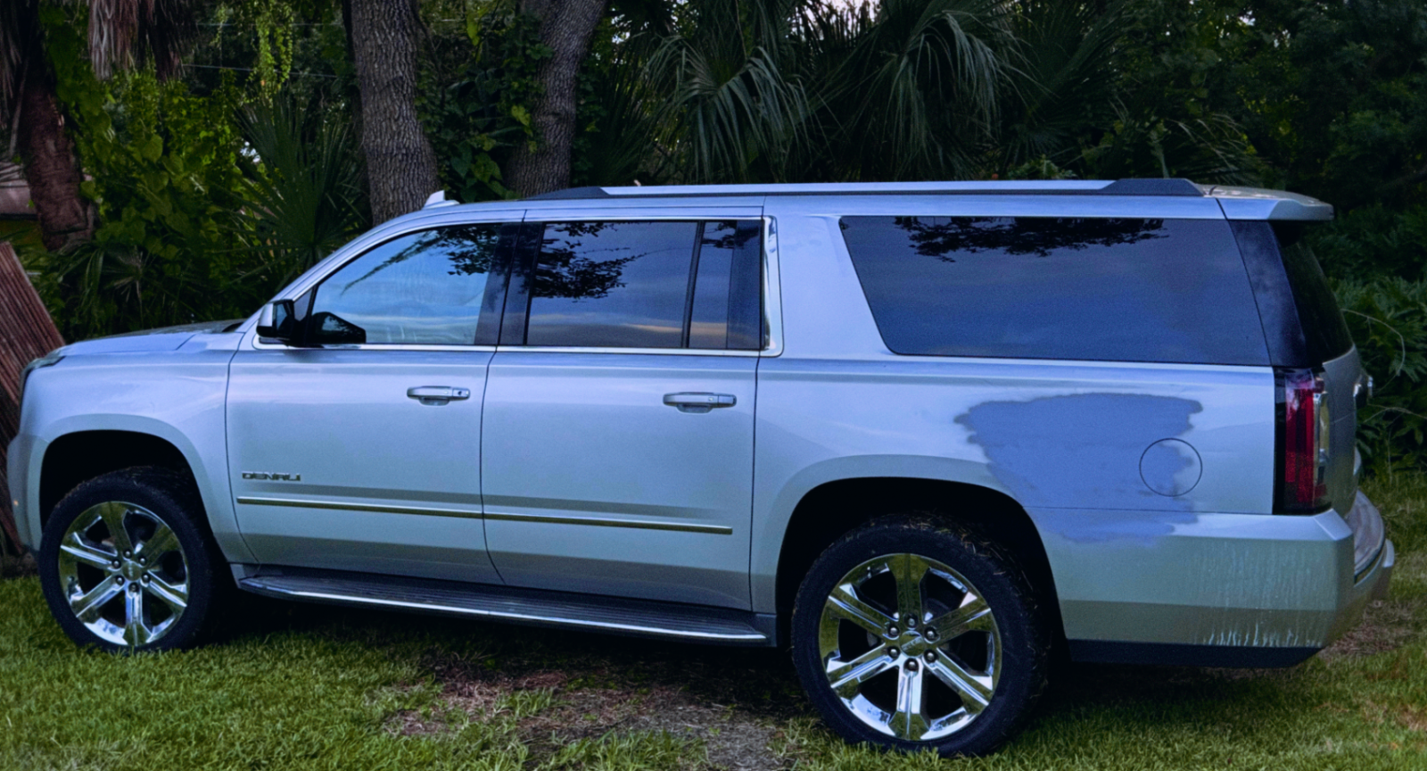

More Bondo. More sanding. Lines are waking up. Tomorrow I finish the pass and hit a quick seal coat over filler and primer.
That door crease gets fixed and set arrow straight. Vinyl hates primer, so this becomes the base if I wrap later.

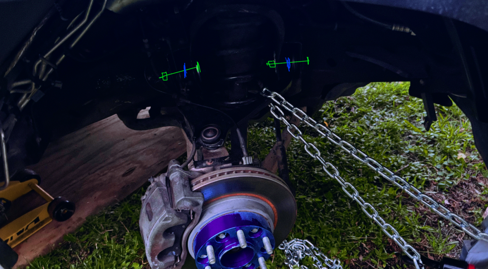

I parked the Yukon in the backyard. It is the only place with trees left, and right now trees are tools.
Plan B recap. I tried to cheat it with eccentrics.
A little better, not enough. The front passenger wheel still sits about half an inch closer to the cabin than the driver side and kisses the rear of the fender at lock. Less than before, but still there. The upper control arm mounts were bent and my first straightening pass did not bring them fully home. If Plan A does not fix it, I will grab an upper arm for lowered trucks. Those run a touch longer. That may be the ticket.

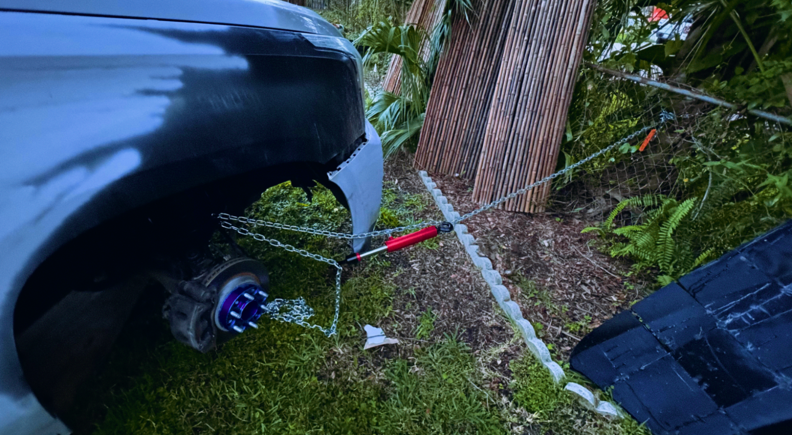

Plan A, with patience. My first idea was to anchor to the giant oak behind the truck. Then I imagined the headline if it went wrong. Tree falls, house loses. Hard pass. I slept on it and set up for control, not chaos.
Found a short, thick palm that can take a gentle pull. Wrapped a chain around it.
I will pull the bumper, set solid stands under the frame, no sketchy jack balancing.
New plan is slow work. Drop the upper arm, spring, and shock. Reinstall the upper arm bolts with the metal caster adjusters in place, just snug, not tight.
Hook the chain to the front pivot bolt and do light, measured pulls. Watch the mount walk back into spec. If the front lands true, repeat for the rear.
If the fore-aft position still bugs me, I will add a sideways pull toward me once the front-to-rear is fixed.
Rush is a bad advisor. I would rather spend two days easing metal back than one hour making a new problem and a date with the junkyard welder.

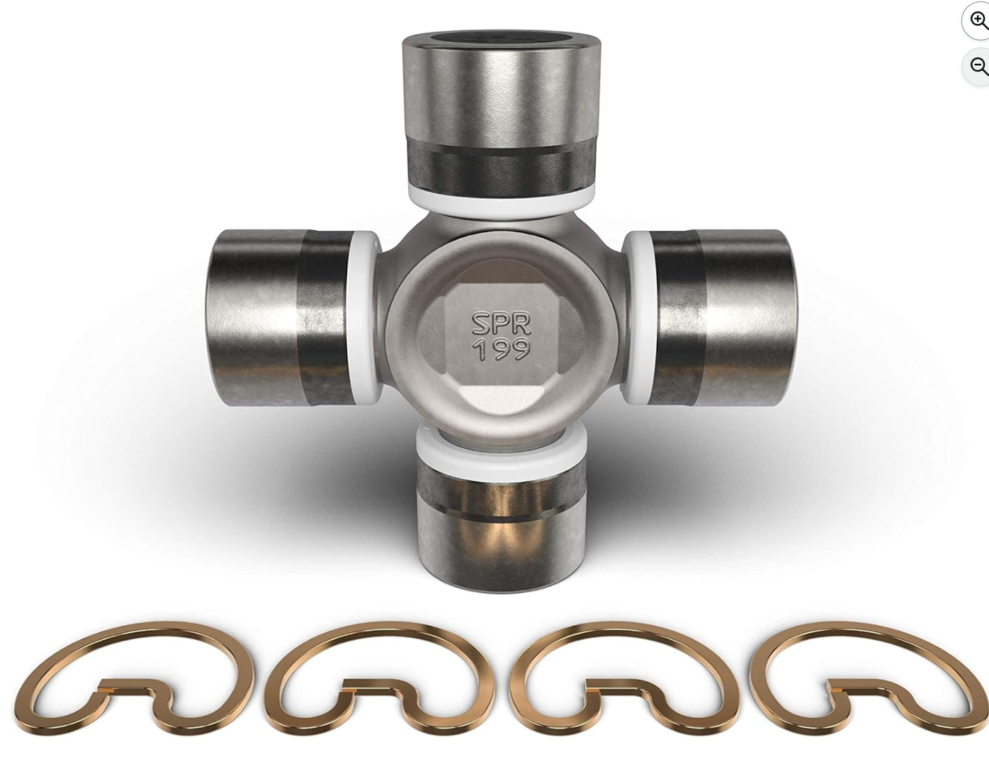

While I am there. I plan to upgrade the U joints to Spicer 5-1350X or similar. Cheap insurance, clean conscience.

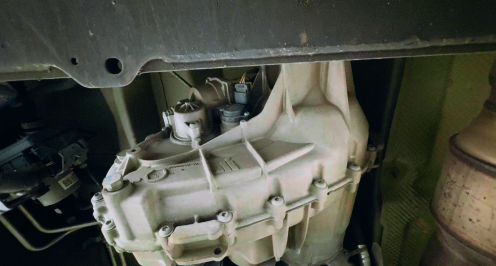

Tomorrow plan
Backyard, palm tree, measured pulls. Two coffees, three chains, five millimeters at a time.
Aren't the stock rear universal joints in those 1415 series?
AAM - 19256729
Dana Spicer - 88964413
The front joints are still 1344s like the previous generation, 23104840.
AAM are great and can last the life of the vehicle, I've had new ones on the shelf for mine for years and just passed 217K miles.
As you know, solid joints are better than greaseable ones.

Actively sanding. Low spots getting knocked flat. Paint this weekend so the wrap has something to bite.
Why paint the whole truck before a wrap? White or silver underlayers are wrap horror. Every chip, every edge, every tiny peel screams hello. So I shoot the body in the final colors first. When life throws a rock, the scar blends. No white halo. No silver blink. Color on color, quiet and clean.
Quick color tests. Goal is more flow by cleaning the lines. Fewer verticals. Keep some up front to add visual weight.
Scanned the truck with iPhone LiDAR. Dropped the mesh in Blender. Texture painted on the real scan instead of guessing on photos. Blocked space for a splitter. I will design and 3D print it.
Two color layout. Black on the roof and along the lower body. Fog lights deleted. Fins and brake ducts go there and that whole band stays black. I was going to keep the hood and bumper body color but it broke the flow. So the grille goes black and I follow the inner bumper line in black to keep the ribbon continuous. Molding is gone. I am adding a subtle lower character line to carry the motion and wrap it into the rear cover.

Sanded yesterday. And today. And probably in my sleep. I will check if the sealer is still alive tomorrow. I have almost a gallon. If it passes the sniff test, it goes on first. If not, straight to paint over 600 grit. Prep is done. Gun is ready.
Phase 1 spray. I have some jet black and clear left from old projects, so while the new paint ships I am splitting the job: roof and hood now, the rest later. Painting the whole truck in one sitting is cardio with a respirator. Roof first, hood next, then we breathe and live to spray another day.
Sticking with the bi color plan. I will paint the OEM splitter now and design a new one to 3D print after SEMA.
After SEMA. Yukon gets wrapped to match the trailer, and the trailer gets wrapped with color and ads on both sides. Rolling billboard, rolling booth.
Back to blue tape religion. Paint first, plates second, vinyl later.
