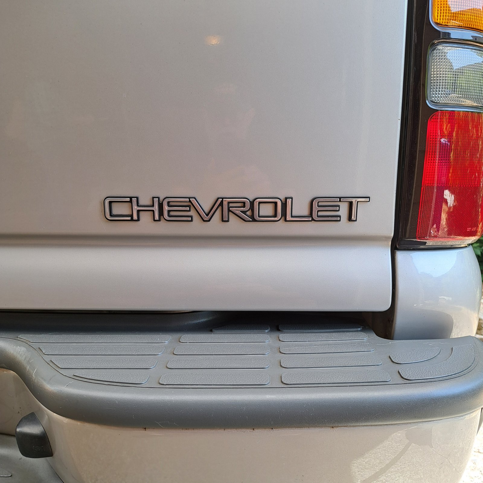

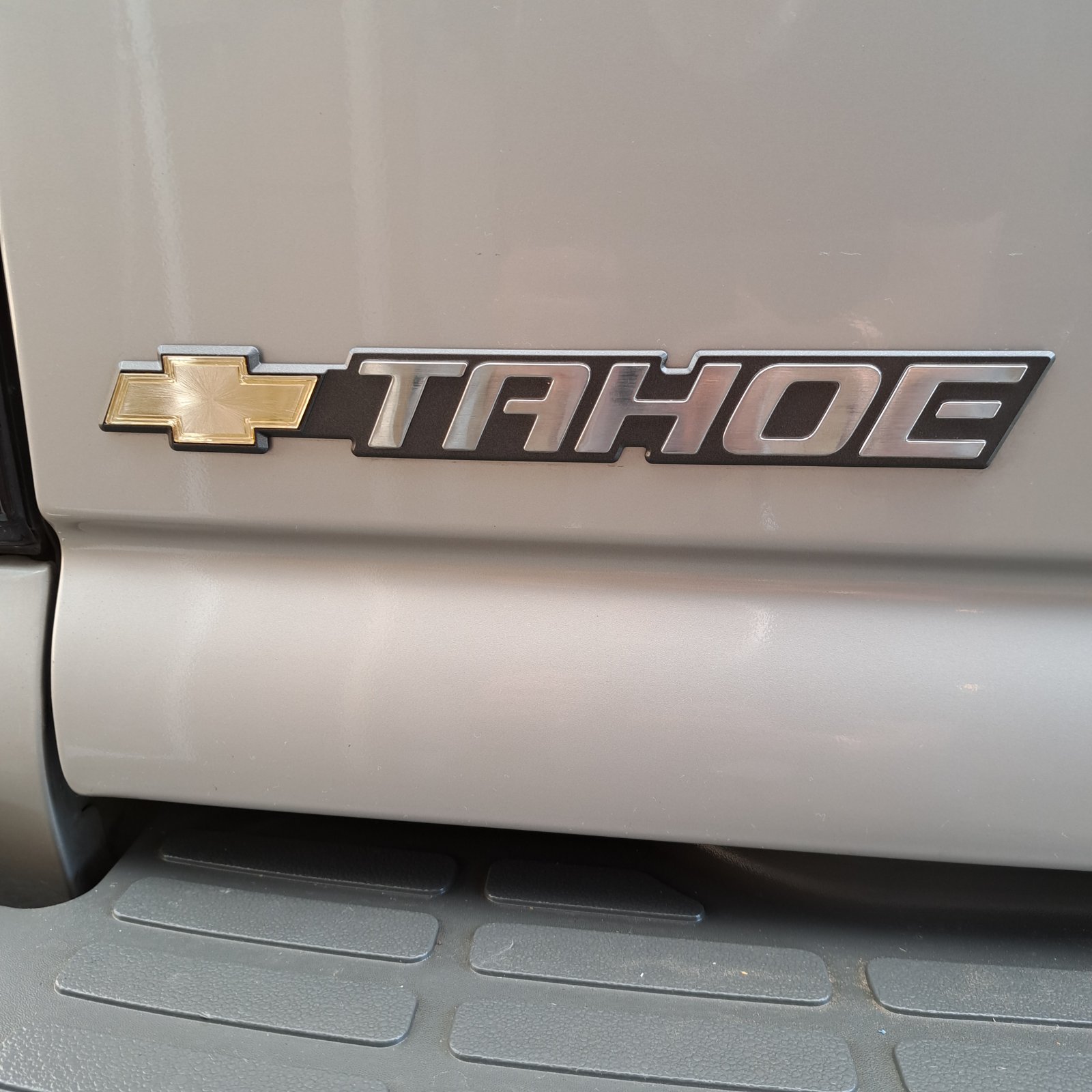

If you have followed this thread, you have seen when I retired in 2022 and was in Paradise, Ca. for a while and while there I got a brain fart and had my rear BOWTIE/TAHOE emblem and the CHEVROLET emblem, blacked out and then added white around the edges to make them stand out. After a while, the white was flaking off and then looked like crap. Been bugging me and so I ordered in new GM emblems and removed the old, cleaned and installed stock look emblems again. I was so in to the removal, that I forgot to take a "before" pic of the BOWTIE/TAHOE emblem, but you get the idea and can go back in this thread if you really want to see it. I like it much better now:
Me thinks that you have a lot of spare time on your hands. :cool:
