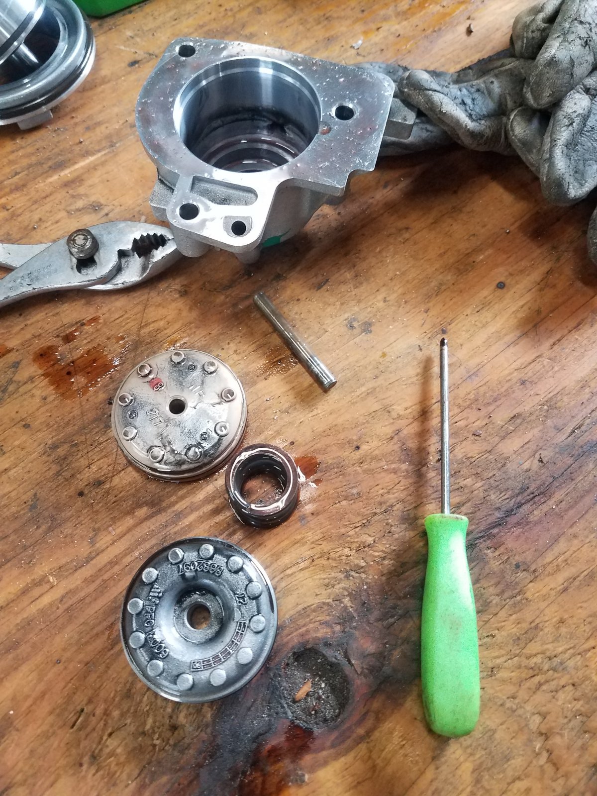

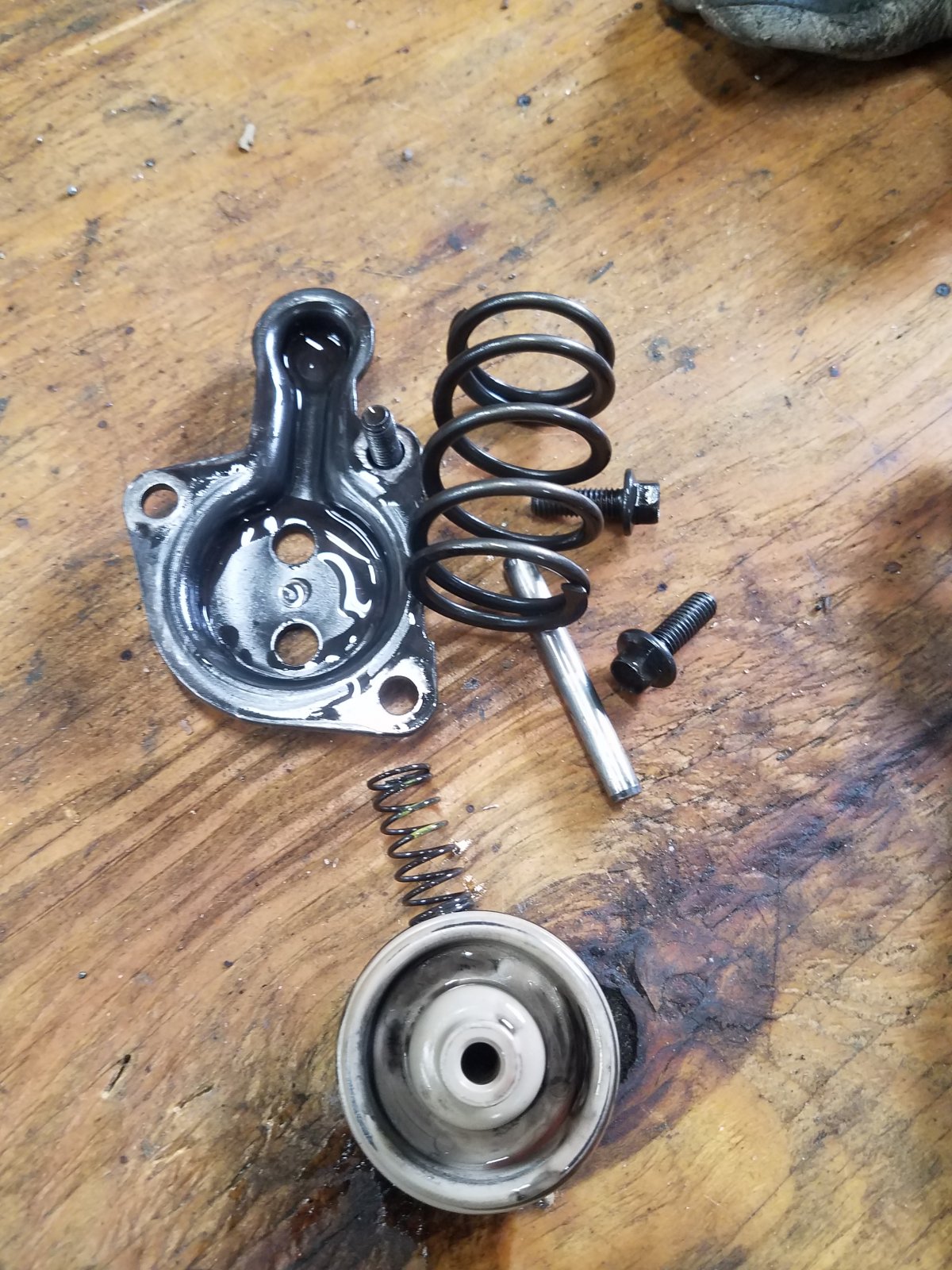

Wish I would have purchased that one.....wanting to go back in and shim my new 1-2 accumulator. Replaced it with the aluminum one that has a longer shank but I'd like to shim to bottom put even quicker. You think I could reuse my cork gasket that hasn't been on that long?

I wouldn't try to reuse one, why do you want to reshim the accumulator?
A really cool YT channel I watch - Precision Transmissions - this guy knows his stuff with trans, lots of videos on tearing down 4l60e trans. Unfortunately they hardly do build videos but he goes over a lot of the updates they do and issues when he tears them down.....anyway he always updates the 1-2 accumulator to the longer shank piston, shims them up flush and also puts a 3/8 spacer so the bottom out quicker. Brings the band on quicker, speeds up the shift without making it harsh.

No you can’t reuse a cork one. They only squish once lol.

Gasket, I just use the rubber type (like $4 upgrade with your rebuild kit). I hate cork gaskets.

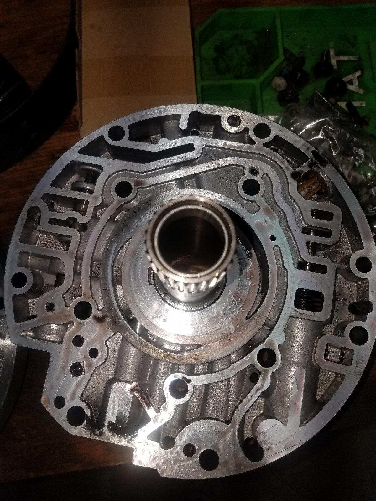

Hey, @iamdub here's some pics of the pump, it has the connector on it so I believe it's the one you need.

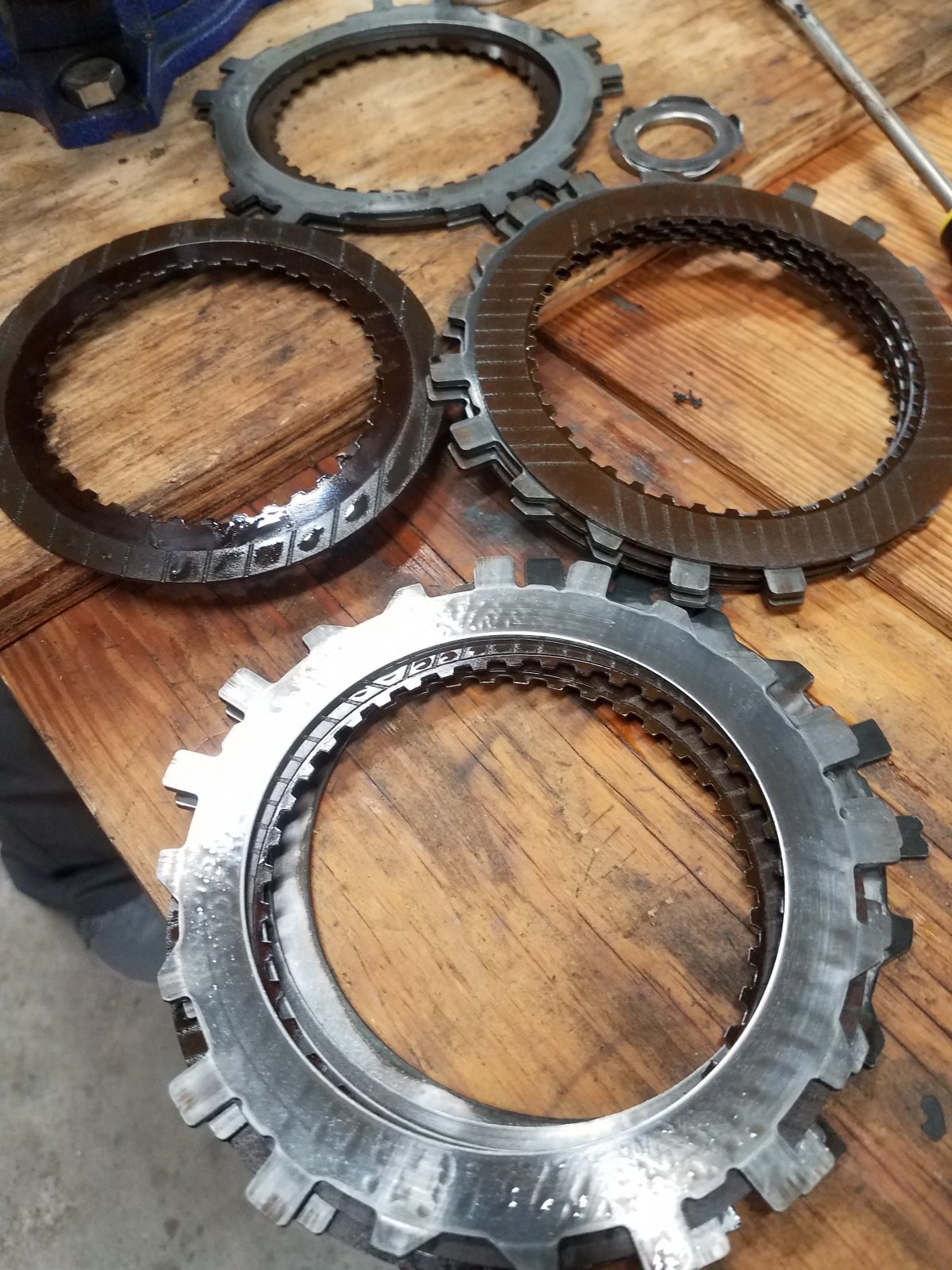

Got the clutch packs apart and dug about as deep as I think I need to for this basic refresh. I can tell the frictions and steels got hot and a few of the frictions are warped a tad, still have a few things to inspect before I make my part list, @pwtr02ss is keeping me in line.

Tyler's the tranny boi here, so he'd know for sure if it is. My guess is it is cuz I doubt they'd have multiple types. I'll PM you.

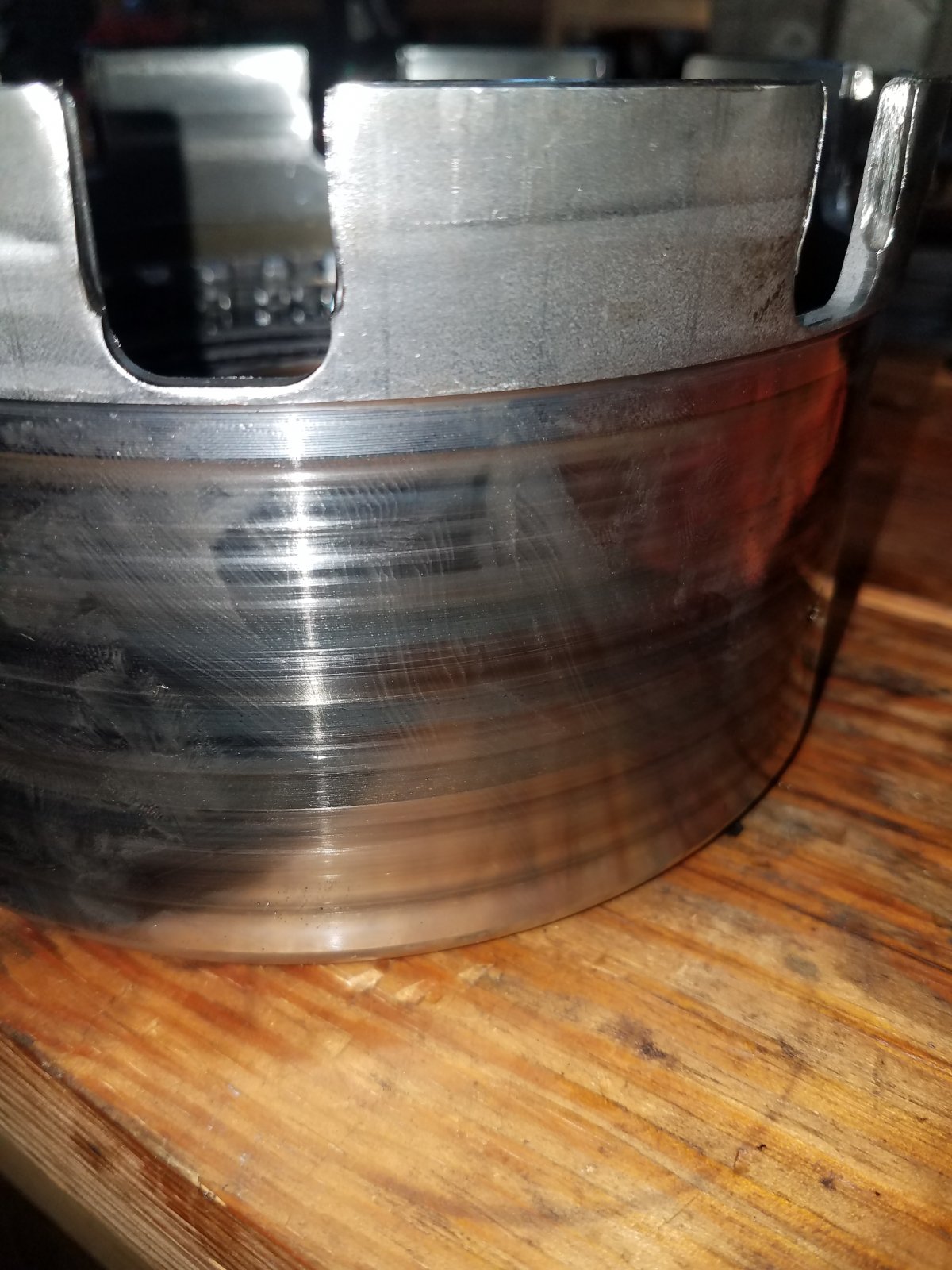

You two will also need to exchange some "shaft" photos...both, pull the rotor and veins out of the pump and check for excessive wear. Light scratches are to be expected. Also, need to trade harnesses.
I have done absolutely zero research on this. The harness and pump are the only things I noticed when we did mine.
We are taking your word as gospel oh great one. Shaft pics inbound tomorrow morning when I get back down there. :Jedi:

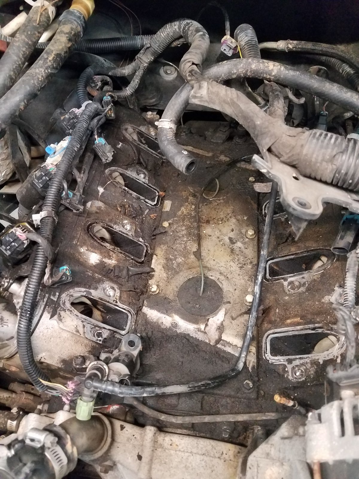

Got back on this project yesterday and should be starting the trans build tonight, hoping to get it done before I go on Vacation Saturday. Basically just cleaned shop, organized the new trans parts, got the truck jacked and ready for old trans extraction, and got the intake pulled for knock sensor replacement.

Don't forget to lightly scotch bright the surfaces the sprag bearings, piston seals and pump rotor/veins run on. Helps reduce friction by allowing trans fluid to build on the surface. That "precisions transmissions" guy I have watched a hundred videos on harps on this a lot. "Scotch bright is your friend", literally says it in every video. Good luck and post some pics!
