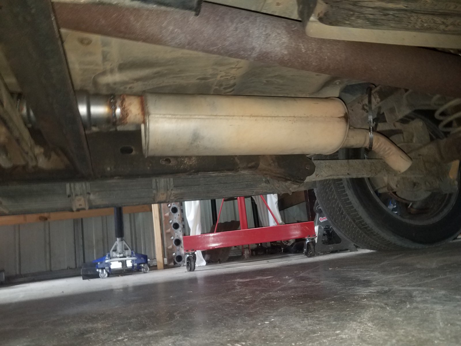

Super pumped on the exhaust it seriously sounds stock quiet!

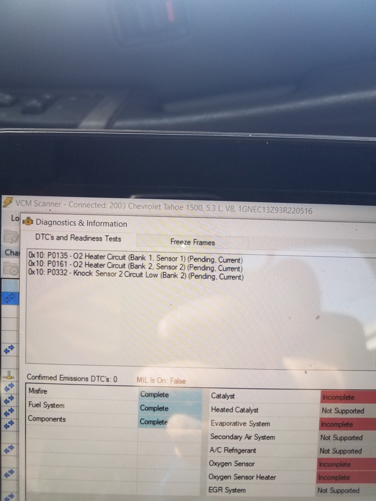

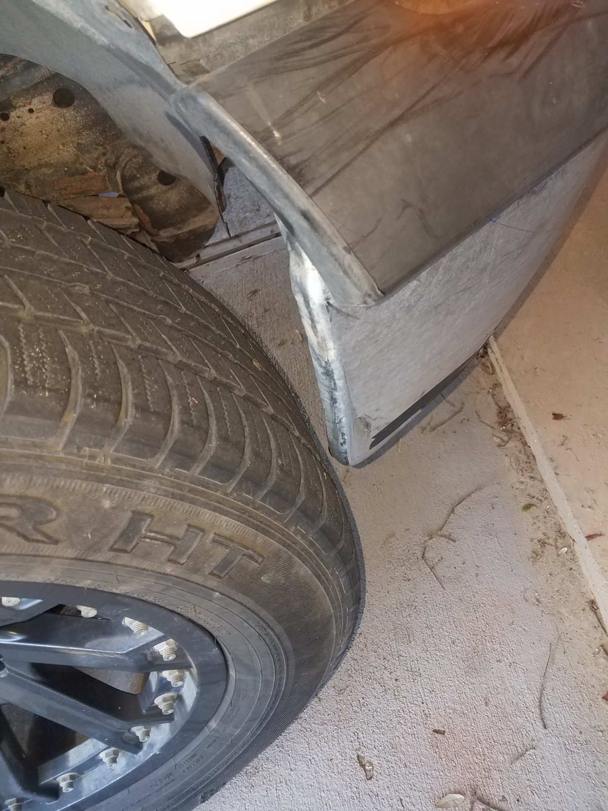

Also did some bumper modifications and hooked up HP tuners. Four d out some idiot put a 10amp fuse in the 15amp OBD2 slot so the port wasnt working. Fixed that and heres the codes.
Topped the trans fluid off and it didnt help, I command 3rd and it revs, command 4th and it feels like it goes right into 3rd 3,200rpm at 50mph. Also did a little burnout in 1st.

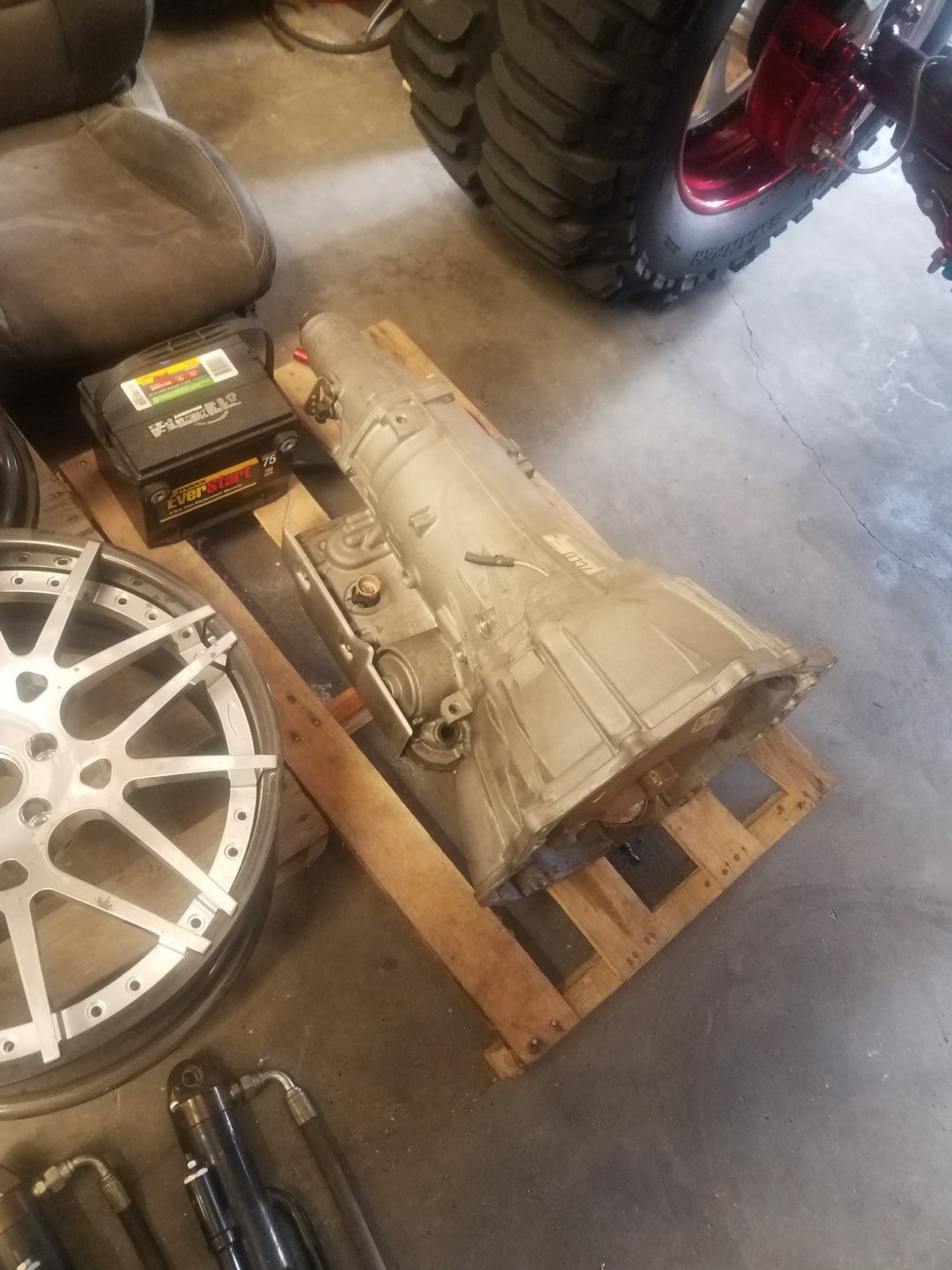

New diagnosis time. Picked up a 4l60 that my buddy had in his 07 Avalanche, it died of old age and he had it rebuilt with "A bunch of good parts" to go along with his super mild 5.3. A few months after the rebuild it suddenly wouldn't do anything. he thought it was the solenoids so he bought all new ones and it didn't help so he yanked it and 4l80 swapped. When he dropped the pan to do the solenoids the fluid was grey and smelled bad so he threw it in the corner and its sat for 2 years. I just bought it for $100 planning to pull it apart, fix what needs fixing and slam it in this turd to minimize the time it will take up my shop. Also, this thing is so dang clean it's quite impressive.
While I was there he pointed to a pile of 2wd 4l80s that need "rebuilds" and told me to hurry up and get trans building down so I can start pumping them out for him lol.
Awesome! You may have lucked up and you and @iamdub can do some trading....
Remember, the 05 or 06 up transmissions have the speed sensor built into the pump. Your 03 does not so you will need the older style pump. Just so happens, Chris needs a newer style pump and harness and has the older style pump and harness:hmm: You may want to double check me on that being the only differences though. I haven't noticed anything else...
So, first things first. Just stopped working could be a million things, lol. You'll need to get that t50 plus socket and get it apart. If its not doing "anything", it could have a broken input shaft. They will usually do something
See, I told you. Once you do one, you'll do another :deal:
Ahhh I totally forgot you said that about the pumps, HEY! @iamdub whats poppin you need a new style pump doohickey?
Also I have a T50+ Inbound now!

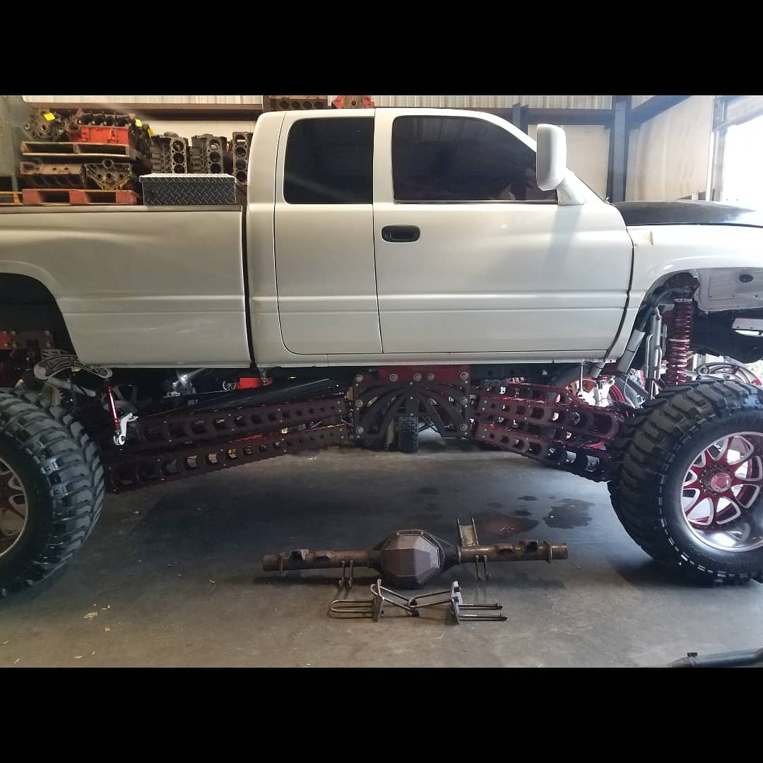

Okay what is that red wheel hooked up to? :)

I do! IIRC, pump and harness should be all I need. I might need the output shaft- something about splines for the OSS. But, I can't guarantee my "classic" '07 pump is any good if you're wanting it in trade. @pwtr02ss, can I tell by looking at it if it's any good?
The trans was bought as a core to be fully rebuilt. I bought it for $100- wanna trade the whole trans? I don't know when I'll be back down your way, though. We'd like to make a summer trip back to Tampa.
A big ole 12vve Cummins Brodozer owned by my powder coat buddy.
This is the only pic I have of it.
Dont really want to trade straight up because this trans was built with "A bunch of good parts" and knowing him he spent a pretty penny on the parts and then paid a degenerate to build it and they probably messed up on the install. So I'm hoping to salvage a bunch of parts.
I'd be down to trade whatever parts tho, obviously I wouldn't be able to use pump anyway in this Tahoe if I'm understanding @pwtr02ss correctly. Btw it is out of an 07 NNBS ltz 2wd avalanche. I'll have it home and likely broken down Friday.

you will have to disassemble the pump to see if it's any good. Inspect bushings and wear from the rotor surfaces. Minor scratches are fine. Just not big enough to catch your fingernail on. @Dantheman1540 if you're going for the full tear down...
CTA Tools 6500 Automatic Transmission Clutch Spring Compressor https://www.amazon.com/dp/B00JHKZGOO/ref=cm_sw_r_cp_apip_KMdI5kLVwQ3Wc
That looks like something kinky, ordered and on the way :D.
Yeah I might as well do a full tear down. The only thing I'm not sure about for this turd is what torque converter he wants to go with or if he just wants to flush and cross his finger.
Good deal. You won't realize how nice that ****** is. We started with some ******** $20 one from eBay...
You'll need to acquire a few more things but that will get you apart. I'm assuming you have duck bill pliers and snap ring pliers.
Those "cyclone" brand converters on eBay are like $150 or something. We had always bought from dacco in the past because they were local. Casey ordered the cyclone to test it out...its the same damn converter we had been getting for years. Dacco was bought out by transtar a few years ago and I guess they distribute the cyclone in a "transtar" box.

Good deal. You'll need to acquire a few more things but that will get you apart. I'm assuming you have duck bill pliers and snap ring pliers.
I also ordered a lip seal tool, some tack lube, and a 4l60 rebuild book just because I still like physical copies of stuff.
I will let him know about the converter for sure.
