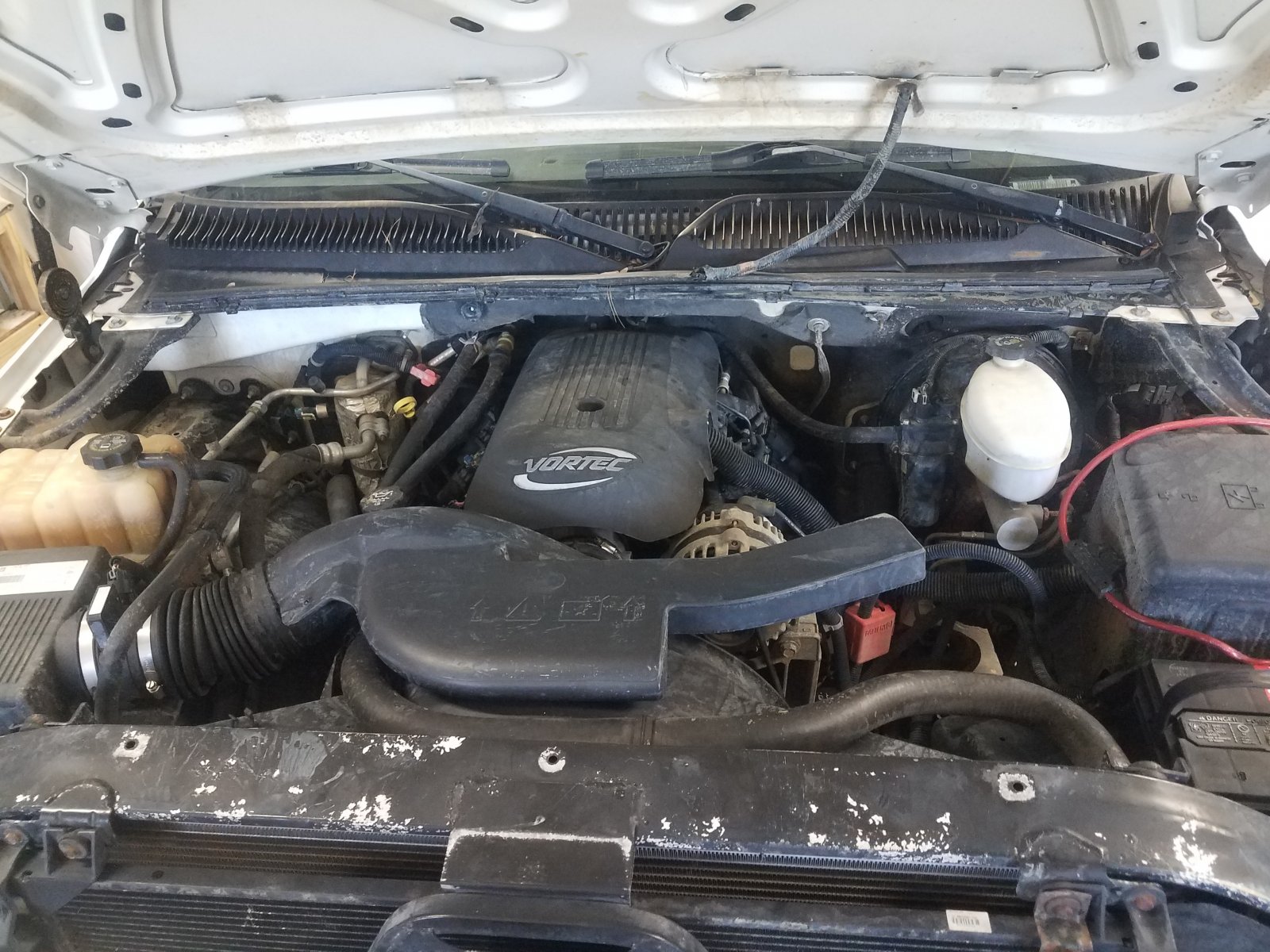

First thing was change the oil since the dark told me too and the filter looked old. Oil looked good but the filter showed signs of age and had some minor sludge in the bottom of it. All in all I think the 5.3 is fairly healthy for its age.

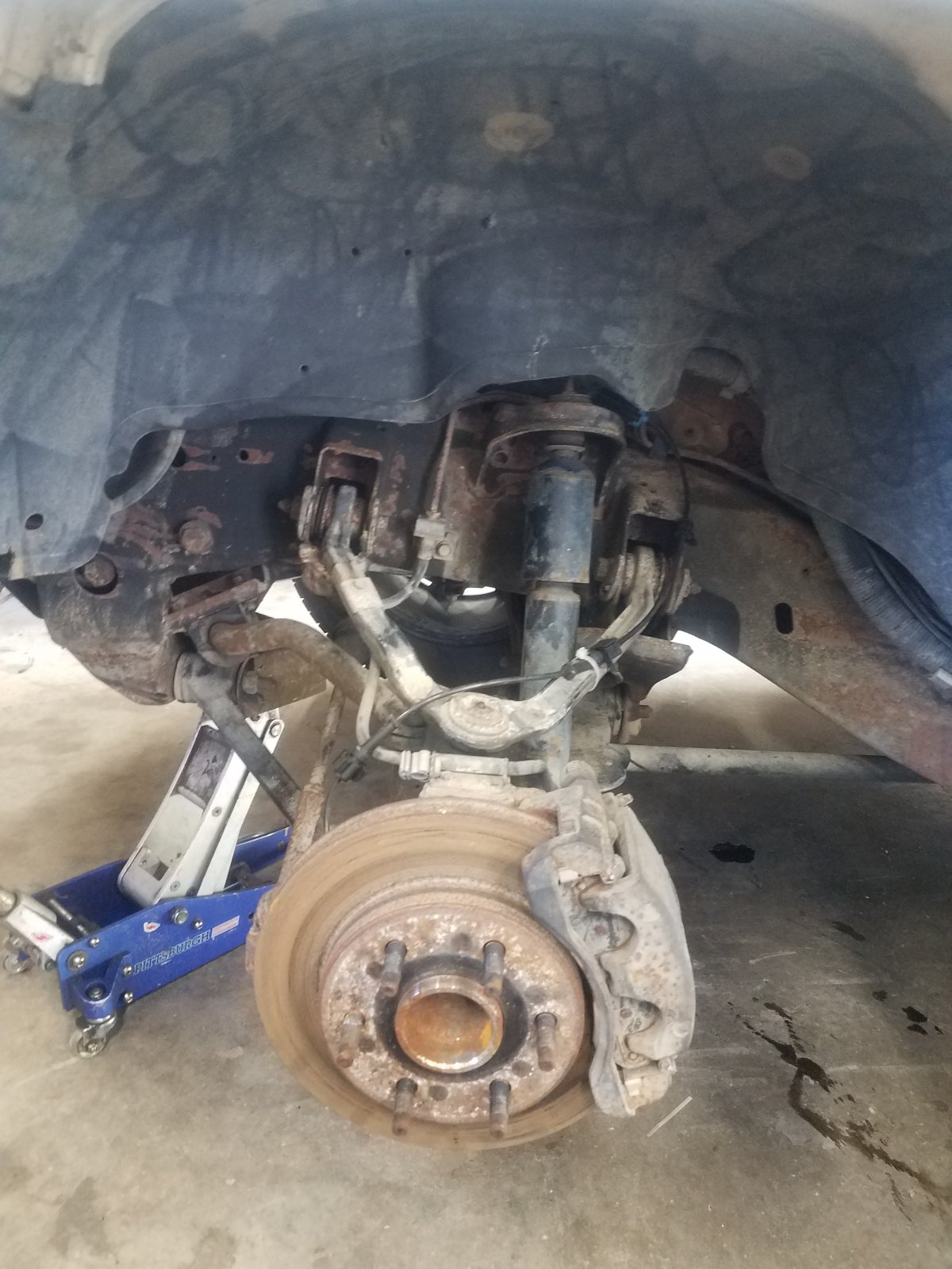

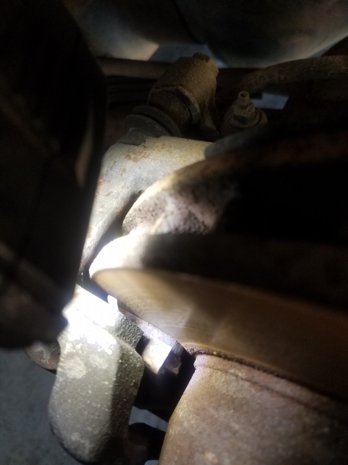

Second thing was checking brakes and basic suspension. Brakes aren't new but have plenty of life left and suspension looks fairly good besides some steering slop. Wheel bearings feel good and look like they may have been replaced judging by the wheel speed sensor wires flopping around.

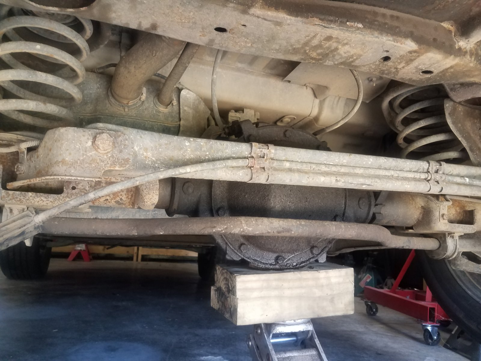

Rear axle needs a reseal and I need to check the rpo codes I couldn't get the rear to lock by hand spring the tires but, it might have been a lack of wheel speed.

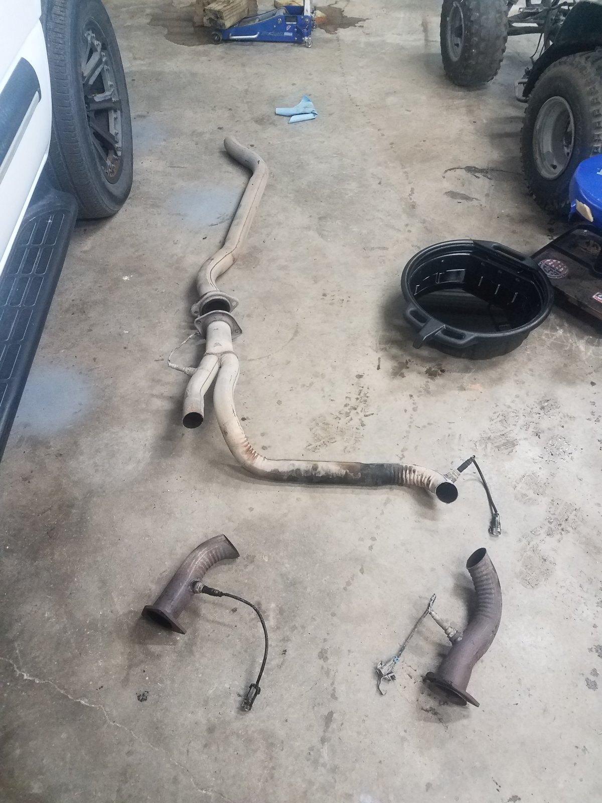

Facebook marketplace is terrible had a lead on the y pipe loaded up tools because I'd have to pull it and now the guy ghosts me.
Got a lead from another guy but the cats have been cut out, no biggy can just weld in a straight pipe. Gonna try that route tomorrow the pieces are free too which is good. It's at a local chop shop usually full of NBS trucks and SUVs maybe I'll spot some more interesting stuff like the burned down turbo Tahoe I saw last time.

Success! Went and pulled the remaining pieces of a y pipe today, the cats were cut out but I think with some spare pieces I can just patch a straight pipe in. Also scored an OEM silverado exhaust for $20 I'm picking up tomorrow. Gonna use some of the pipe to patch the cat holes, then weld in the muffler and do a poor boy turn down before the axle. Full exhaust cost will be about $40 for supplies including welding wire and gas. And some invaluable exhaust skills I've been wanting to practice just not on quality parts I paid for.
Also have 4 O2 sensors now, even tho the down streams with trip as bad I will just tune it out.
