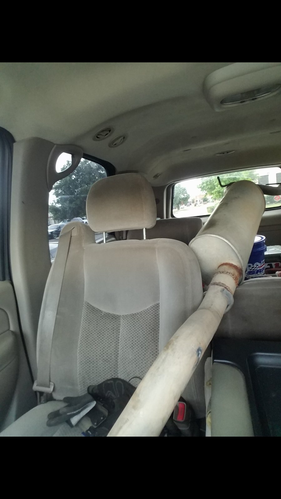

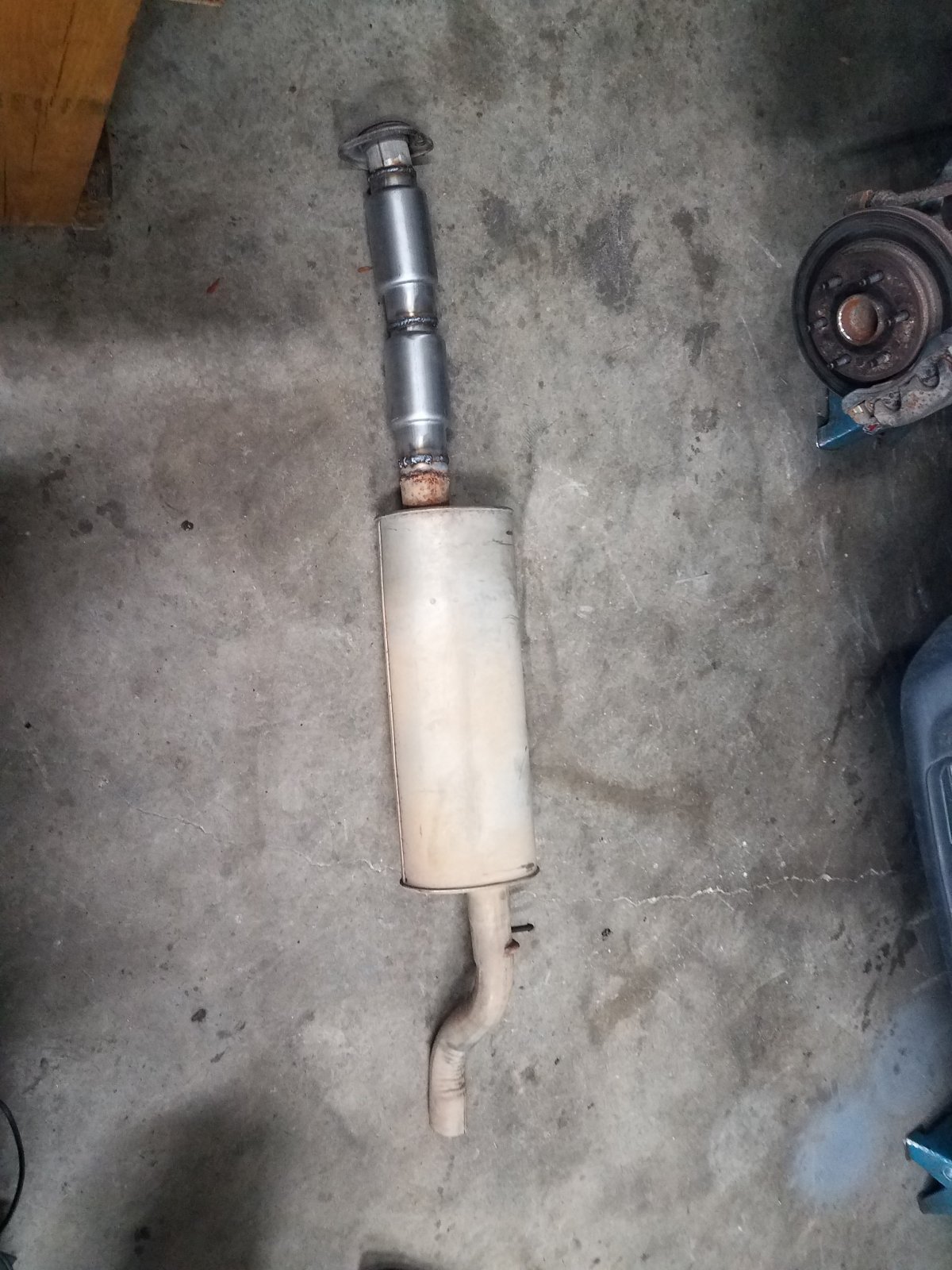

Got the OEM catback from a silverado, should have plenty of pipe to repair the Y and build a decent dump using this muffler.
If anyone was curious an extended cab 6'6" bed silverado cat back fits in a Tahoe by about 2".

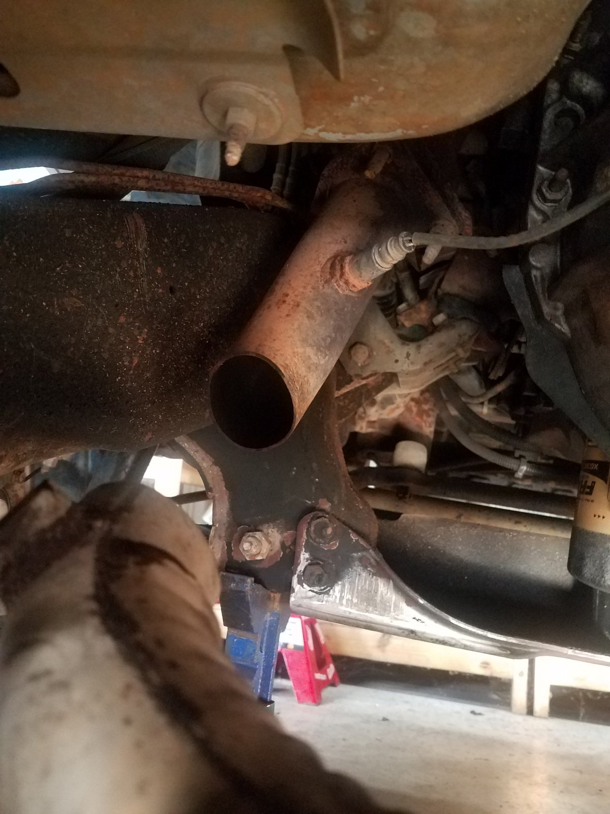

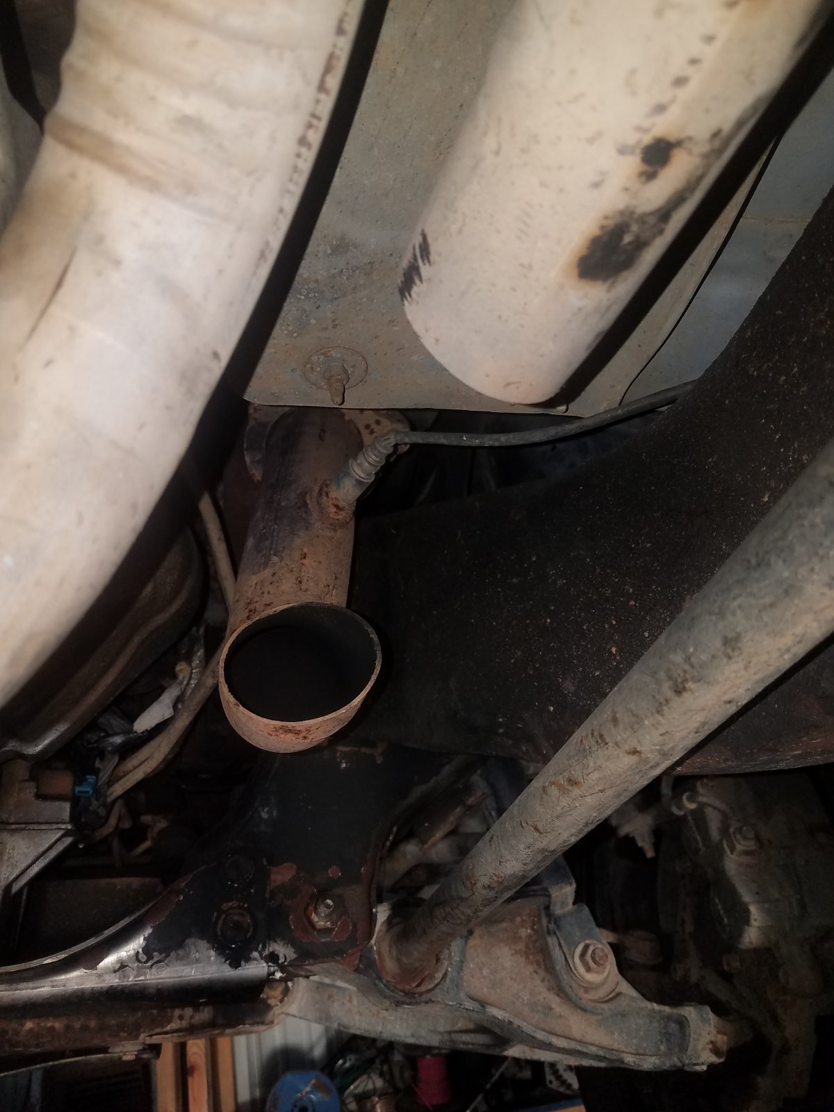

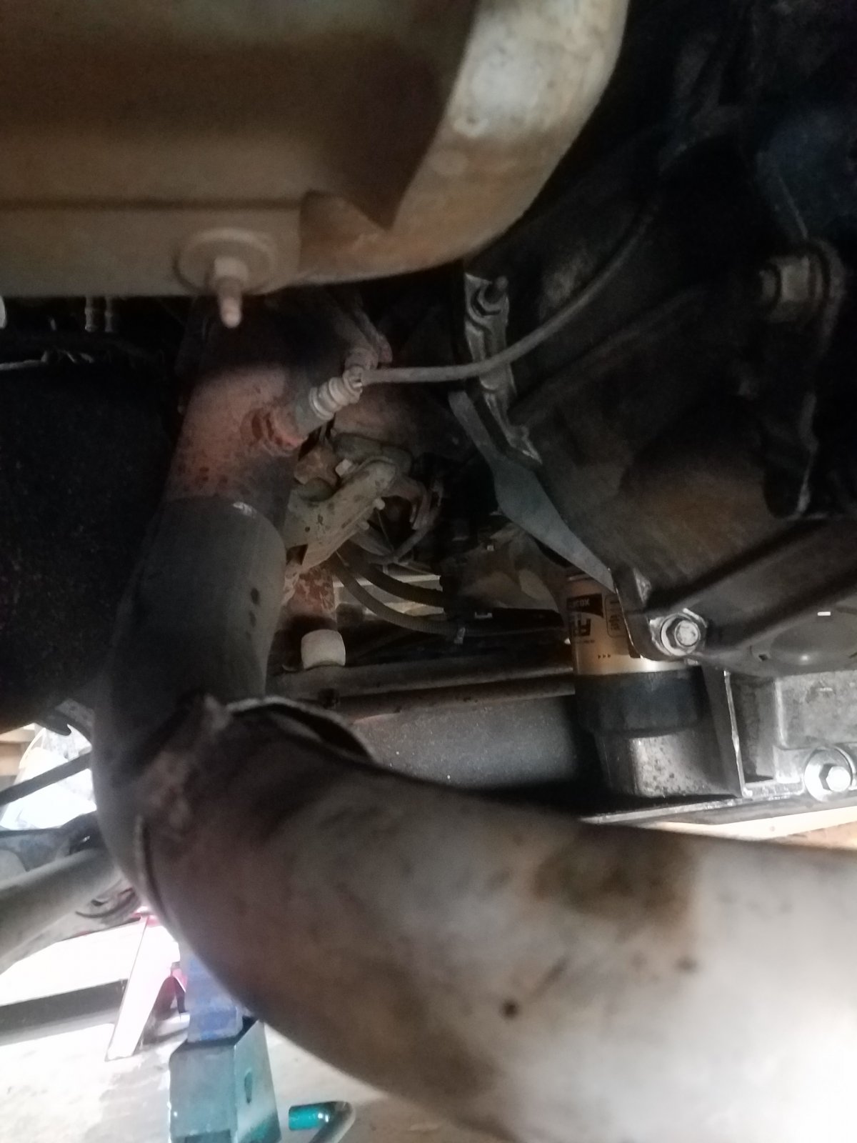

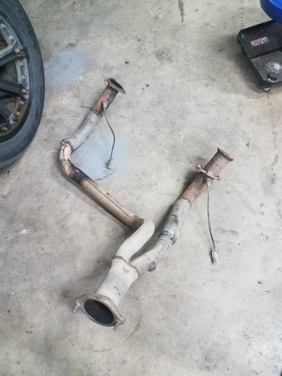

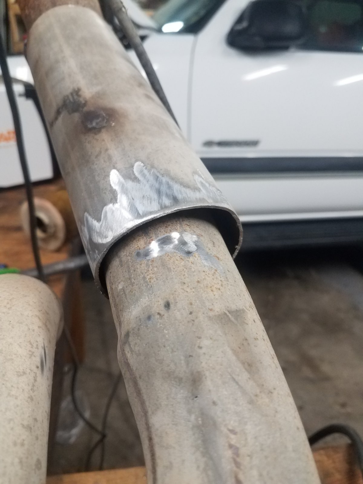

Let me first start by showing the gaps I had to fill from the cat removal and the pieces I cut from the cat back to do so.
Also disclaimer! I know this isn't "the best" way to do this. Much more time, attention to detail and effort could be put forth but this is not the project for that.

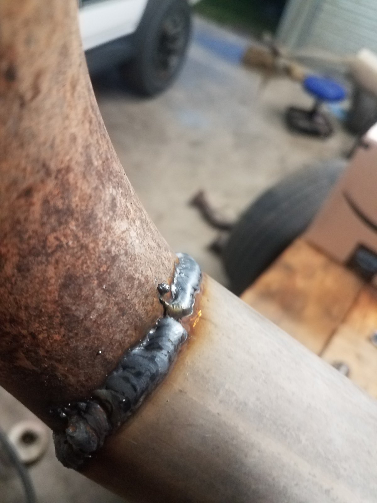

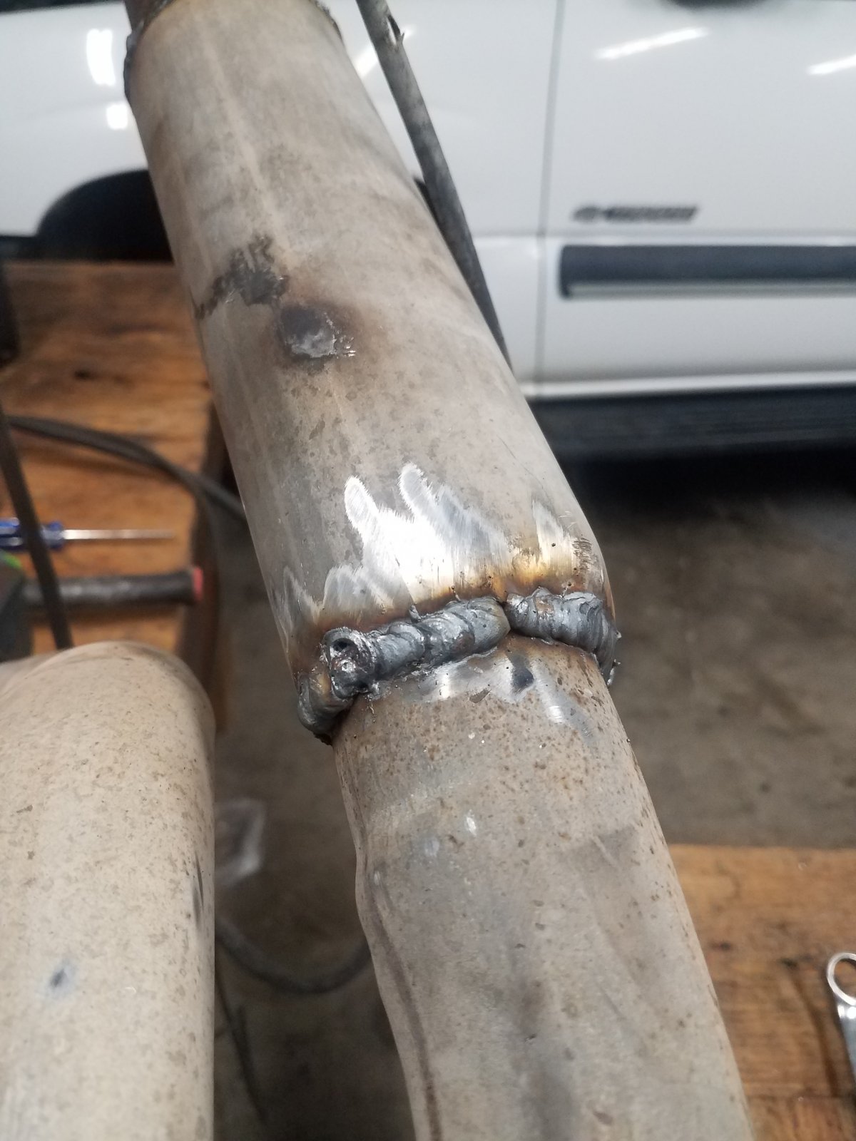

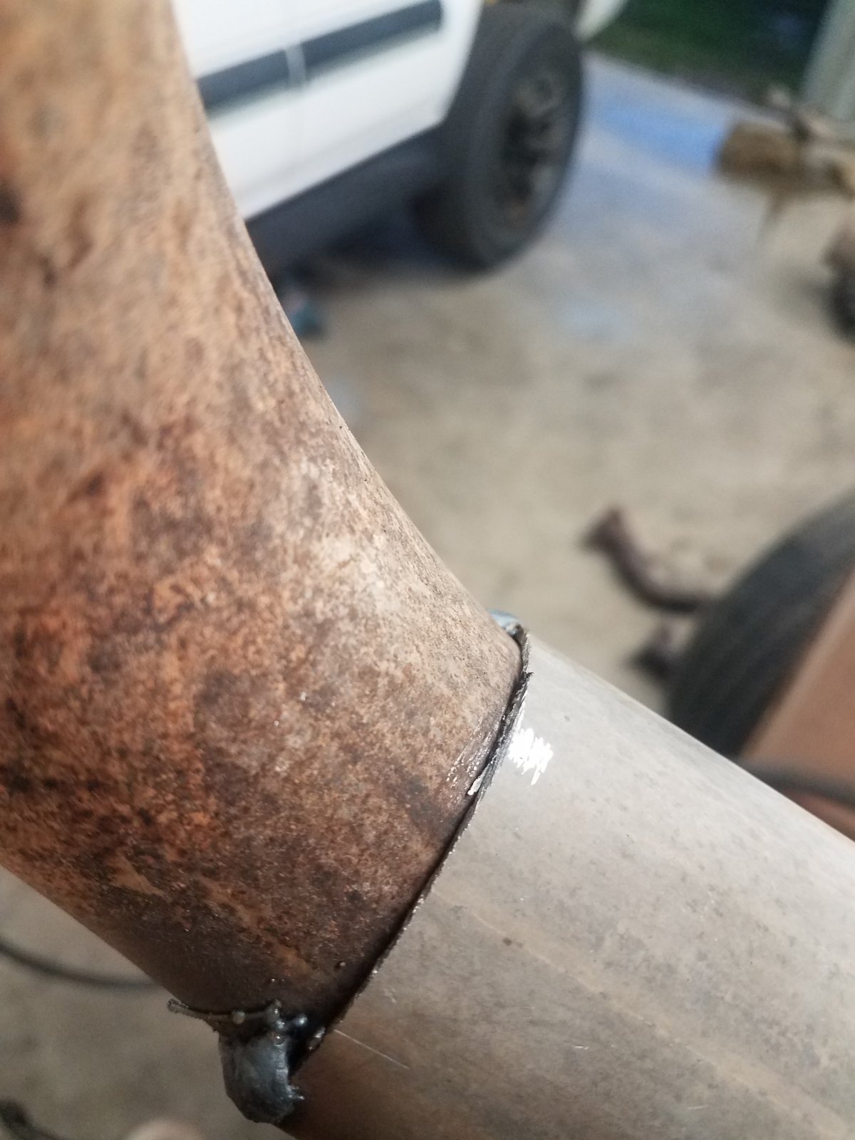

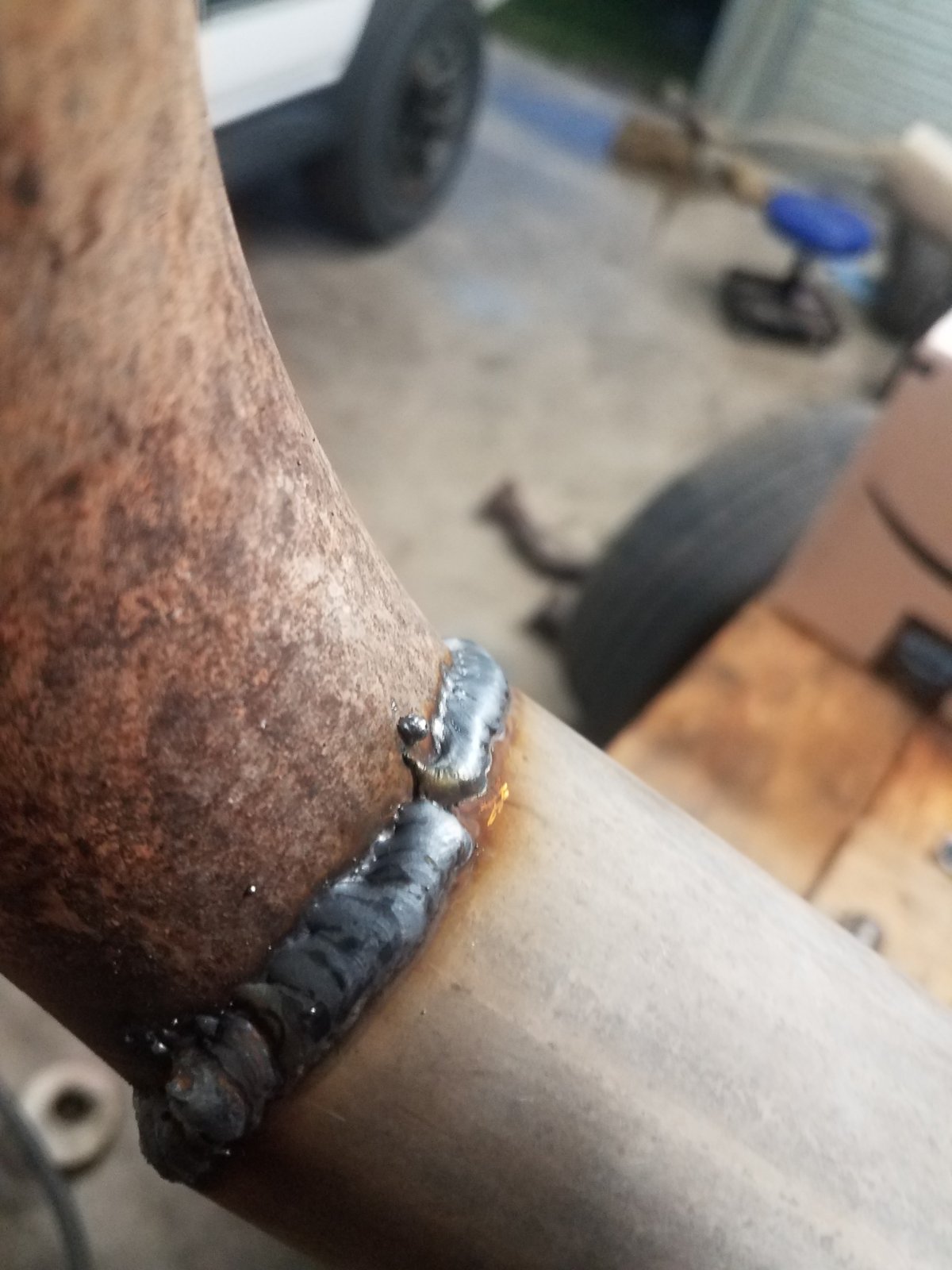

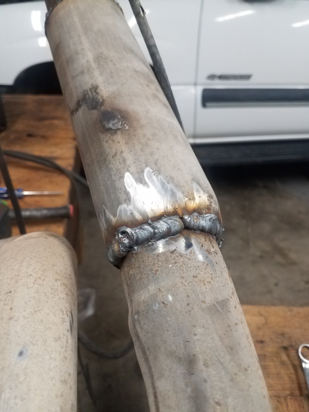

Y pipe re welded in a few spots, muffler pipe done besides a better turn down and hanger. Was able to get some better welds in but still could have lowered the wire speed a tad to make cleaner welds.
It sounds half decent, pretty deep compared to stock but no rasp or crackle, over all very mild even with the leaks due to lack of gaskets anywhere.

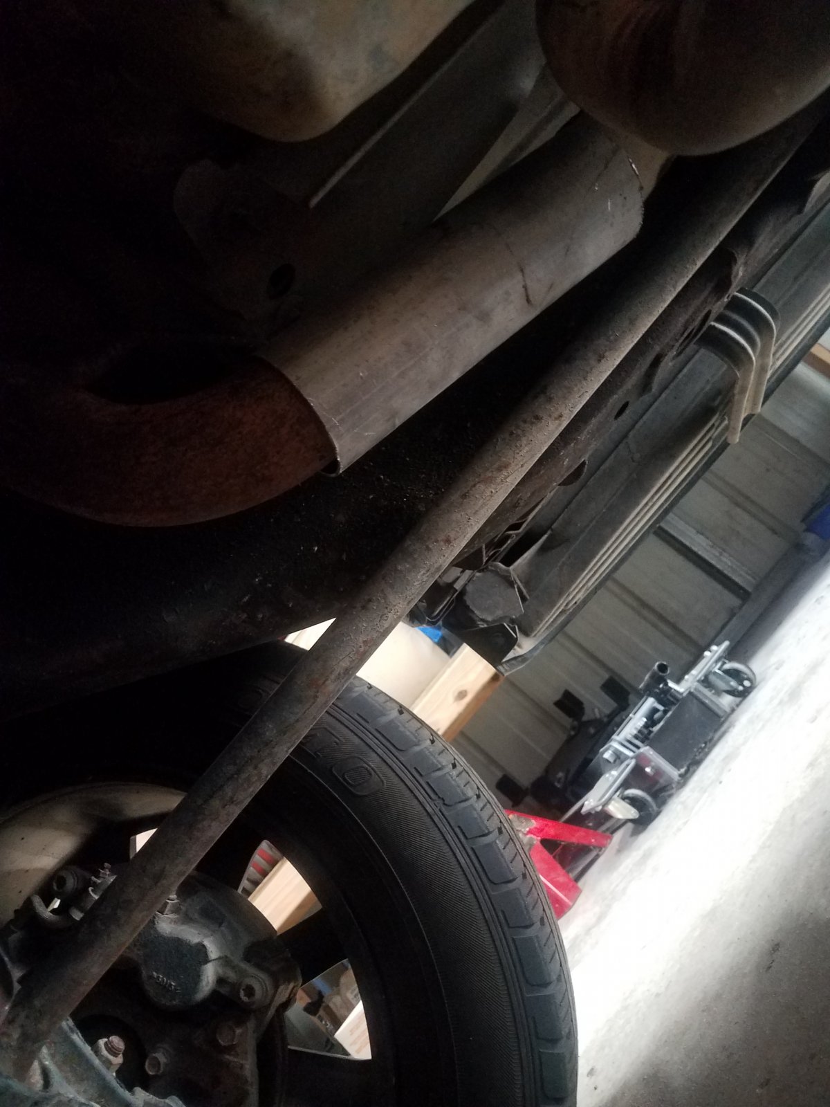

I know the combo of resonators looks super crooked but that was by design, the Y pipe was angled just a tad too high and to the passenger side. Rather than redo it since it doesn't leak I figured canting the muffler pipe over would be fine, and it worked great. Gonna pick up some new nuts at Ace Hardware today and tomorrow morning I'll tighten it up better, build a muffler hanger probably out of some flat stock and just hard mount it to the frame. Then take it for a drive and see if I can command third or not. Also might try a burnout see if its got the ballz.
