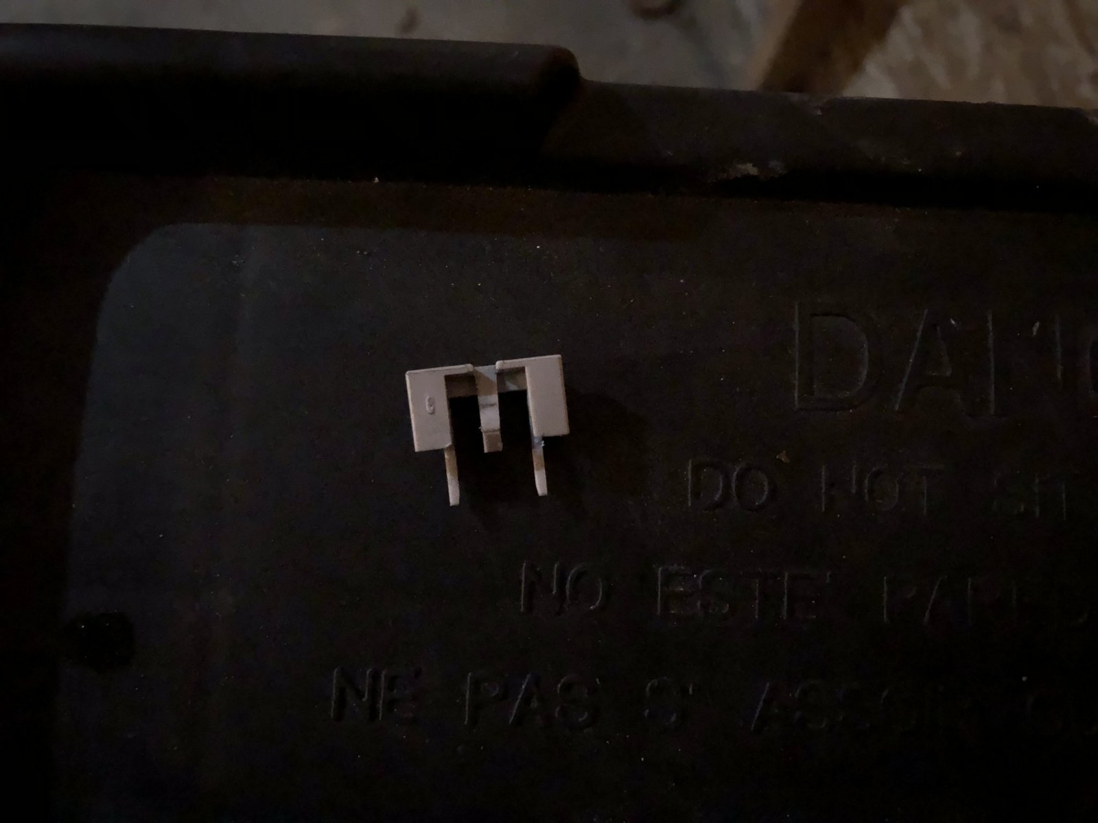

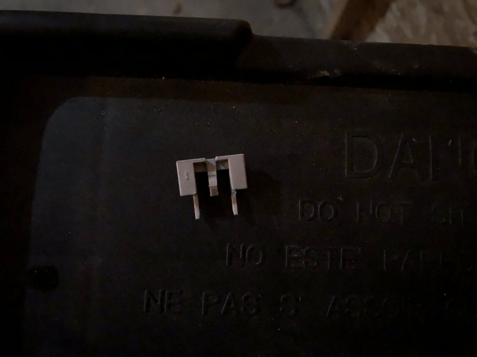

After far too long, I did it. I managed to get that plug unclipped. I pushed in the little grey notch inside the black tab (check my video in the first post), then managed to pull up on the grey piece as @DSN46 indicated, but it didn't just stop at 1/2 inch, it came right out. Oops! :)
Then I was able to press in on the top of the black tab (which is now free to move with the grey piece out of the way, probably a lock of sorts) and wiggle the plug off the sensor. It really was a Hallelujah moment!
This thread by @jrsherfy https://www.tahoeyukonforum.com/threads/oil-pressure-sensor-p0521-p0522-p0523.99332/
And this one by @Burb!! https://www.tahoeyukonforum.com/threads/p0523-and-0-psi-oil-pressure-fix.90150/
in addition to @DSN46 above and others that I have read over the past weeks while waiting for it to warm up were all very helpful in figuring this out.
I didn't have a new screen, so I tried to remove the existing screen without damaging it (i.e. not punching a hole through the screen it to hook it and pull it out) unsuccessfully. Since my first symptom was high pressure, not low pressure, I'm not concerned that the screen is sludged up and in need of cleaning or replacement. The base of the old oil pressure sensor was very clean, and I was too cold and sore to put much more time into this to be perfectly honest.
After getting the new sensor in and the plug reattached, I did not try to put the grey "lock" piece back in. Two reasons - at this point, I'd have very likely dropped it, and also if this procedure didn't solve the problem, if there was a leak, or something else that would require removal again, I didn't want to have to pull that off again. Call it a trick learned from many years of fixing, upgrading, and building computers. You don't put all the screws on the case back on until you know it works. :)
All is well now, and I couldn't feel any signs of a leak after a test run (I didn't want to tighten it too much - stripping the threads after all that work would have killed me).
