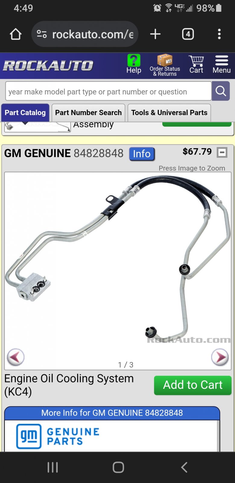

Dang that's expensive, guess it's a vette thing, lol. More than likely because of the valve?
A GM oil cooler line from RockAuto is $67

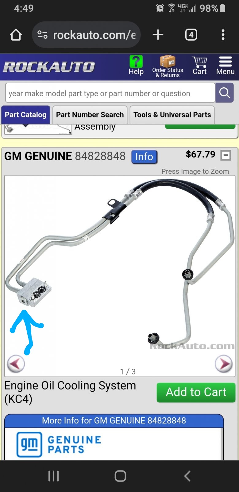

if that's they truck link, the valve there. arrow pointing to it.
I used a Dorman set for the lines. I'm not sure why I didn't go with the GM ones, wish I would have now. But the Dorman does have that same valve. Should I try and adjust?

far as I know there's no adjustments. I was just thinking it might not have it at all.
if you're really curious there's a test port on the drivers side of the block in the front. you could test the oil pressure right off the pump and then compare it to the sensor port up tops with a mechanical gauge.
I never knew that was a valve. I know it's not adjustable and that there is an o-ring under it that can start leaking and need replacing. I just thought it was a blocked off port for some unknown application, lol
Most people on here don't know what that port is for either, it's been discussed in other threads. Glad you shared this knowledge with us, and now we know
ahh I hadn't see the threads.
I believe this is valve under itself and can be replaced.
