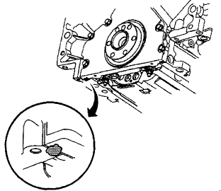

It’s very important that when you do the pan gasket or front or real seal that the 2 front and 2 rear spots where those gaskets meet have RTV added. It’s easy to see where that’s needed, maybe watch a YouTube if you’re not sure, and you don’t need to slather it on, 1/2” long and 1/4” high is good. There’s specific instructions, and make absolutely sure to follow the correct installation and torque instructions for the pan. That’s why the words are stamped in the pan, that it’s critical. Because it is. Be sure to re-torque the pan bolts again in a few hundred miles.

Your pan is going to leak. Did you look at any instructions, YouTube videos etc? The RTV is NEEDED no matter whose gasket you use, and everybody does it, not some. It goes at the places where there’s a gap where the front and rear covers meet the gasket ( they’re ALL one- piece gaskets not just Fel Pro) The RTV fills in those 4 gaps. It doesn’t need to stick to the gasket, it’s there to fill in those 4 voids. Without it there’s 4 voids that WILL leak.
