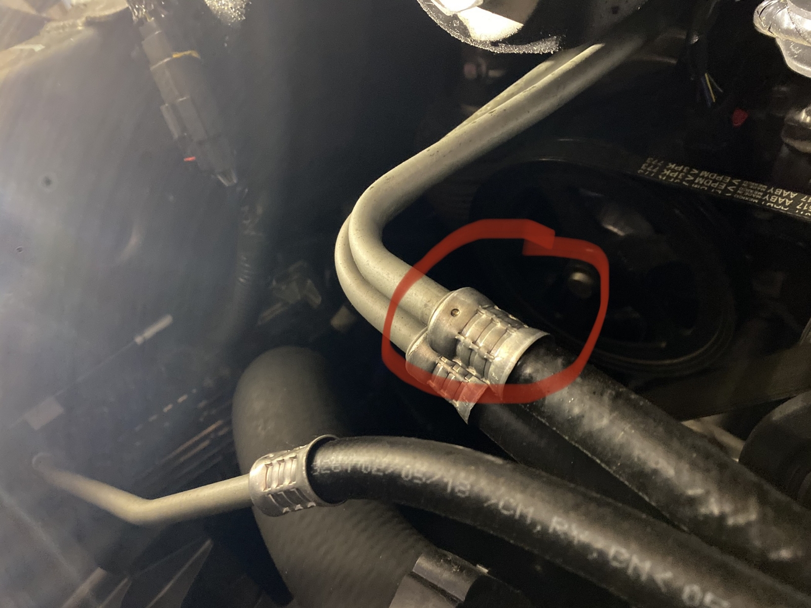

I have a small leak on one of the engine oil lines. It’s where the metal connects to the hose. The plastic shield has a slight oil residue but no puddling. Is this a common problem with these hoses?

Anything with a crimp fitting like this design will eventually leak and will start as "seepage". Keep an eye on it and the oil level and get some money together for these: Oh, hell, never mind. I can't look up the hoses because you gave no vehicle info.

Ok. I’ll do that. It’s a 2018 Tahoe with 23k miles which it’s covered under warranty. Just didn’t think I would see a leak already. Ugh plus I hate taking it to the dealer for them to work on.

Don't bet on them covering it. Seepage can be explained as "within GM specs".

My dealer is actually good. It’s just a process like anything else. They did my motor mounts under the tsb with no pushback although it really didn’t do much. Who knows it probably has been weeping for a long time. I only noticed it when I dropped the protective shroud to change the front differential oil. The plastic wasn’t really wet with oil. You could just see where some dust stuck to it and felt oily. Will it get worse? How fast? Who knows. I think the point of leak is the little hole. Not too concerned right now I have other pressing things.

Exactly. That’s why I dread taking it. I am almost thinking of getting the part and doing it myself. Part is about 90 bucks includes both new line. Straight forward install. Have to look at it more closely.

I hear ya. Yeah they have loaner vehicles. Not a big deal though I have a third car. So if I do decide to do it I have the time and won’t feel rushed. I saw the part online. It has 2 bolts at the tranny and the special connection at the radiator which I have the tool to expand the clip. I got the tool to do the tranny fluid exchange. So still kinda up in the air. Now if I take it in should I put my stock intake pipe (the batwing) back on and put the stock tune back? I mean the oil leak is not in relation to the tune or air intake. I know some do and some don’t.
