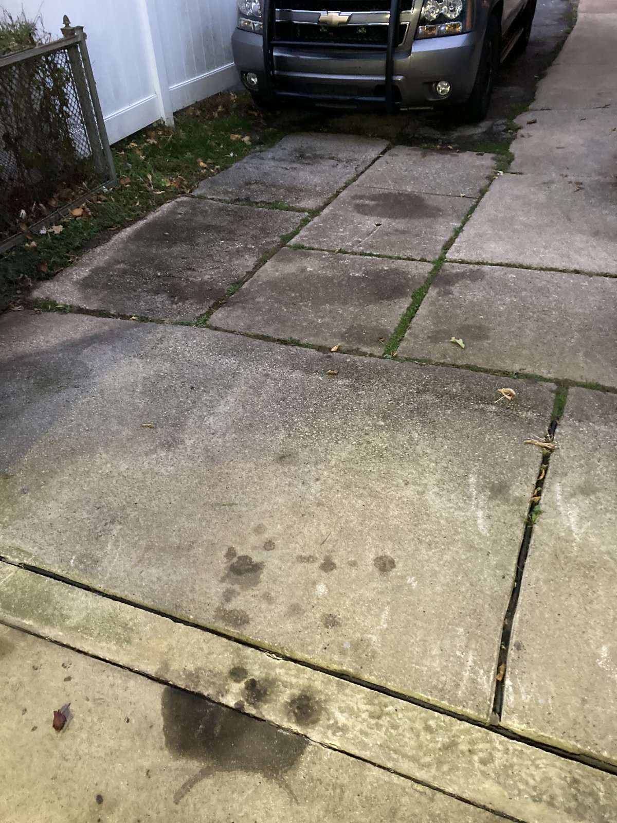

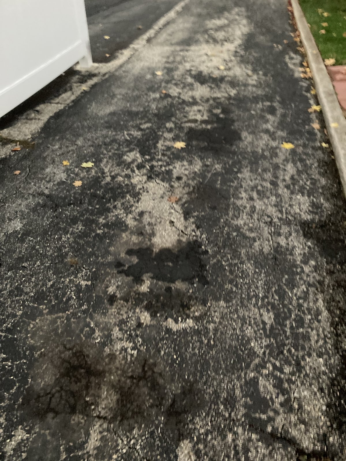

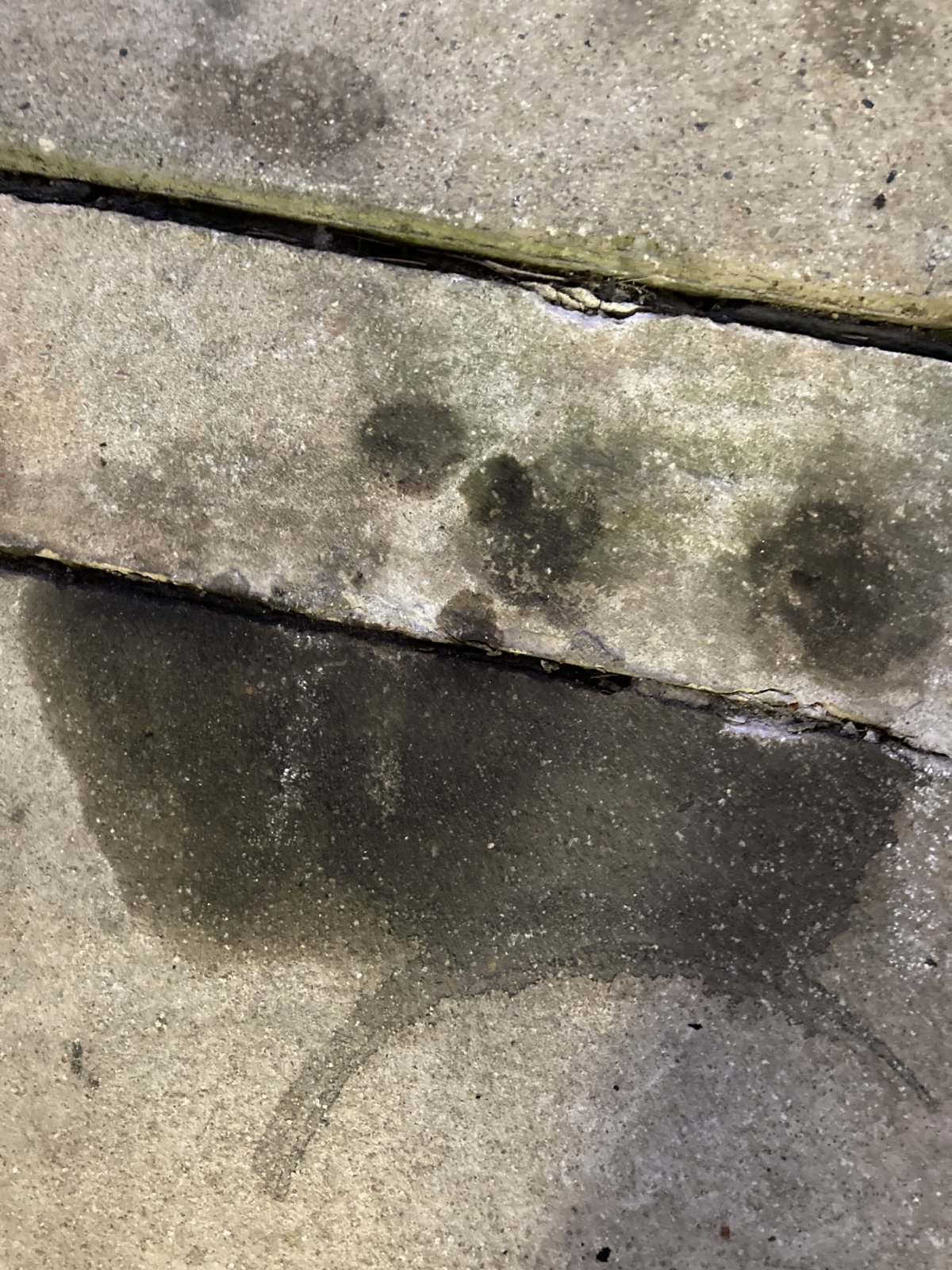

I have been battling a rear main seal leak for quite a while now. Anywhere I would park it would leave behind 4 or 5 2" circular drips on the ground. Oil pan was always covered with windblown oil, as well as the crossmember, front sway bar, transmission pan, etc. You can imagine how ugly my driveway and parking spaces in the street and at my work look. They look like grease pits. I was loosing about a pint a week at least.
I saw your post and checked out that Blue Devil Rear Main sealer you mentioned and review. I looked it up on Amazon and read those reviews as well. I have an original 5.3 with over 340,000 miles on it. I figured what the hell and threw a bottle in last weekend. Ran it for the week. I pulled it into my shop to do some front end work. I could not believe it when I climbed under there. There was 2 drips on the oil pan, 1 drip on the crossmember, trans pan was BONE DRY. And it did not leak ONE DROP onto the floor while in my shop. I still don't believe it.
You the man! I will update as time goes on. For right now I am FLOORED. I'm gonna hit the warehouse floor at my work tonight and do another drip test and post pics of before stains and after.
I just took a some pics of my decimated driveway and sidewalk, and the entrance of my garage where I parked this afternoon is the last pic, not one fresh drop right there from today. IMPRESSED.
Here is my shot at work on the warehouse floor. You can see the old stained spots easily. Now it’s just one new drop.
It floored me as well. I was just hoping for it to slow it down enough until i could take the time to fix it, which I will still repair it properly but dam it actually stopped it. Don't know for how long but have read that people have used it with oil changes after having success with it and never having another problem. I never had any faith in chemical repairs along with being scared of what the additive(s) may cause later. Glad it worked out for you.
