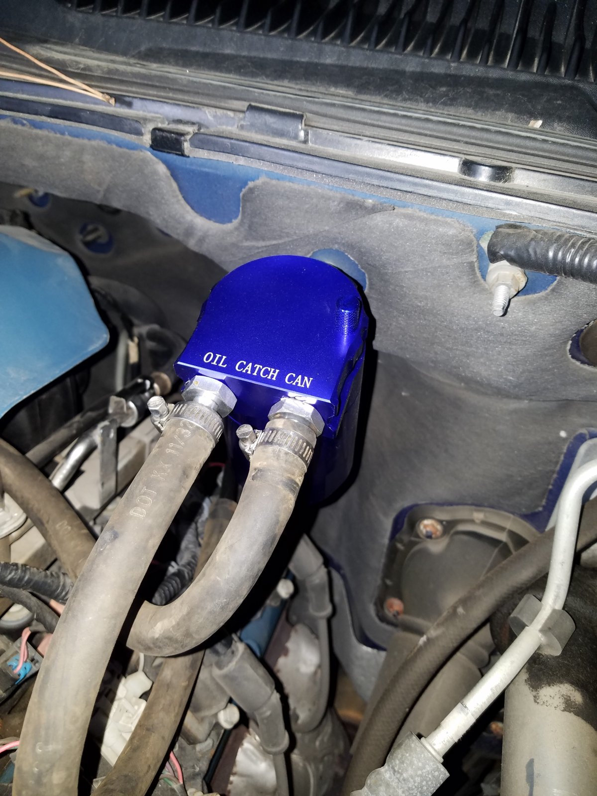

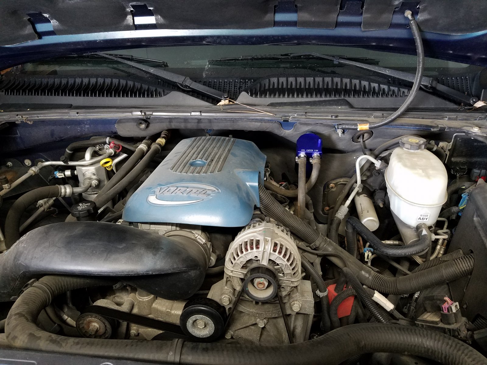

I think something you should invest in also, is an oil catch can. It goes I line between the pcv valve and the intake manifold. I will capture and excessive oil vapors and not allow them to be burned.
Catch can on Amazon
I love mine. On the Tahoe it collects about 250ml every 4800km. I just unscrew it and dump it out. The Silverado has one as well and it collects 250ml every 1600km, but it also has 676,000km on the engine now so it has the right to be worn out.
