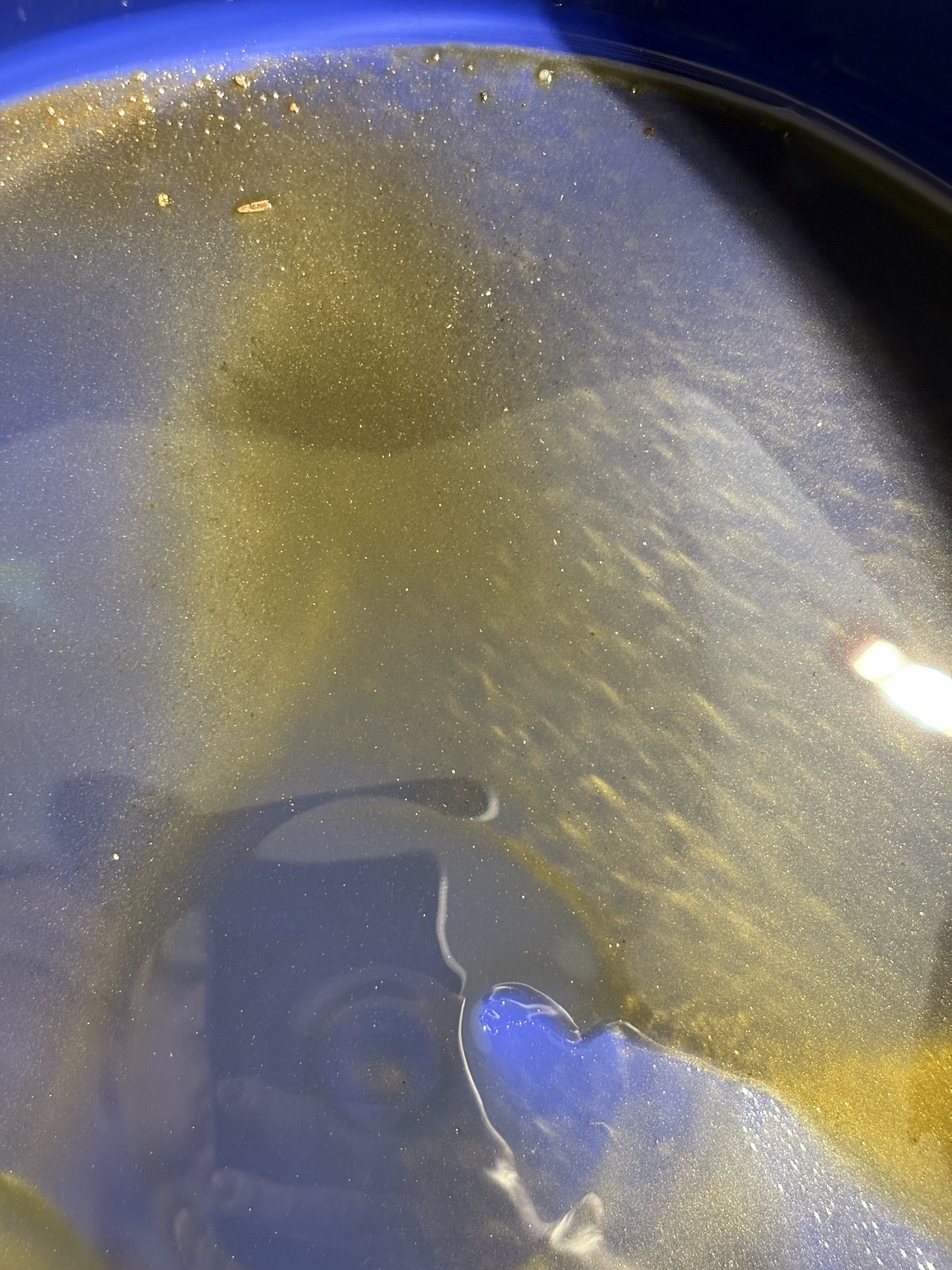

Below is my yukon’s first change at 500 miles… look at it closely by zooming in… you will see a lot of debris.. change the oil until you have eliminated this field of trash coming out of the motor… every 500 miles till it is clean…
I expect tooling on the V8s has had it.. and gm is not cleaning like they did on my old ‘18 5.3… which clean as a whistle.
My ‘24 engine.. tooling not so good… cleaning not so good.. change the oil a lot if you want a motor that lasts.
Also install a catch can.
Also install a carbyte.
Also the guy suggest a little heavier oil are probably right.
