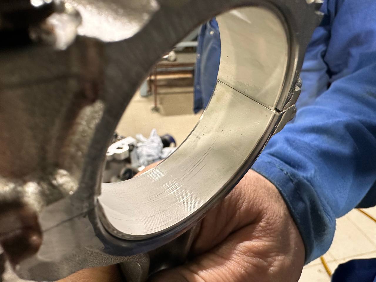

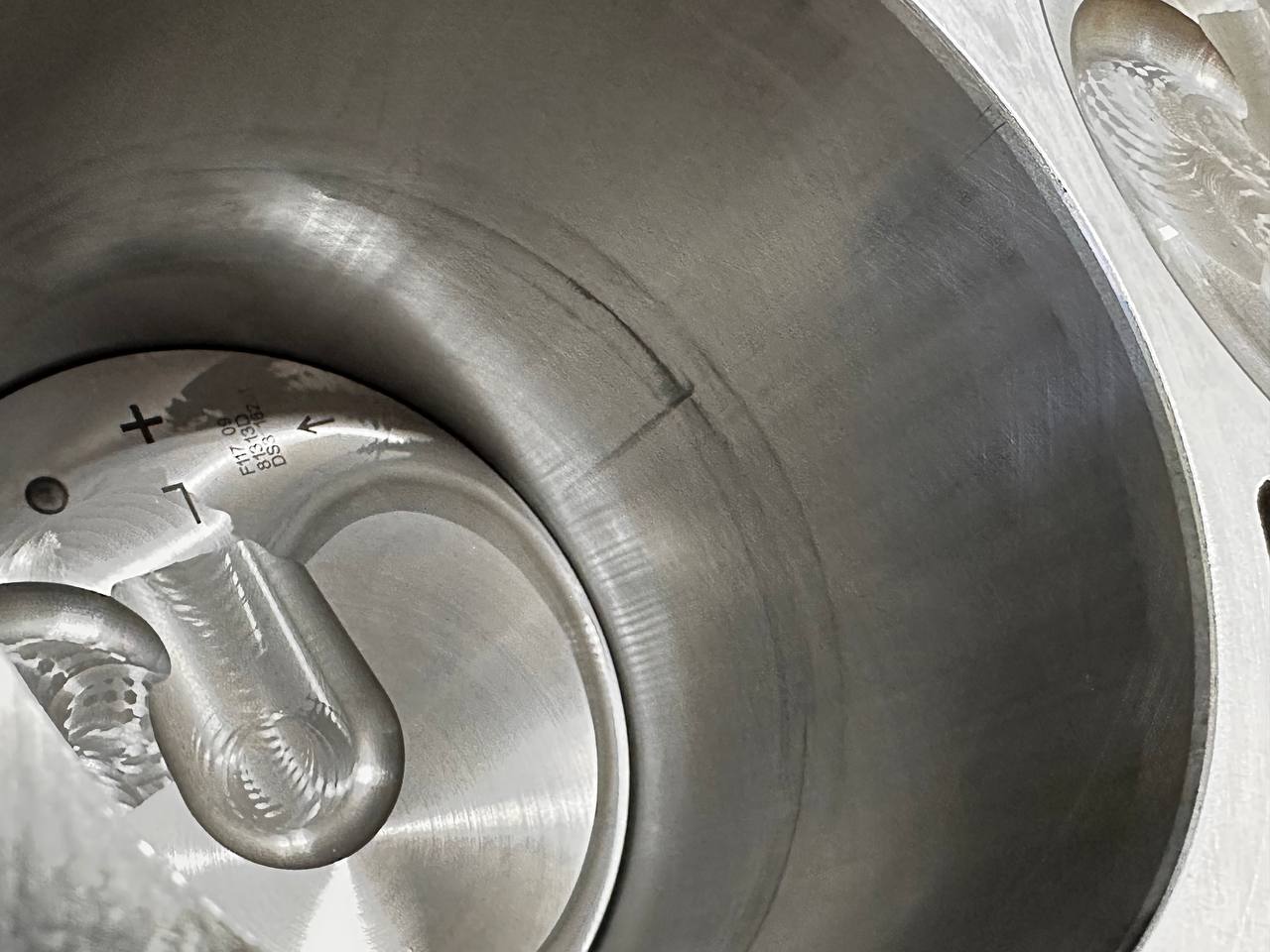

You either read selectively, or you see only what you want. I don't blame the bearings exclusively. The fault lies with the low, very low quality of the engine assembly.
I have already provided a photo of the engine with a production date of 207th day of 2024. And according to the mechanics, it is assembled even worse than the one they gave me, with a production date of May 2024.
And no matter what oil you pour, even 75w90 transmission oil, it will not help the engine. Because it looks like it was assembled in an old garage by a clumsy craftsman.

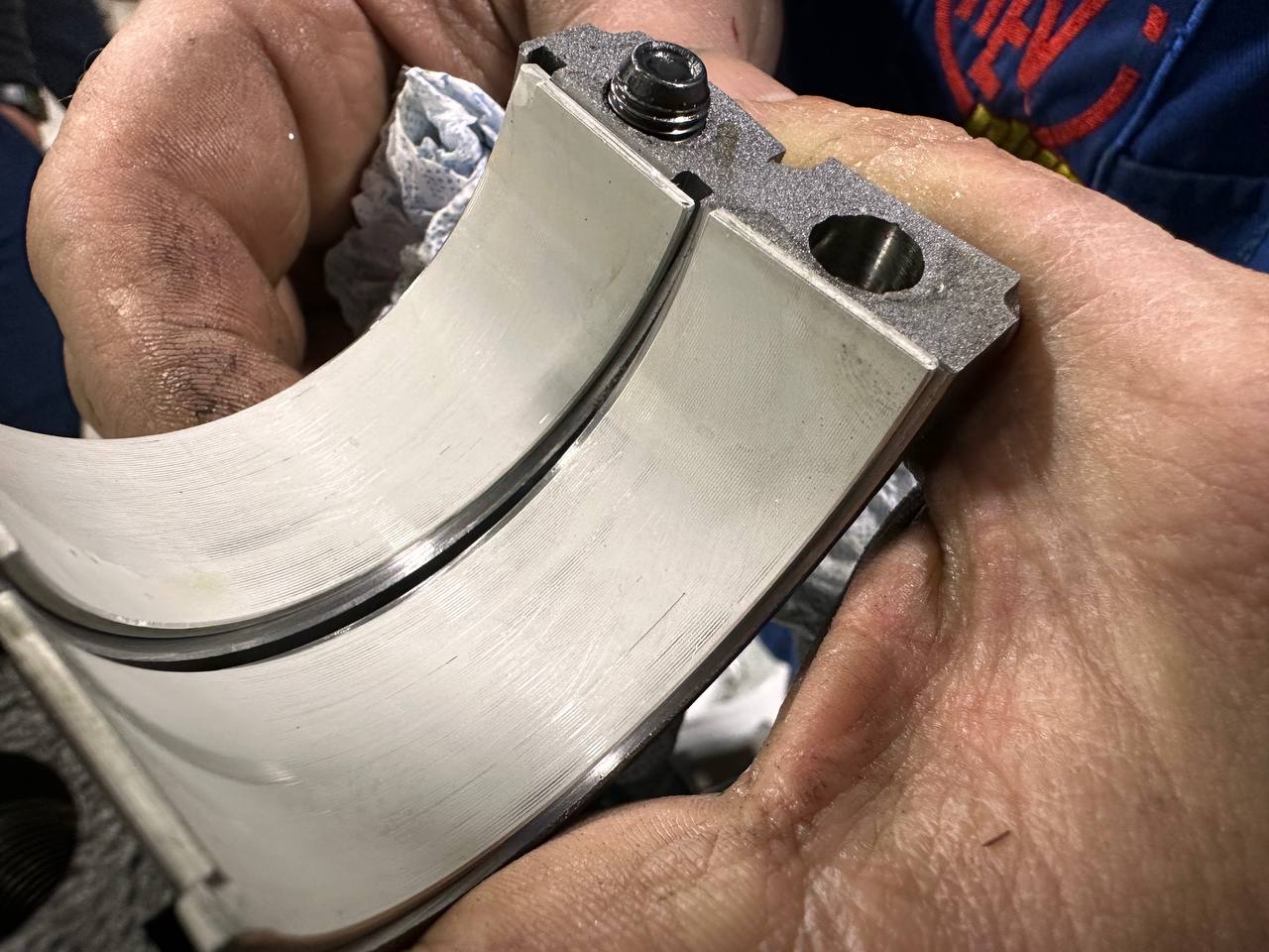

The liners here are like the first wear indicator, which takes the first blow. Moreover, simply replacing the liners, as practice now shows, also does not lead to anything, because if the shavings have already appeared in the oil channels, then even with a replacement for red liners, this shavings will behave as an abrasive, sharpening the red liners too.
If metal dust has already appeared in the oil, then it is already necessary to conduct a deep revision of the engine. Change the oil pump, because it will already begin to wear out, change the oil line tubes, and the oil radiator, because it is impossible to wash out from there. Here is an example of a person on red liners after 8,750 miles, and an oil change every 4,400 miles. and oil 0-40.
Do you see the wear? And this is after a short run. Do you know what will happen next? I'll show you in the next comment.

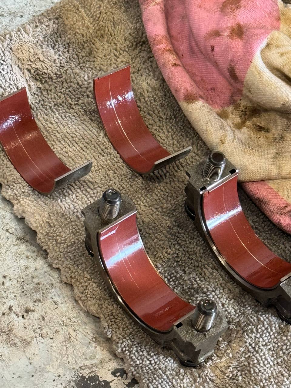

Here's another example, red liners, and more mileage than in the previous example. What we have here is also a simple replacement of liners, and faith in only their replacement... as a result, the red liners were eaten to zero, the crankshaft is blue. I repeat once again, stop writing nonsense about 0-20 oil.
You have been running around this forum for a long time with different ideas, conjectures, sometimes 10th gear is to blame, sometimes the oil is contaminated with fuel, sometimes the oil is too thin... no... absolutely not... and 10th gears are already running on many cars, 0-20 oil has been poured into various cars that drive around the world for 10 years now.
And they don't experience any problems with it. I already wrote on this forum that there is no research that says that 0-20 oil reduces engine life. Yes, there is fuel efficiency, but nothing about life.
There is only one reason for L87 failure. One is the only one, and there is no other.
This is disgustingly low quality of engine assembly. During assembly, GM itself violates its own parameters for gaps and tolerances. That's it, there are no more reasons. Chips, wear, metal in oil, these are all consequences of this very reason. Oil, bearings, crankshaft, these are all consequences... the reason is disgusting engine assembly. And I repeat, changing oil more often, pouring 5-30, 0-40 is generally pointless.
No oil, even the thickest one, will hold up when your bearings are worn out and the crankshaft is already scratched.
