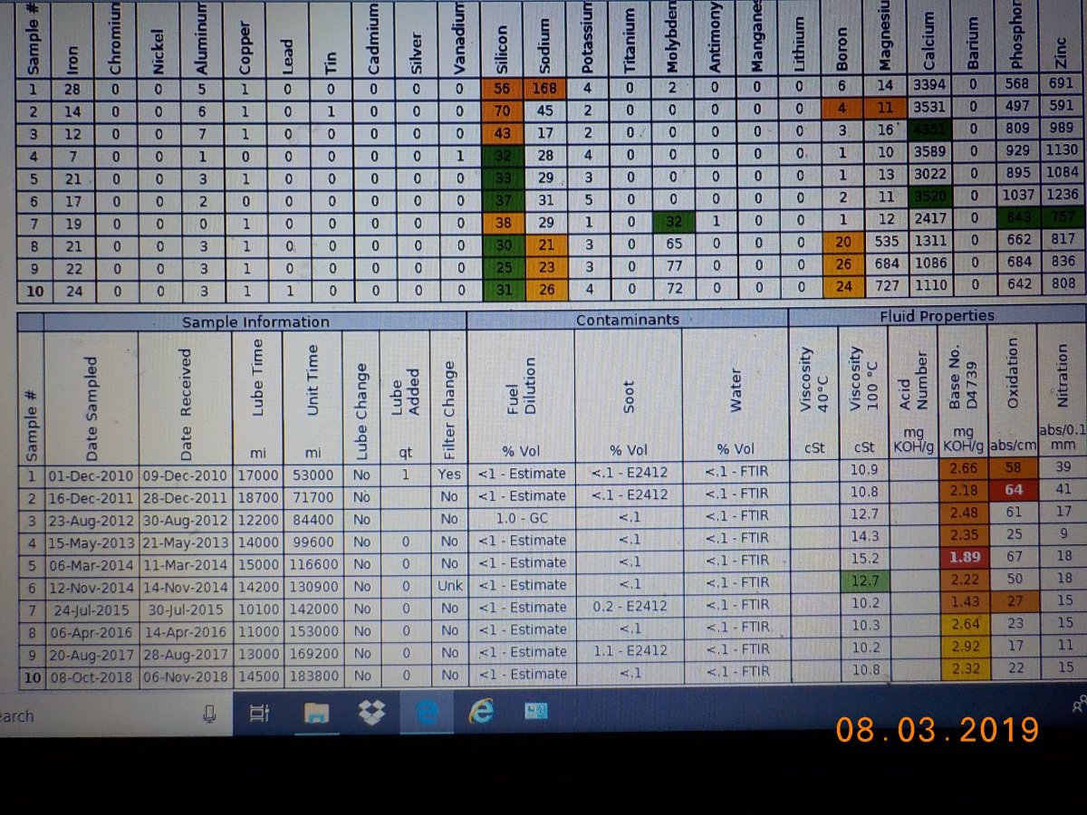

Below is a picture of all 10 UOA reports for my current daily driver, 07 FJ Cruiser, w/240hp 4.0L v6. It gets 20+ mpg doing 100% local driving. So its much easier on oil than the Yukon. The oil brand was Amsoil for the first 6 reports. You can see how high the "oxidation" levels were w/Amsoil and it didn't hurt a thing. The FJ now has 195k miles on it and doesn't burn or leak any oil. Like the Yukon, I run a engine oil bypass filtration system on it. Toyota says to run Super unleaded. It has seen nothing but regular unleaded. I'm getting away w/ mid-grade unleaded in the Yukon. The FJ has the same oil in it as the Yukon right now, Mobil Delvac 1 ESP 5-40w, and I will do a UOA on it before the year is out. The oil will have 10-12K miles on it. That will be interesting to see how it held up compared to the Yukon.
TBN, total base #, is "the additive package level" in the oil. The better the oil, it usually cost more, the more robust the additive package, and the longer the oil will last. Also, the better oil start out with a higher TBN#. This oil starts out new with a TBN# of 12. WalMart full synthetic, see #7 below, starts out at 10. And its not just the quanity of the additive pkg, its the quality too. I like to change the oil when the TBN gets down between 2 and 3. I've used Blackstone and OAI labs. OAI is more conservative and will flag the TBN# sooner, when it gets below 3, not Blackstone. If anyone uses Blackstone Lab, make sure to pay the extra $$ for TBN# etc.
