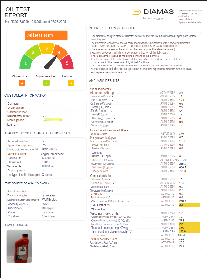

Hello everyone. I'm going to post another post. I know that many people on forums recommend changing the oil more often. I got curious, so I asked the service to take a sample of the oil during the last maintenance and send it for analysis. I'm sharing the results. I translated the image using a resource because the analysis itself is in Russian, and if there are any unclear translations, please ask and we'll try to understand them.

Let's figure it out. The fuel level is 2.2%, but as far as I know, the GM standard is up to 2.5%, and everyone who has posted an oil analysis here has a level of 1.7-2-2.5%. This is true regardless of the mileage. Therefore, there is fuel contamination in the oil, but it does not depend on the mileage, as the gasoline evaporates immediately.
The acidity-alkalinity ratio honestly corresponds to the old oil at the end of its service life. Would it reach the recommended 7,500 miles? Yes, without any problems. The fact that it is already reaching the end of its service life at 6,250 miles is logical, and there is nothing to make you rush to change the oil earlier, say, at 2,000 miles or 4,000 miles. Why? We don't change the tires when the residual life is 50%. Most likely, everyone drives until the residual life is 20%, and some people change them completely. I don't see the point in changing the oil earlier. It's normal, and it hasn't turned into water or shoe polish.

thanks for posting the oil analysis. Your use case is definitely interesting.
The acid number is extremely high. A print of 3.92 is just under the typical limit of 4.0 in engine service.
The danger in running the AN this high is it usually indicates the oil is a ways into the process of oxidizing. Oxidized oil does not lubricate well (shear stability, etc).
The acid content is likely a combination of the higher water content and fuel content of the oil.
What is spooky is the viscosity reading may be reflective of this phenomenon occuring. A print of 7.3 cSt is right on the spec for 0w20 synthetic. But you have to wonder if this is from oxidation increasing the viscosity.
Looking at the TBN is 2.2. Most Dexos spec synthetics have a TBN of 6.5-8. This magnitude of change indicates the additves are getting consumed trying to neutralize the contaminants in the oil.
I would move the oil change interval back about 1000 miles and sample it to see how that looks.

Vladimir,
The danger in running the AN this high is it usually indicates the oil is a ways into the process of oxidizing the oil. Oxidized oil does not lubricate well (shear stability, etc).
Do you mean change the oil not at 6250 miles, but at 7250-7500 miles, and see what happens to the oil at that mileage?

For comparison I would do oil analysis at a lower interval meaning 5250 miles.
I would absolutely not push the oil past what you are doing now especially with how you operate the engine.
understand your idea. Change the oil at 5,000 miles +/- and analyze it. I'll think about it. But on the other hand. What will I see?:) That the resource is a little more than 6,250 miles? It's logical. It's just that this analysis shows that at 6,250 miles it's at the end of its resource. It's not dead, there's still a little reserve. But it's already at the end of its resource. And this, as you correctly noted, is taking into account how I operate my Yukon:)
