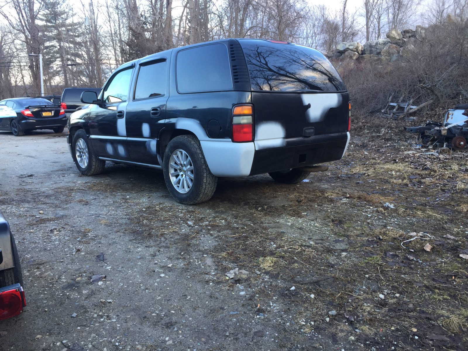

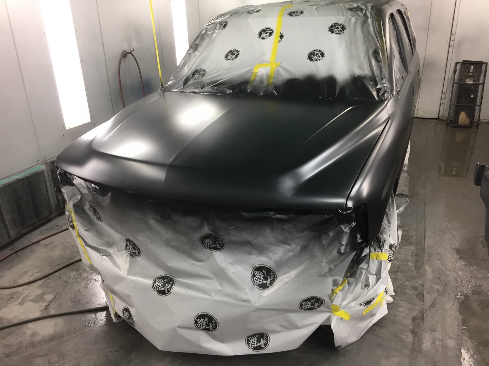

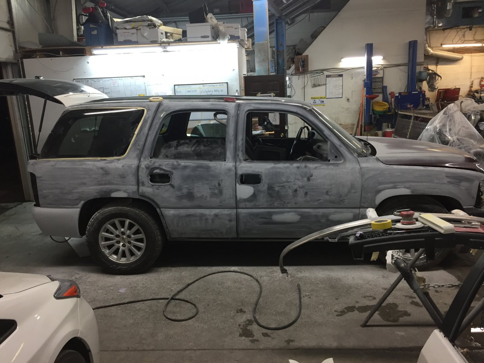

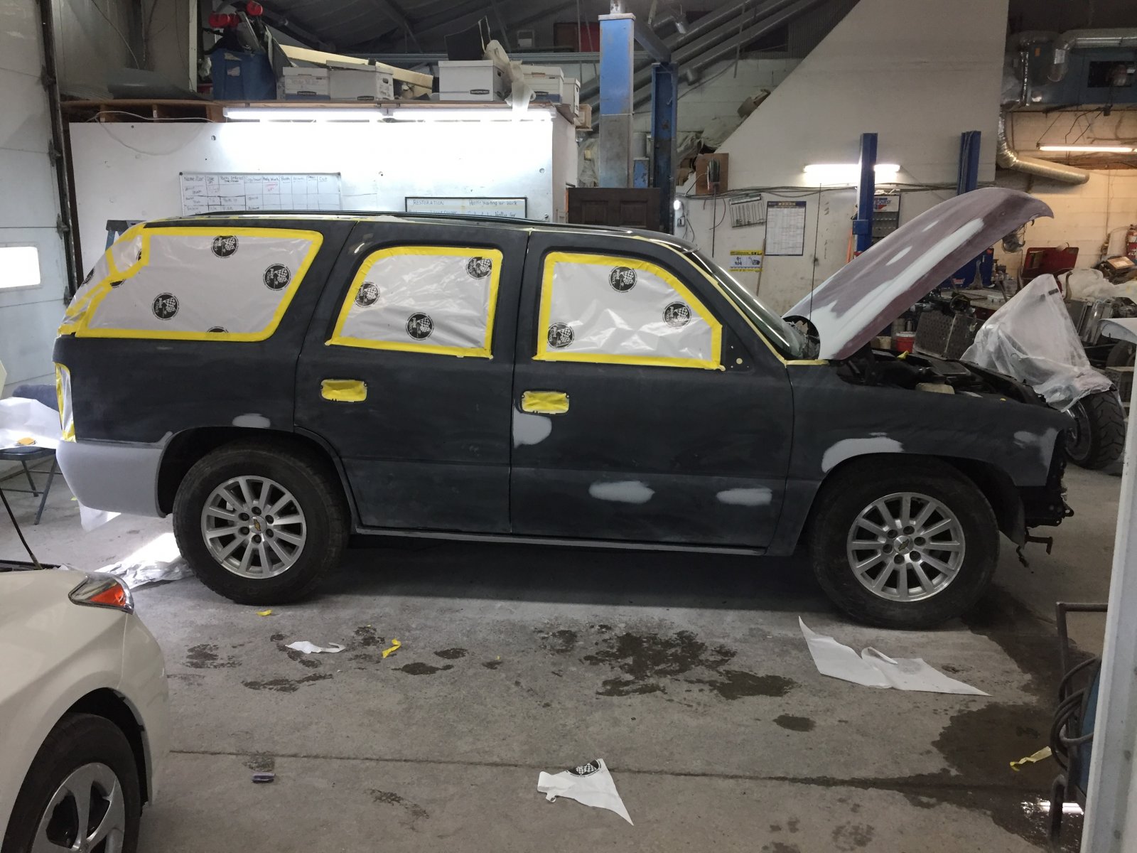

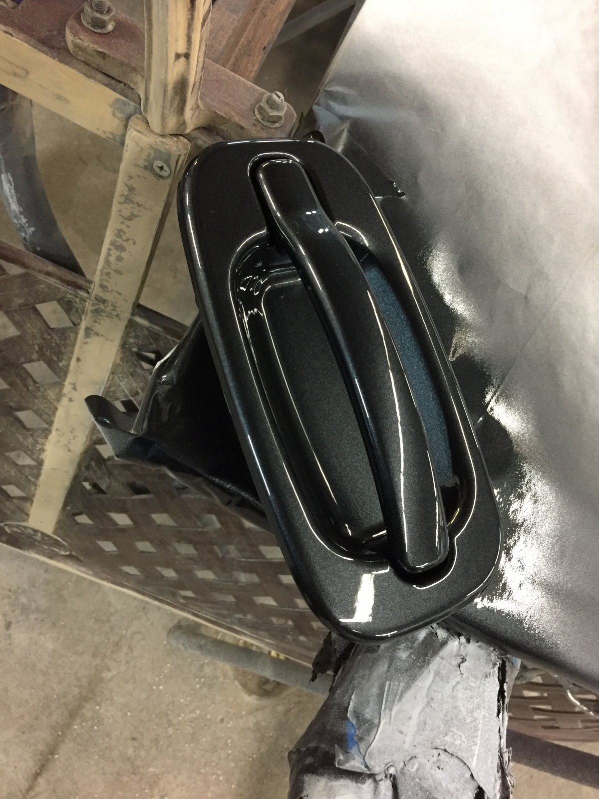

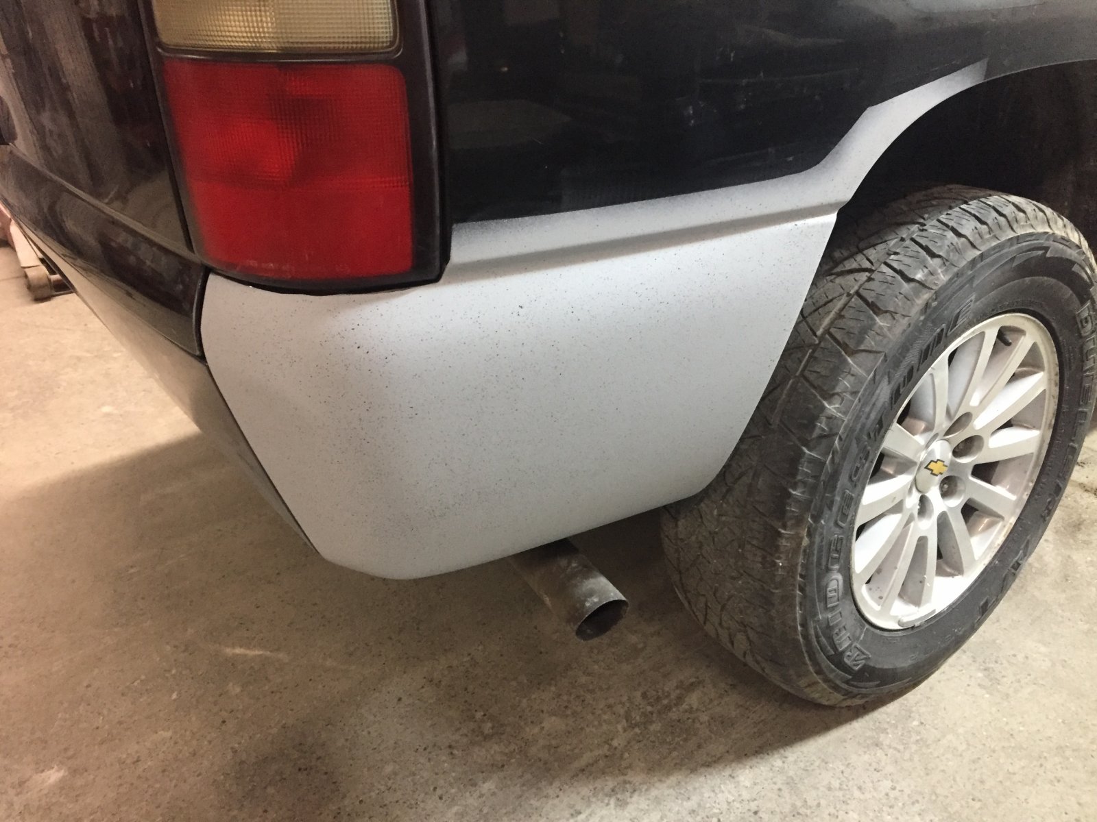

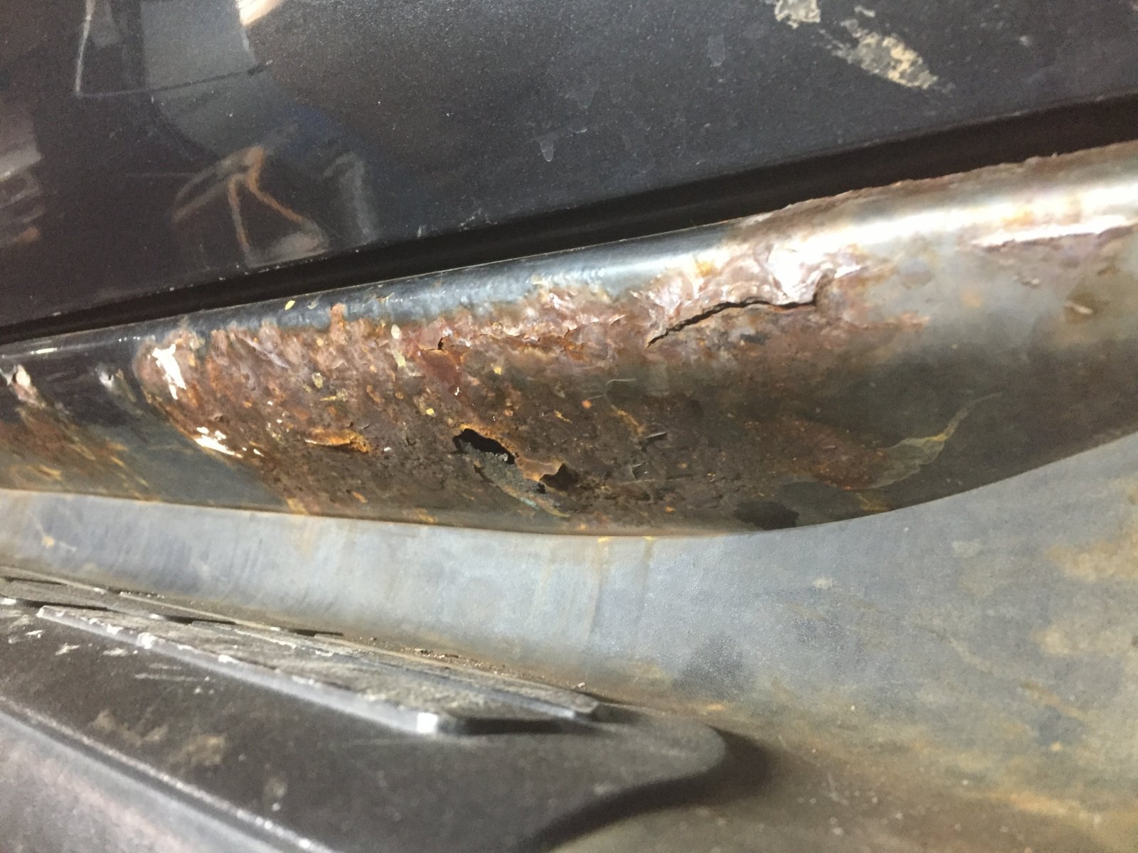

new to this sight but this is my 2004 Tahoe I have been working on for my new daily driver.
Bought it almost 3 months ago and here is a list of the things I have done and some pics.
Btw I am a body man/metal fabricator by trade so all labor was free.

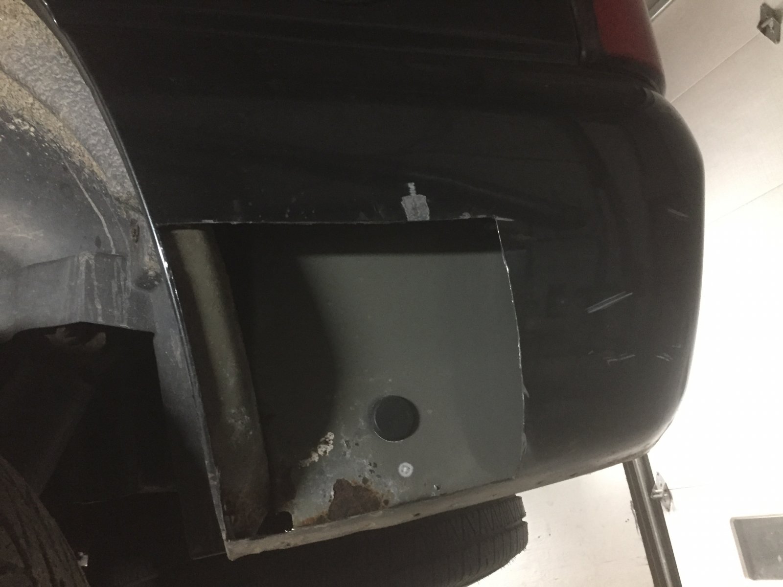

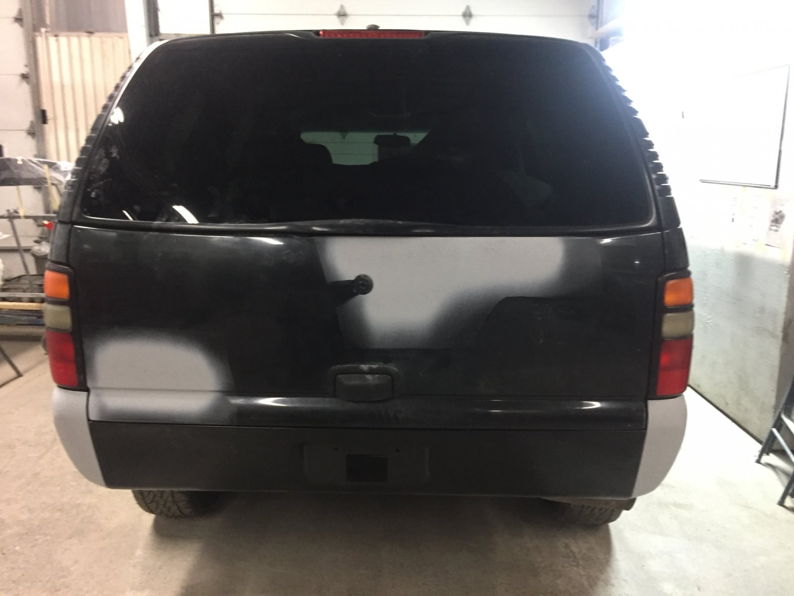

Body stuff included:
Lower 1/4 panels L+R
Rocker panels L+R
Shaved gate (wiper arm & arm bracket)
Fixed all dents and dings in entire truck
HD hood ,grill and top cap
Lowered stock bumper
Removed Mouldings roof rack and all emblems and running boards
Escalade Esv rear glass , brake light and vent caps
Steel roll pan

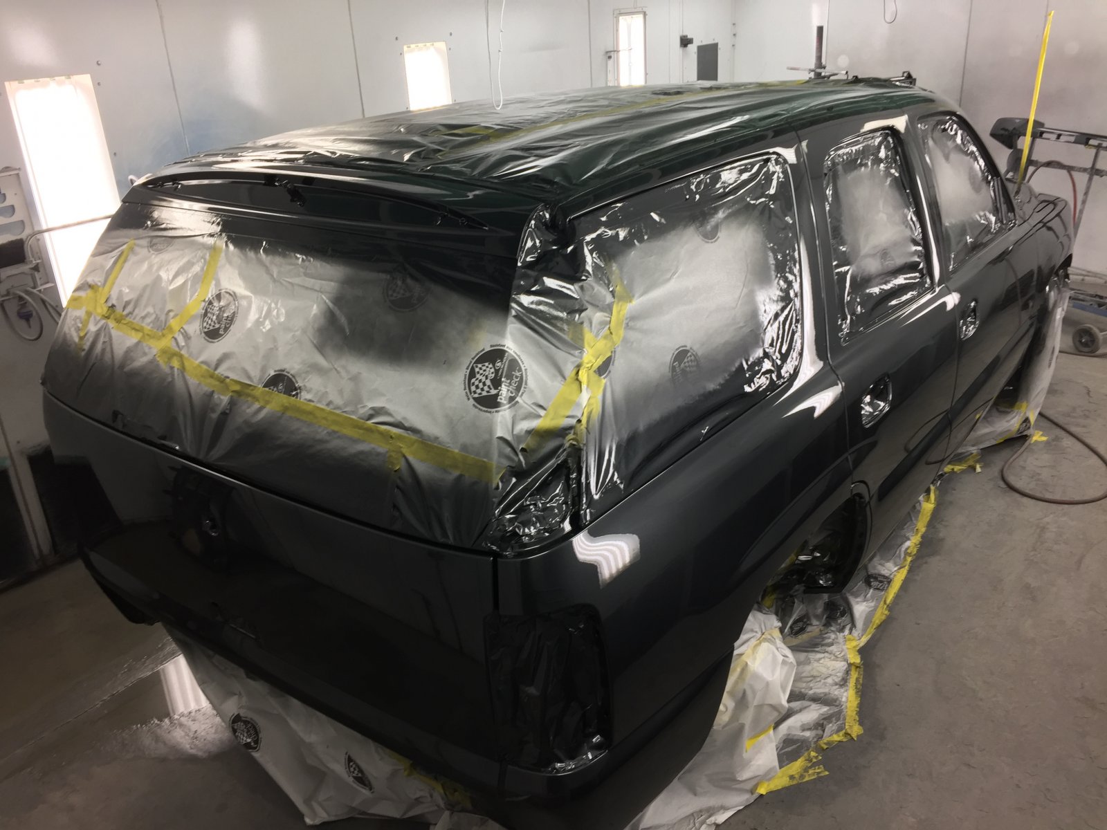

Color matched top cap, chrome bumper, all handles, mirrors and vent caps
Short school bus bow tie color matched with black trim
Black textured valence
Chevy Cruze air deflector
Hybrid Tahoe wheels (will be changing soon)
Djm upper & lower control arms -3
Djm 5 inch rear kit
Spohn adjustable pan hard bar
Free travel mod
That’s what I got so far and it’s not even on the road yet.. dmv closed in ny state due to corona virus
Pics will be from when I purchased up until present

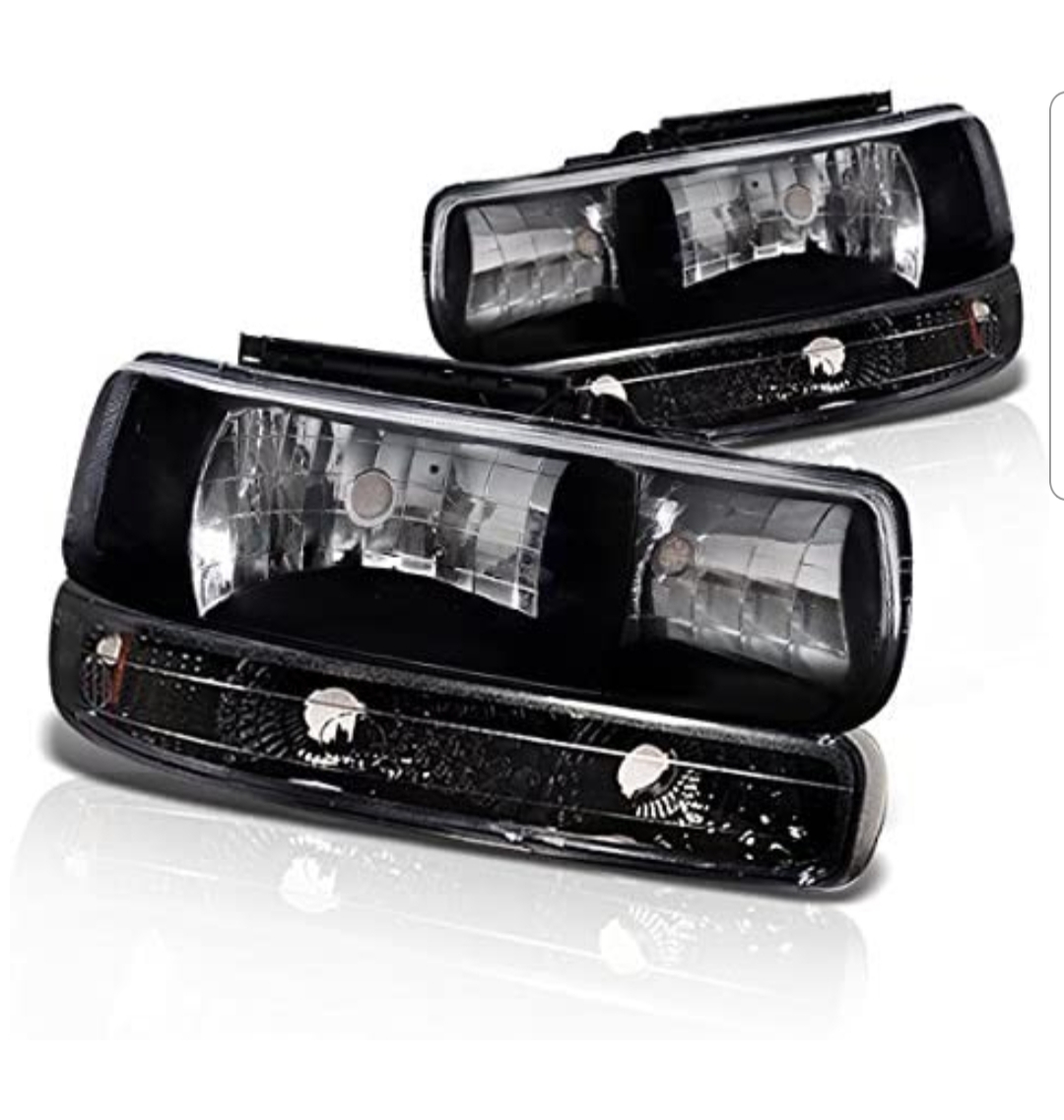

can anyone recommended a set of led taillights that match the Escalade 3rd brake? Also planing on some headlights and a few other things in the next couple weeks.

Check out Anzo headlights. I added some to my 2003 Tahoe and loved the look. I just got some delivered for my 2009 Yukon XL too.
Speedslow
Speedslow
Feb 26, 2020
61
81
I actually was looking at these ones but it looks like all the eBay and Amazon pics are photoshopped I would love to see the actual light installed on a nbs tahoe
33,328
51,796

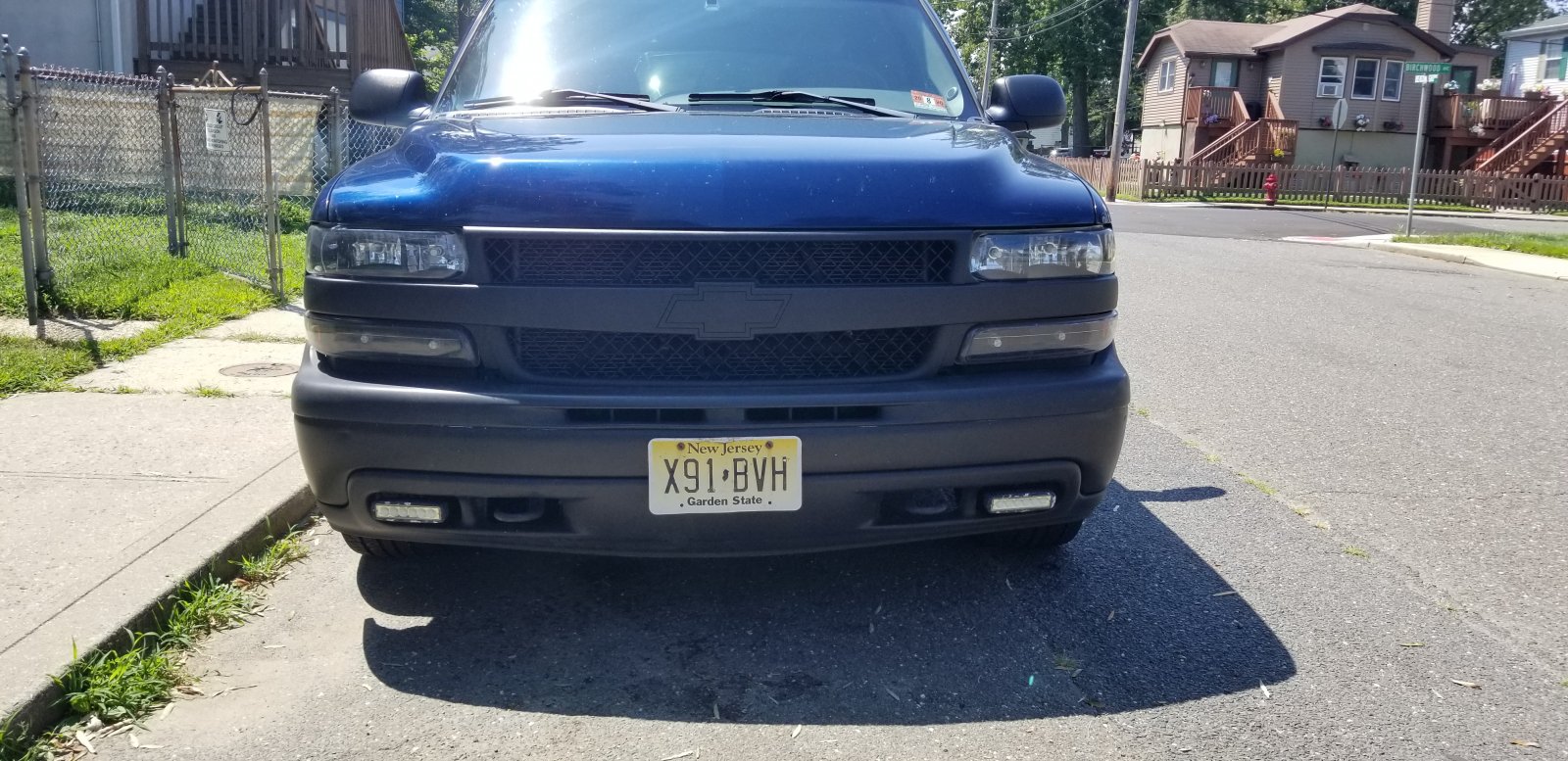

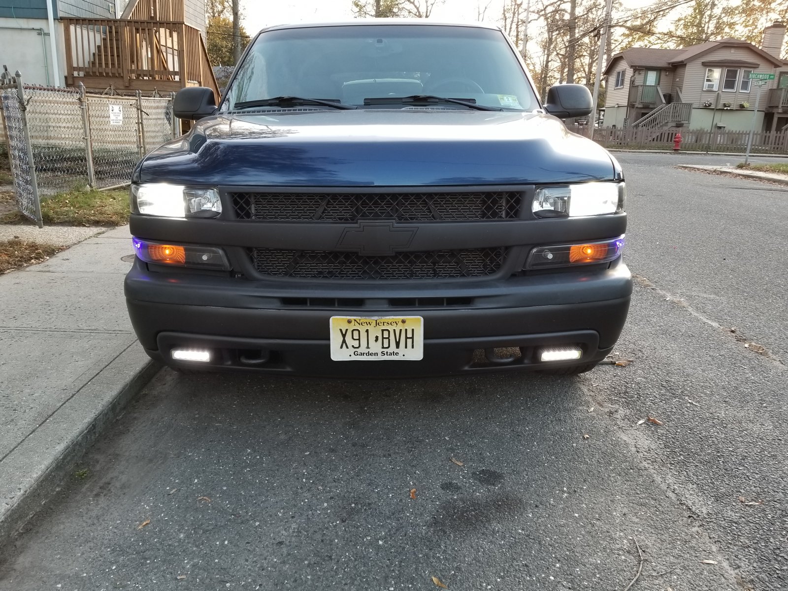

Have you thought about Spyder? I have a blacked out set.
I have leds for highs and lows.
33,328
51,796
Tony, do you have the part numbers for those lights. All of them.
Shows as Instyleparts, but they came in a Spyder box iirc.
Instyleparts Clear Lens Headlights Bumper Light Set with Black Housing Made For Chevy Silverado Tahoe Suburban https://www.amazon.com/dp/B01IB2RVSW/ref=cm_sw_r_cp_apa_i_bZrFEbWYWNCJC
DEF use your factory mounting brackets from your oem lights, and DEF use silicone all around the outer seam of the lenses, if not they'll fog. Also used dialectic grease on the gasket around the plug that twists in the back of the housings. I've had mine since 2016/17 and they haven't fogged. Really nice lights.
