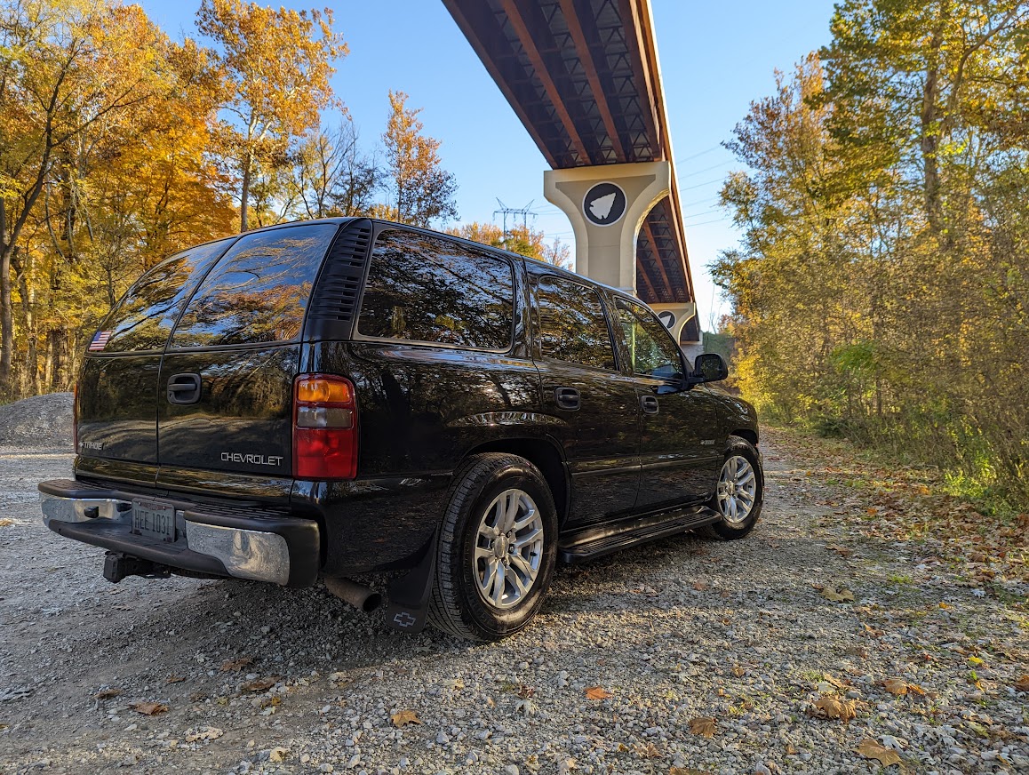

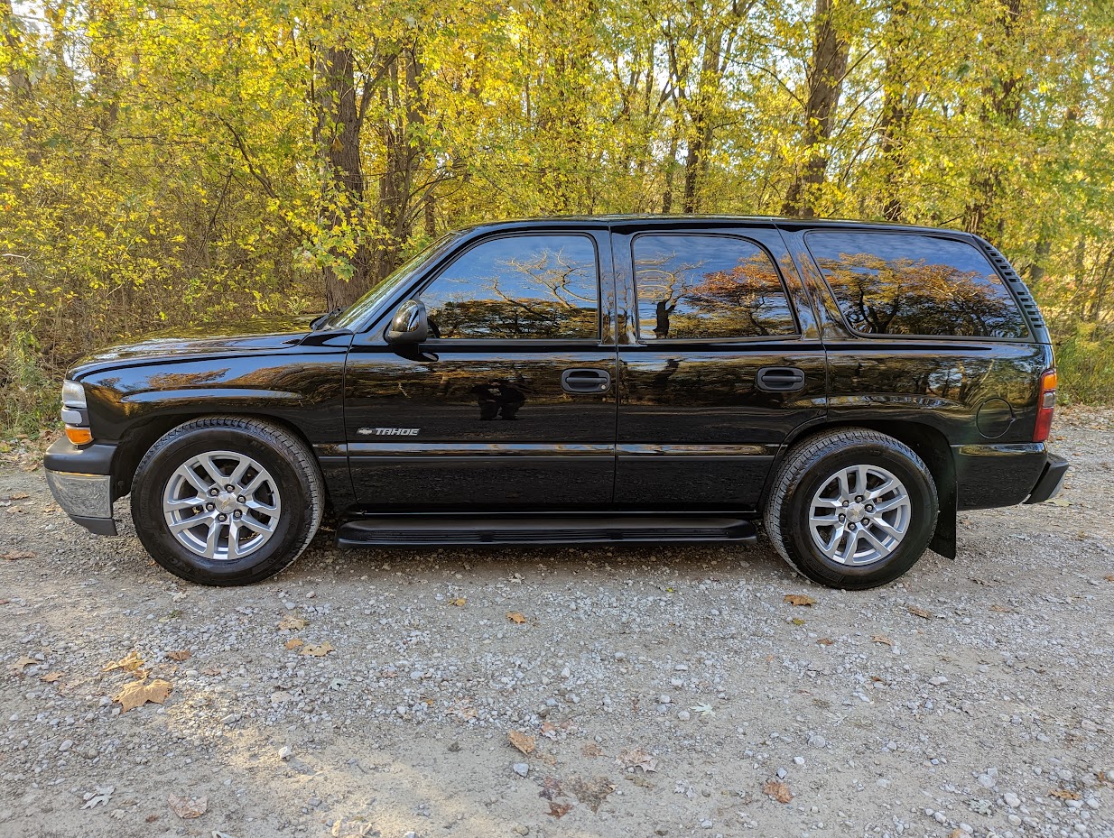

Model/Year/2x/4x/AWD:
- 2001 Tahoe 2wd
Advertised drop:
- 2/4
Fender height front/rear:
-Unknown, will update.
Front:
- LCA's : Stock
- UCA's : Stock
- Spindles : Belltech
- Sway Bar : Stock
- Tie Rods : Stock
- T-bars : Stock
- T-bar keys : Decranked
- Shocks : Belltech Street Performance
- Steering : Stock
Rear:
- UTA : Stock
- LTA : Stock
- Springs : Belltech Pro Coils
- Panhard : Stock
- Sway Bar : Stock
- Air Assist : Airlift 60742
Wheels & Tires:
- Wheels : 18" 2019+ RST
- Tires : Michelin 265 65 18
Considered upgrades:
Alignment shop told me to get f*cked, I need to find another place. They did toe it, but my camber is quite negative. (Wouldn't give me a printout) Need to do free travel mod and get it aligned correctly/figure out control arms if needed.
Brief impressions of setup:
Not a bad ride overall, rear bottoms sometimes. Front feels great, and it handles so much better.

I have the Crown springs on my unit. They seem to be a little soft and bounce over having the stocks installed. Was concerning the Belltech Coils. But wanted to know if you have any bounce with the springs you installed.
tytotheler92
Jul 20, 2021
24
57
They are stiff, I like them.
