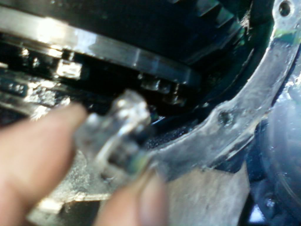

so sunday i was out in some sand getting my boat out of the water
and i guess the sand was supper thick and i got stuck in 2x4 so as i was rocking the truck back and forth to engage 4x4 this happened
notice the ring gear bolts
just a little loose huh
the gears and everything else ended up being ok just needed new bolts
and a broken bolt
off to the shop
luckily the shop that originally did the rebuild about 2 years ago
were honest and fixed everything for me no problemo!
pics kinda suck but u get the point

Did they not use locktite and torque them properly?? Nice shop, I would run in the other direction. LOL

Glad to hear the shop that did the work is gonna fix it for ya at no charge.
Like retorq said,maybe they did not do something they should have and now this happened.People make mistakes and or forget to do things that should have been done,Atleast the shop is gonna man up and take full responsibility.
Keep us posted.

yea i got it back yesterday and they took full responsibility
they think it was because when they rebuilt it they used a after market ring gear bolts
so they are not as strong at factory
and there was thread locker just not alot
so they used oem bolts and used a bunch of locker so we shall see how long this one lasts
and its great shop with tons of credibility so idk what happened

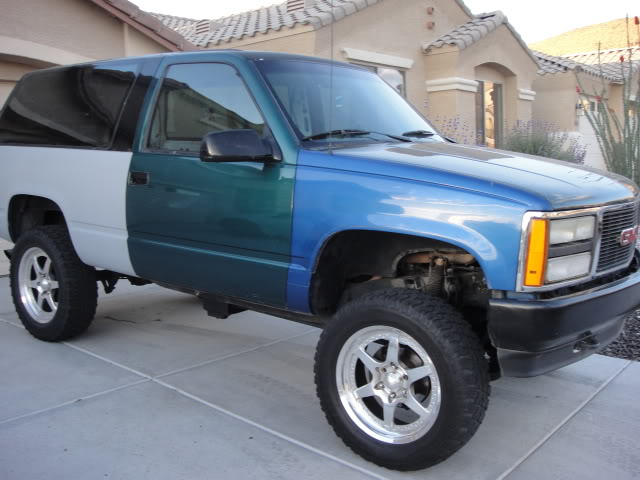

What kind of lift do you have, and can you tell tell me what you're running as far as wheels/tires? What brands/models, diameter, widths, etc. It looks like they are 17x? with 35x12.5's but who knows.

its a pro comp 6 inch lift with pro comp shocks
the wheels are 15 by 10 wide not sure the brand ( if i were u get a 17 or 18 inch rim tires are easier to find)
the tires are super swampers 35/16.5/15

Thanks for the response. Yeah after looking at it again I though they were 15x10 or 15x12's. They look like the Crager Nomads or something similar.
I've got a 6" superlift and some 20" Centerline's with 33's. The wheels are quality, but IMO way too large, and I'd like to step up to 35's. Tires are also very expensive for 20"s. Thinking I may step down to either a 15" or 17" rim for cheaper tires and IMO a better look.

Really? It seems like 35x12.50R15's are a common size and available in most every tire for around $200 per tire, which is less than half of what I would pay per tire for a 35x12.50R20. Are you referring to the availability of wider tires?
There aren't many wide 17" rims available at a decent cost, where as those steel 15x10's they practically give away. As you can see I've still got to paint the rig next, so I'll have plenty of time to think it over. Let me know if you have any other suggestions.
