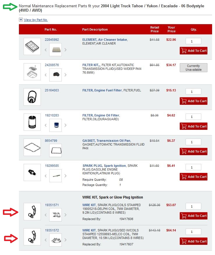

What year and engine?
And it depends on the shape of your coils.
EDIT: better yet, go to GMPartsGiant, search for parts by your VIN, and look under Normal Maintenance Replacement Parts. Here's what it looks like for my '04 (YMMV):

I didn't mean the condition of your coils, but the physical shape / brand. So check the numbers on your coils and use the GMPartsGiant site with your VIN. The length of the spark plug wires depends on your coil style.
