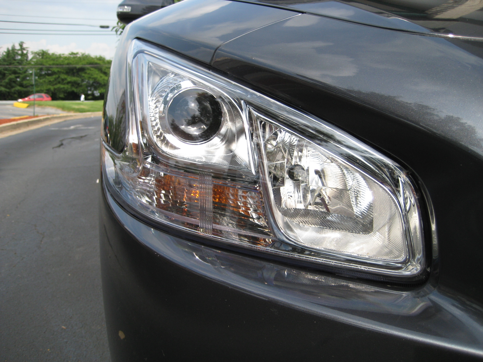

Mmm, I'm honestly a little confused Roy ... here's the Maxima headlight:
It has a high beam halogen reflector, every Range Rover I've seen has them too except that from what I can tell the newer ones have a halogen projector for highs. Am I mistaken in this? Are the inner reflectors just DRLs? :think:
Anyhoot, I will mention it to my retro guy and see what he thinks. In any case I can't/don't really want to use that for fogs in those housings as they sit too high. So the only two options are to either go with my plan, or leave it as is and wire them as you suggest.
Thanks bud. :)

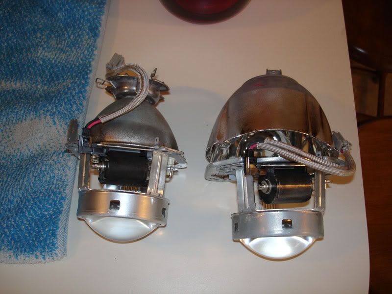

sorry. not sure about the 7th gen maxima, I was referring to 6th gen maxima that uses a hella e55 bixenon projector, and i meant to write land rover, the LR3 is another excellent Bixenon. the inside lights on these are auxilary lights not highbeam
the 6th gen maxima had HID BiXenon as an option (left), but the halogen utilized the same housings, so they were one of the few headlights with a bi-halogen projector (right)

Mmm interesting ... so obviously it's possible to flash xenon highs effectively from lights off.
Do you happen to know what oem ballasts either of the two above vehicles use?
Thanks bud.
