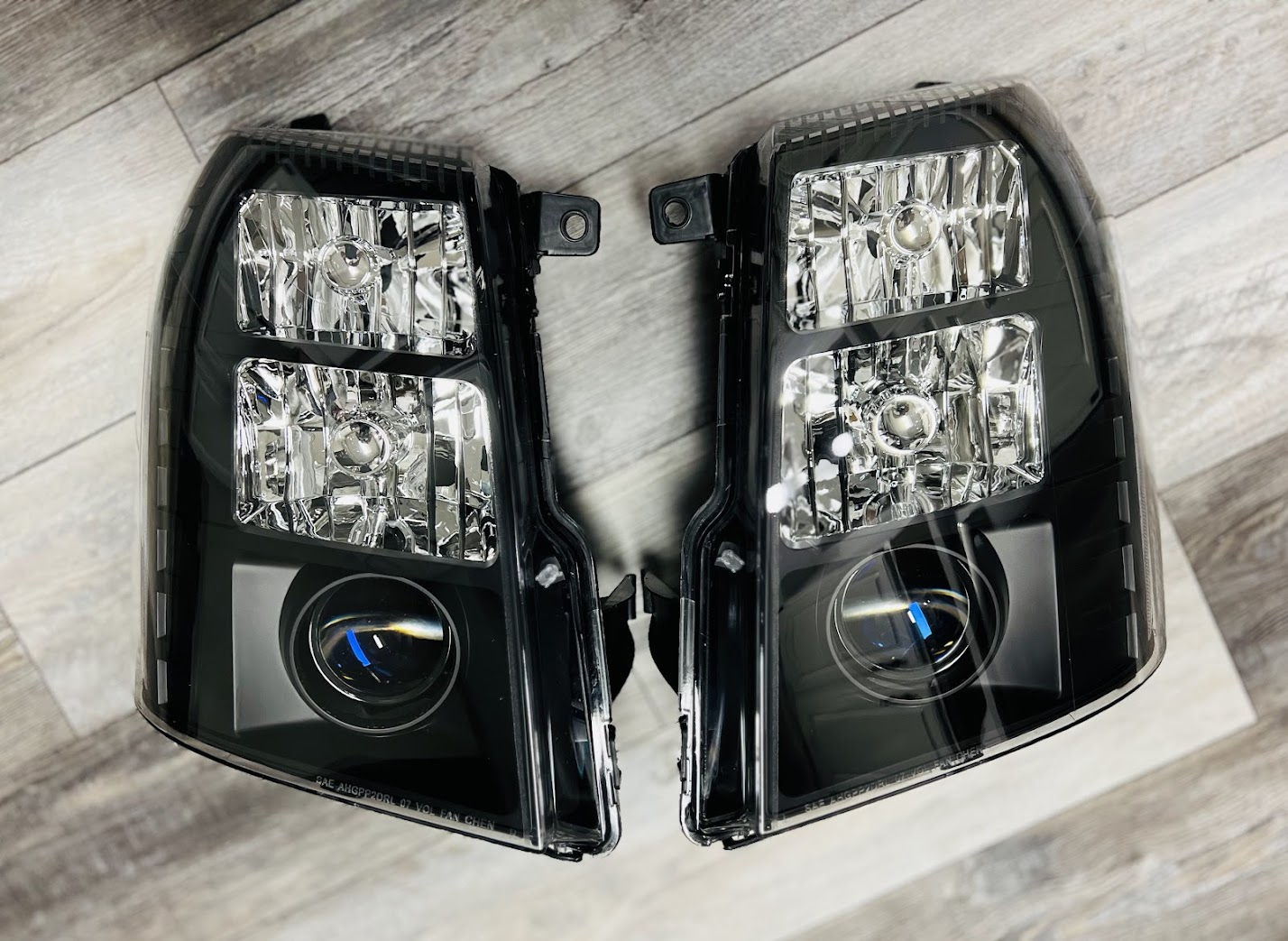

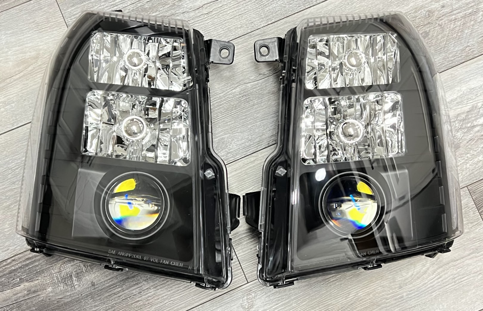

Headlight retrofit for 07-14 Escalade.

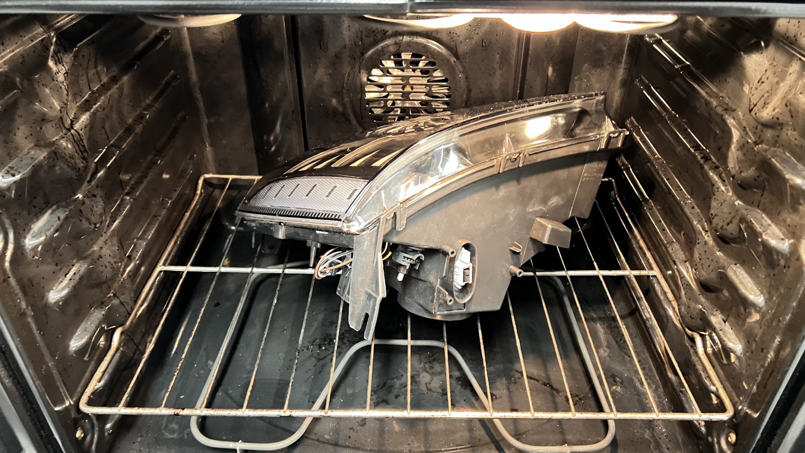

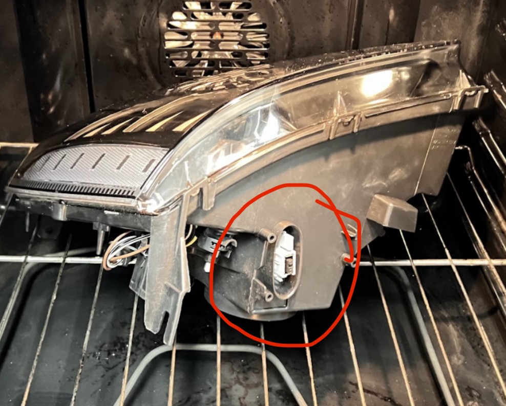

The headlight donors are new Amazon units sealed with Butyl rubber. OEM lights are sealed with Perma seal and those are not going to come apart easily.
Heat the oven to 225F, remove all covers and screws and let it bake for around 8-10min, you may have to add additional minutes but for me, after 8min I pulled the headlight out and placed it on a table and pulled the lens from the main housing starting at the top center and the lens peeled away very easily.

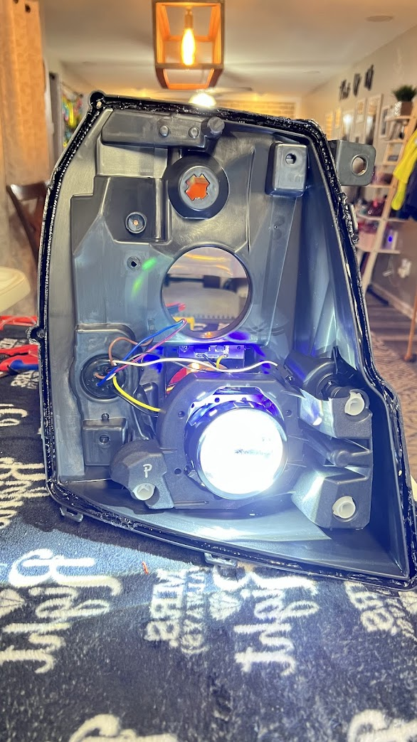

Next steps the old projector was removed, the new projector was installed and minor trim was required on the bracket to ensure that it seats flush with the adjuster bracket that you can see in the pictures.
Reseal with more butyl following same operation holding the lamp 6-7min to soften the butyl and press the lens back on the housing.
Here are some pictures of the process.

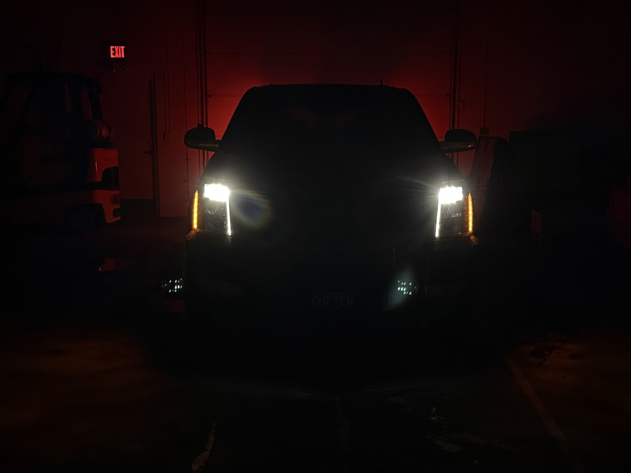

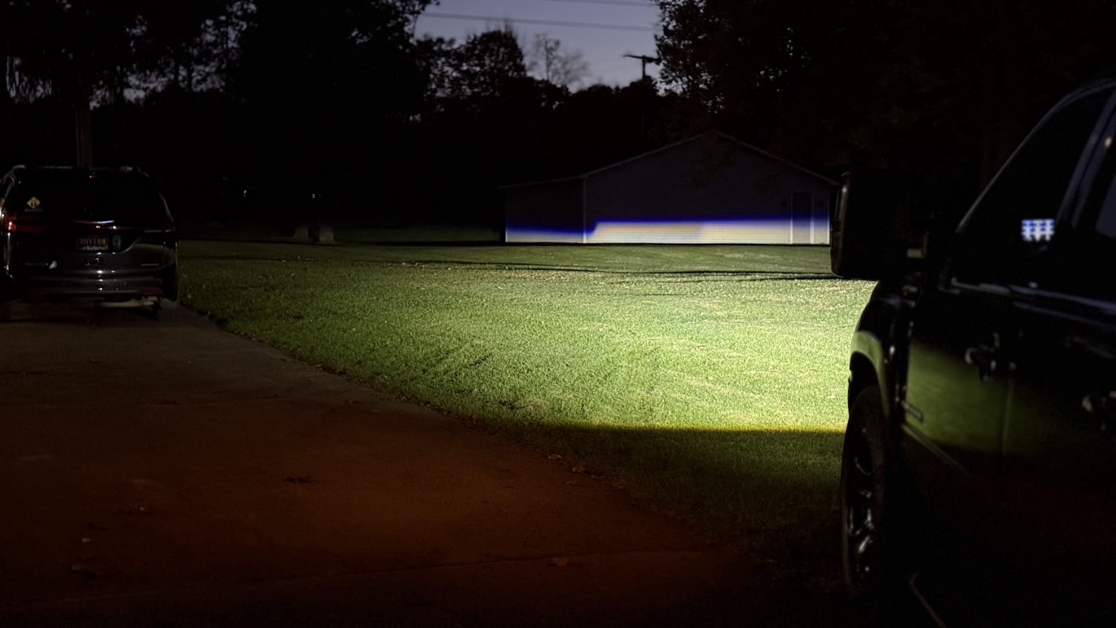

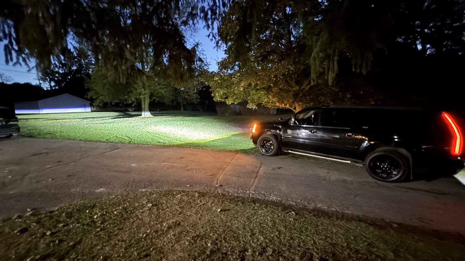

And the output shots. Razor sharp beam with excellent output. No more burning bulbs or HID ballasts.

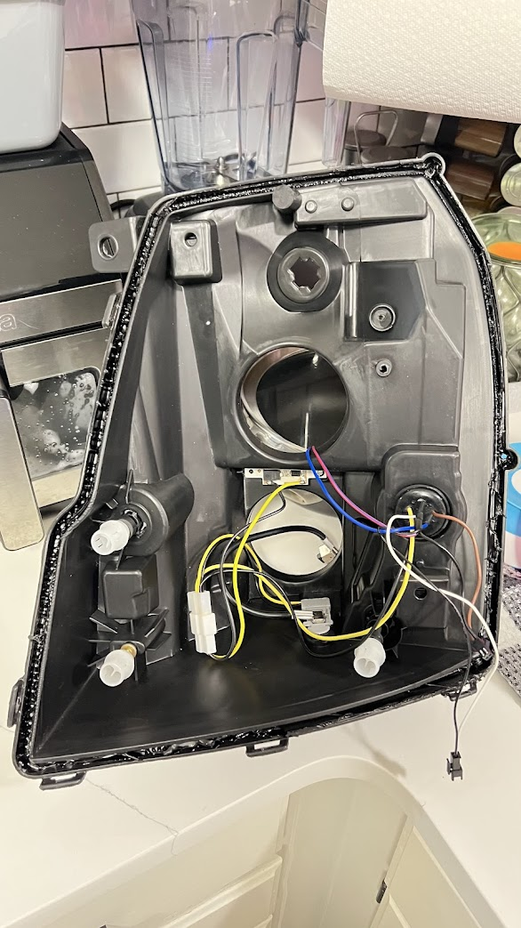

What exactly did you do to re-wire power to bypass the OEM HID ballast? I’m guessing you had to identify the power and ground going into the OEM HID ballast connector then spliced that into the power and ground out of the Bi-LED projector?
Did you do anything to plug this hole where the OEM HID ballast is mounted and connects to the bottom side of the headlight housing?

The yellow and black connector is what goes to the ballast originally, black is ground the yellow is power. I cut those off and spliced them into the projector which has a Black and Red wires. Black on Black and Yellow goes to Red and thats all the wiring needed to make them work. The skinny connector seen in the image with White and Black wire is the High beam. Basically connect that to the projectors wires does not mare what wire gets connected to the ones on the projector both will trigger high beam.
I used quick connect for household wiring to make the connections, but you can use whatever you like.
Here is the latest shot of the output.

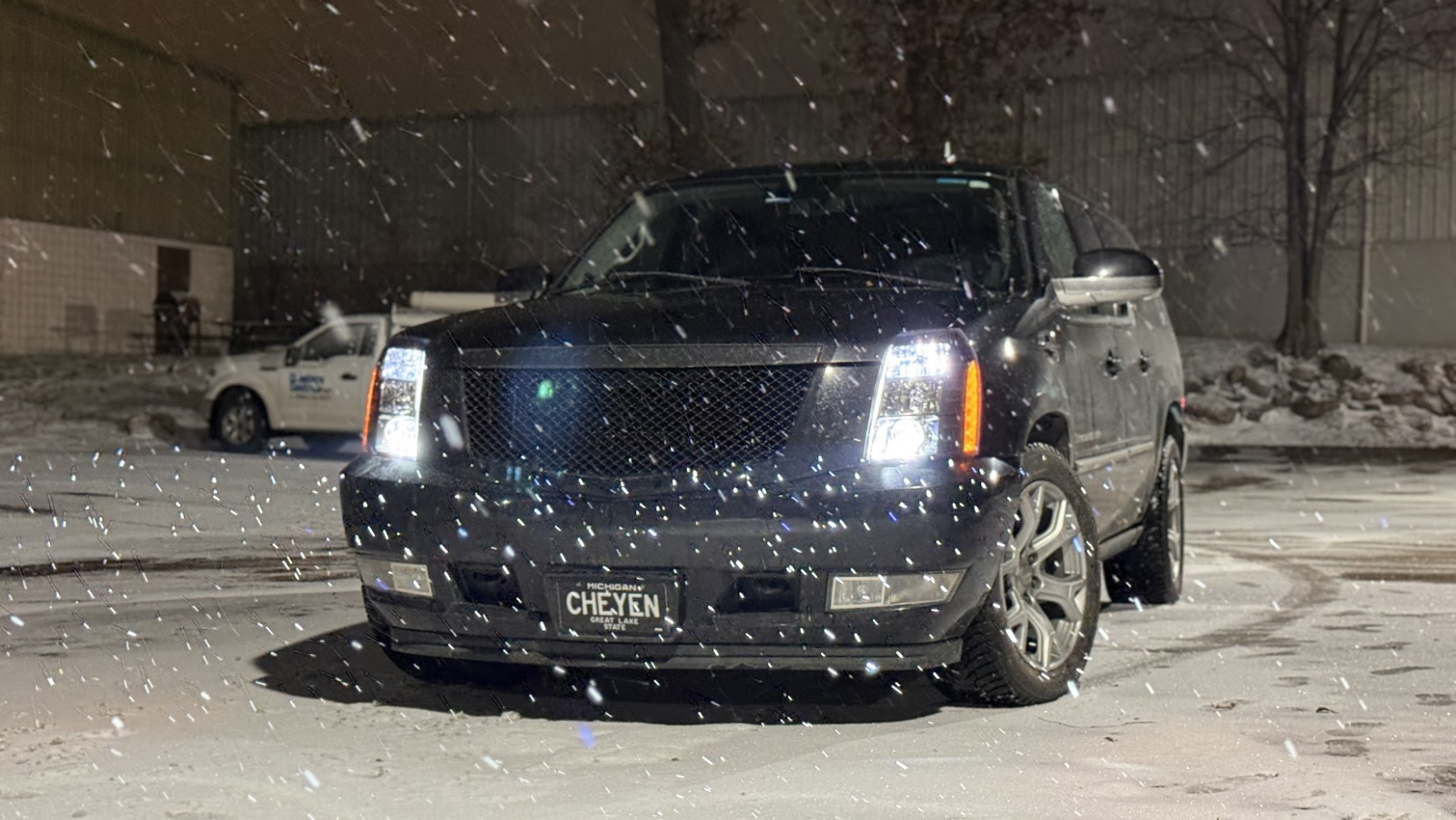

Do they create enough heat to melt snow/ice like incandescent bulbs do? I actually had my Yukon housing ice-over in a blizzard last year, and couldn't understand why it was getting harder to see until I pulled off the road to check if the bulbs died. LEDs don't make much heat inside the housings.

I know exactly your concern, and I will say that I was shocked to see how much heat comes out from the projector lens right where it exits the clear lens on top, you can warm your hands on it, its not something that is common but these ones seem to do just fine. Will test them out with the upcoming snow this weekend.

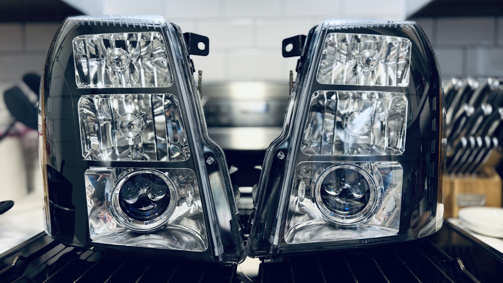

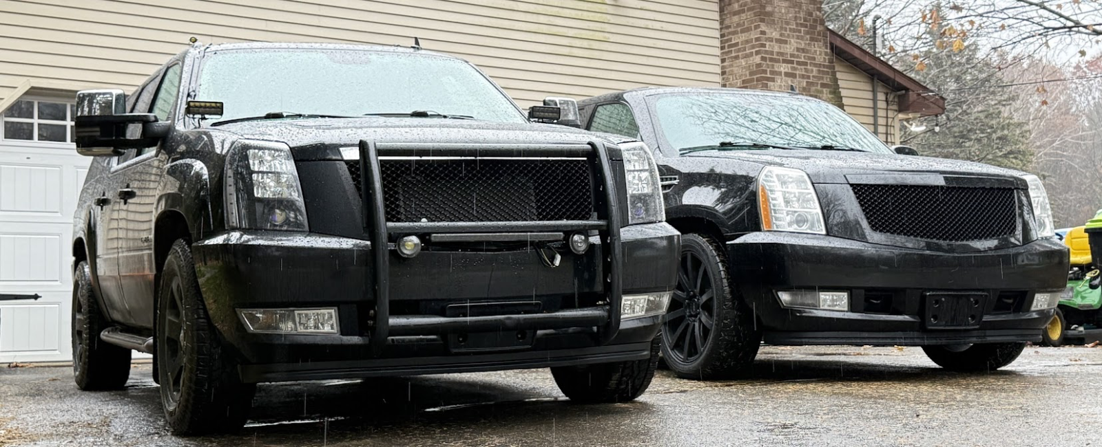

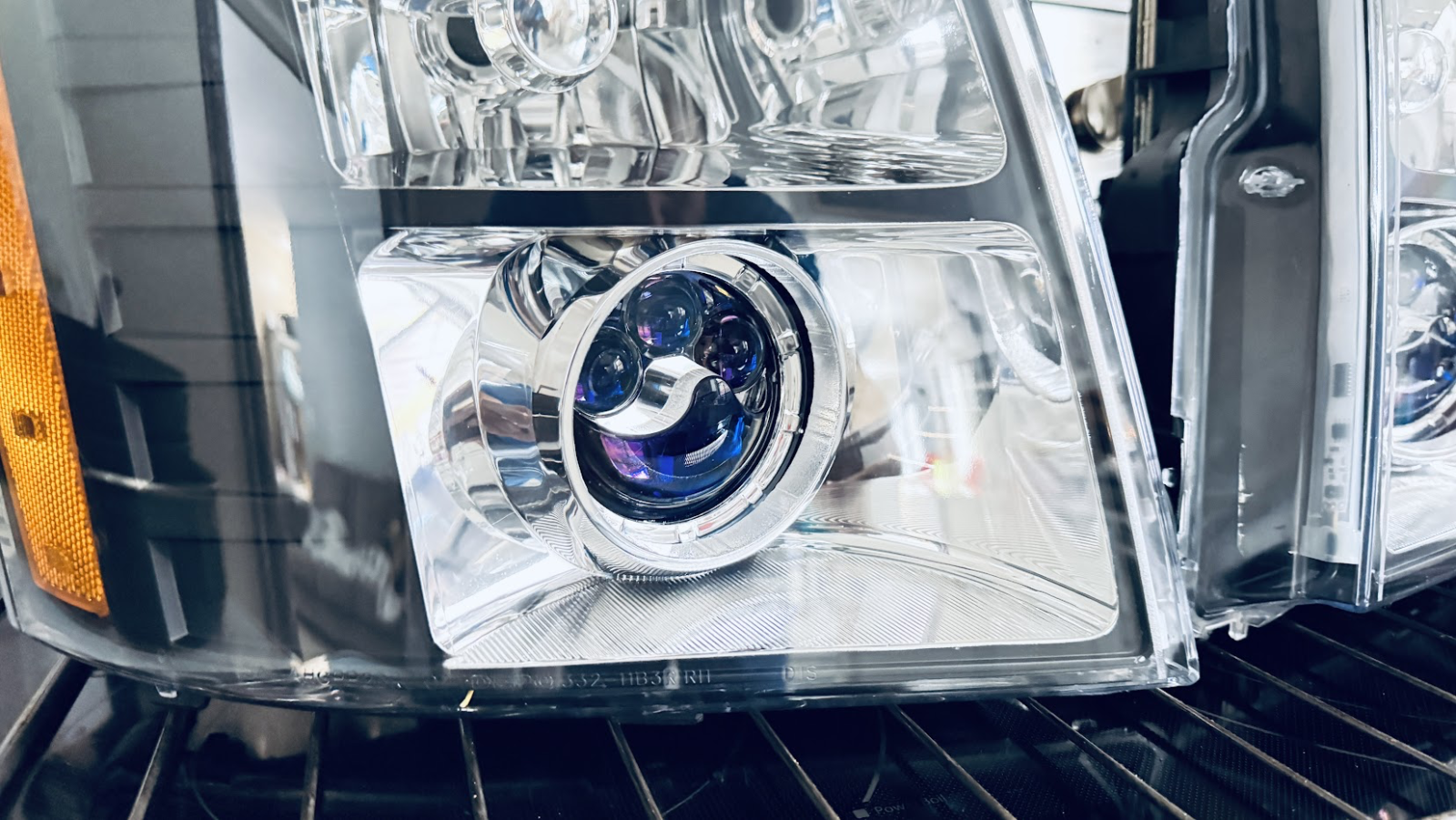

For my Escalade 2.0 I decided to use the DEPO lights with the 3 chrome slots and a BiLED projector with triple High beam LED assist. Turned out quite well actually. I am happy with the lighting performance and ease of retrofit. As far as opening the DEPO lights, never again, I will stick to the versions with butyl seal. Permaseal took me about 4hrs per light to open and I don't wish that upon anyone to ever encounter.
Enough talk here are some pictures.
Installed some marker lights inside the headlight lenses that actually turned out pretty ok. Not bright enough to be seen in the day but look good at night.
Now both rigs are equipped with amazing forward lighting systems and I can't stop going out for night drives.
