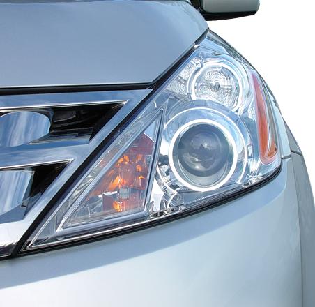

But it is not an uncommon design and there are others like the murano, that use a single bixenon projector for all functions.
Is it a good design or a bad design i cant say, but its out there. And how often do you actualy flash your high beams during the day, If you did it every day for minutes on end, probably bad for bulbs and ballast. If you do it a few times a month i don't think it is anything to worry about. I think the flashing HID will imediatly destroy your bulbs and ballast is the "pop rocks" and soda myth of hidplanet.

So this is the setup:
2 upper slots: Bi-Xenon Quads with switch to Dual.
Lower Inner slot: Upside down Blazer halogen projector for daytime flash to pass.
Lower Outer slot: Gutted Blazer projector with LED DRL/TS switchback.
Wo0t!!! :mexsmoke:
